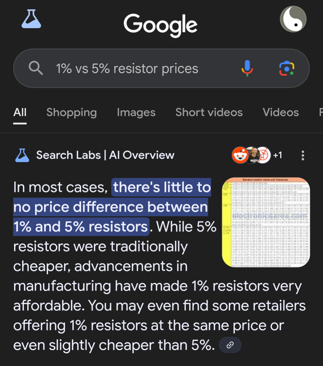

Wouldn’t that be easy to fix (or at least greatly mitigate) by using better resistors, eg ones with 1% tolerances? Case in point, it looks like they are about the same price (or even cheaper) than 5% ones:

I don’t know the actual tolerances, or the details of the components used. I didn’t make the hardware, and the numbers I gave were only examples to demonstrate the concept. It may already be using 1% or better. The point is that any variance at all will make it hard to match the transition between “gears” consistently on every item produced.
