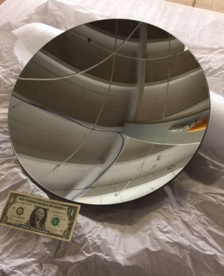

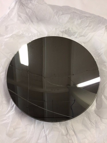

I’d like to mention, if anyone is building a similar flashlight maybe consider using this reflector I found on ebay:
It’s made of glass and will not flex like the electroformed reflectors do, as well as a 4” focal length instead of 3”, which will make focusing easier.
No info on the surface precision or reflectivity %, but for $170 it’s a great price for this type of optic.
Only difficult part will be making a mount for it which centers properly while protecting it from damage.

Cool. You could make a case for the mirror and embed it in a stiff foam, i.e PUR foam. Then either hang the complete case in an adjustment system, or fix the case and do all adjustments at the led.

Yeah, moving the LED instead of the reflector would probably be best in that case.
I’m really tempted to buy one for $170, even though I don’t have any light to use it for…
Great find! Looks/is pretty much identical to the glass reflectors in marine searchlights, but orginal reflectors cost atleast twice as much.

Someone on TLF is making a huge project with 3 of the 24” ones, but haven’t seen any updates in a while.
I have no idea how accurate their surface is, or what the reflectivity of the polished aluminum is.
It seems like just a stamped piece of metal, which would be far less precise than electroformed optics.
The material is not good,
Thats why we call it “Salatschüssel”_—-salad bowl.
No Update cause of doesnt work well with Led recoil.
It is what you say- stamped piece of metal,
We will try 280 mm glas reflector from cinema with CFT 90 @ 30A. :innocent:

Yeah, too bad these weren’t available when I was designing the Syniosbeam :frowning: They do look very good quality.

Unfortunate that the edmund optics reflectors didn’t work out.
If you want to go big (since you’re not making a portable flashlight) the same seller on ebay has 476mm parabolic reflectors too, you don’t need to limit yourself to 280mm :wink:
You should get close to 30Mcd with this setup!

The reason to 280mm is
cause I have the glas reflector right now ,also the big heatsink and the 30A driver and the lippo…
Oh did you but that one from ebay already, or you got one from somewhere else?
