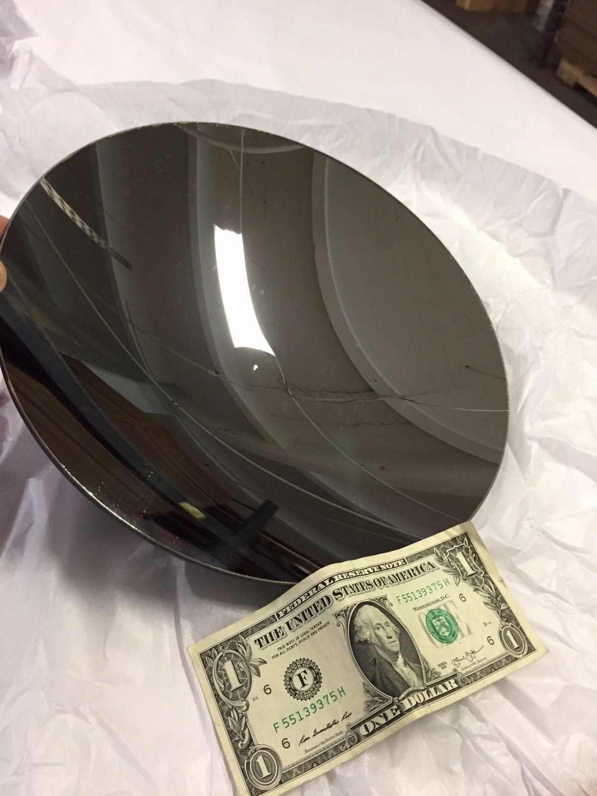

I have one question about it. I contacted them asking how deep it is and they replied very quickly saying its 1 7/8 inch deep. If it has a 4 inch focus length, does that mean that the led would have to be mounted almost 2 inches in front of the rim rather then below it like your one is? and there by letting some light escape?
Yes there will be some light escaping, very little though.
You can use this calculator to estimate the performance and lumen collection and all that stuff.
The reflector I have with 3” focal length has the outer edge about .5” from the LED plane, so it collects a more extreme angle of light (which is what makes it very difficult to focus)
This 4” FL reflector will collect 85% of light instead of 96% like mine, which is a very small difference, and I think it’s worth it for the improvement in focusing ease.
