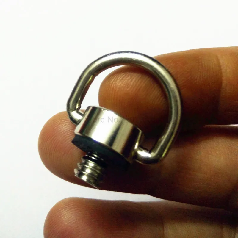

Can it be attached to a keychain?
You probably mean: can a keychain be attached to the light?
Yes!
Easy, just screw this into one of the tripod mounts on it :smiley:
Can be attached to an anchor chain, no problem
Sure it can!

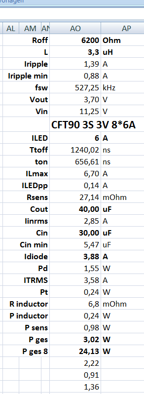

Can I run 8 x 21700 5000 mah too it ?
What will you use for input voltage so I can plan the battery configuration ?
In series?
Or do you mean 4s2p?
Currently I’m running 3S to it, but I’m sure Lexel can adjsut the design to work with 4s easily.
Problem is that the driver is very expensive so you might want to look at his other CFT90 driver options, I think he recently designed a new one that can do 40A and costs much less.
Of course those other drivers don’t have the dip switches for tweaking the output though.
Thanks I will check with him about the other CTF-90 drivers. I’m researching ahead of the current mod because the CTF-90 configuration will be implemented if the XHP 70.2 cooling is successful. I can set it up for 6v, 12v, or 24v. 2s4p, 4s2p, or 8s1p. But I don’t think the 24v is safe to use. :+1:
