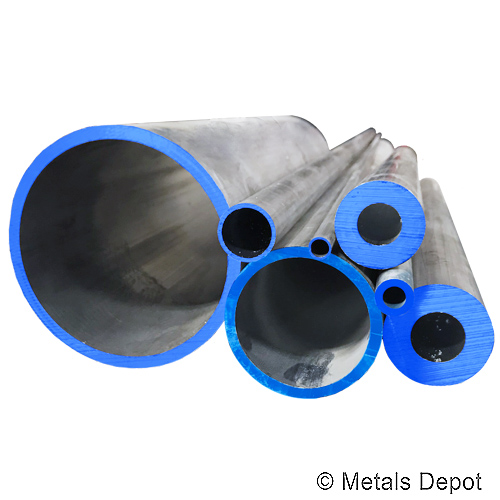

The body of the searchlight will be made out of a 6061 aluminum extruded tube. A 12” outer diameter witha .25” wall will be very rigid to protect the reflector, and will allow 1/4” of space around the reflector for protection. This space will also be used for tubing and wires to pass from behind to the front of the reflector where the LED is. The tube will be custom cut to 4” long and will cost $192 CAD.
