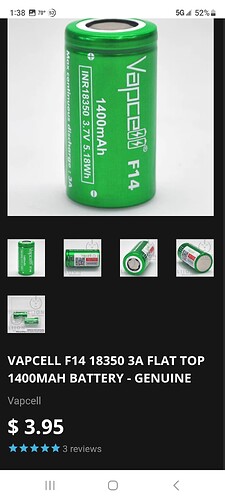

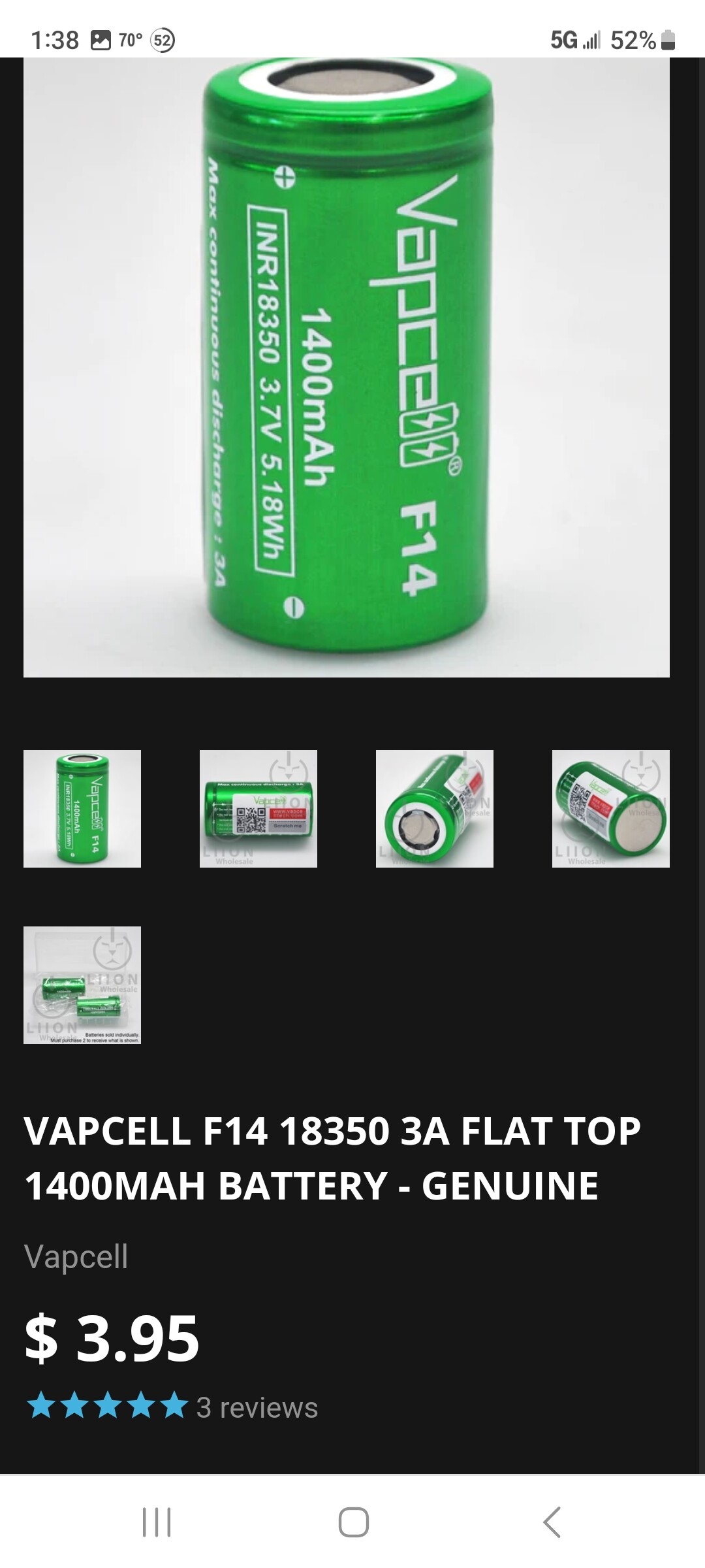

Does a Vapcell F14 18350 1400mAh 3A provide enough amps for a Thrunite Catapult Mini V2 ?
It has SFT40 LED
I am using Vapcell M11 18350 9A.
If F14 provides enough amps I May benefit from slightly more capacity.
SFT40 draws up to 11A, you’ll have better performance using the 9A M11 cell.
Thx
