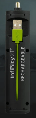

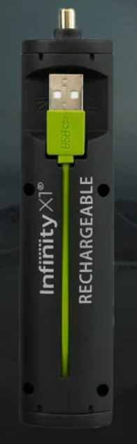

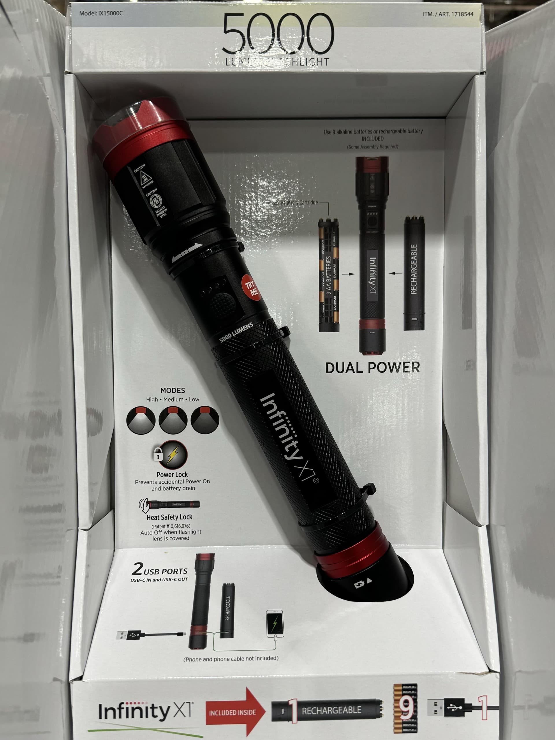

Anyone thinking that the maker of this flashlight did NOT put in a failsafe to prevent the charging system from working when alkaline cells are inserted?
No I think not, it’s not rechargeable in the light from what I can see. The rechargeable battery pack is charged via the inbuilt usb cable when removed from the light, though you can charge from the light to something else (powerbank funtion)
Thanks for checking on that. Well, they did something smart here. No way someone can do something seriously stupid with the charging.
I know right, never seen an approach like that before - wiring a physical usb cable in the pack… neat idea if there is room, shame they didn’t use usb c though.
Yeah, first I’ve ever seen of this too. Weird having a built-in cable with USB-A plug that docks flush to the body so the whole power unit can be tucked inside a flashlight. I can see the merit… as USB-A is so widespread, and you won’t ever have to worry about not having a cable.
For me that’d be an immediate no-go, I do not own any USB-A charger outside of the “crappy old power bricks I may need some day” box anymore. Both my home and travel chargers have unb-c only :sweat_smile:

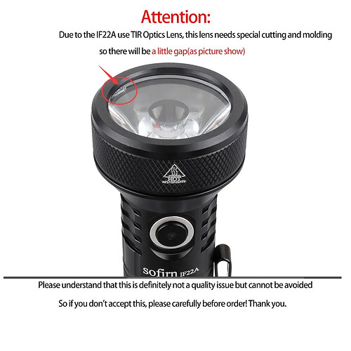

Is this really necessary? Or just cost cutting is too attractive? I’ve also seen this on my earlier release Wurkkos TS11.
TIR optics are made with injection molding, that’s where the plastic is injected into the mold and they cut it afterwards, leaving a mark.
I wonder why they don’t put the injection point into the “legs” which the TIR uses to sit on the PCB… Or keep a 2mm “waste” point, which is then shaved off with a knife, instead of just snapped off like here.
By spending 10ct more per TIR I’m pretty sure it could be avoided. But on the other hand it does not Impact performance, so… Eh.

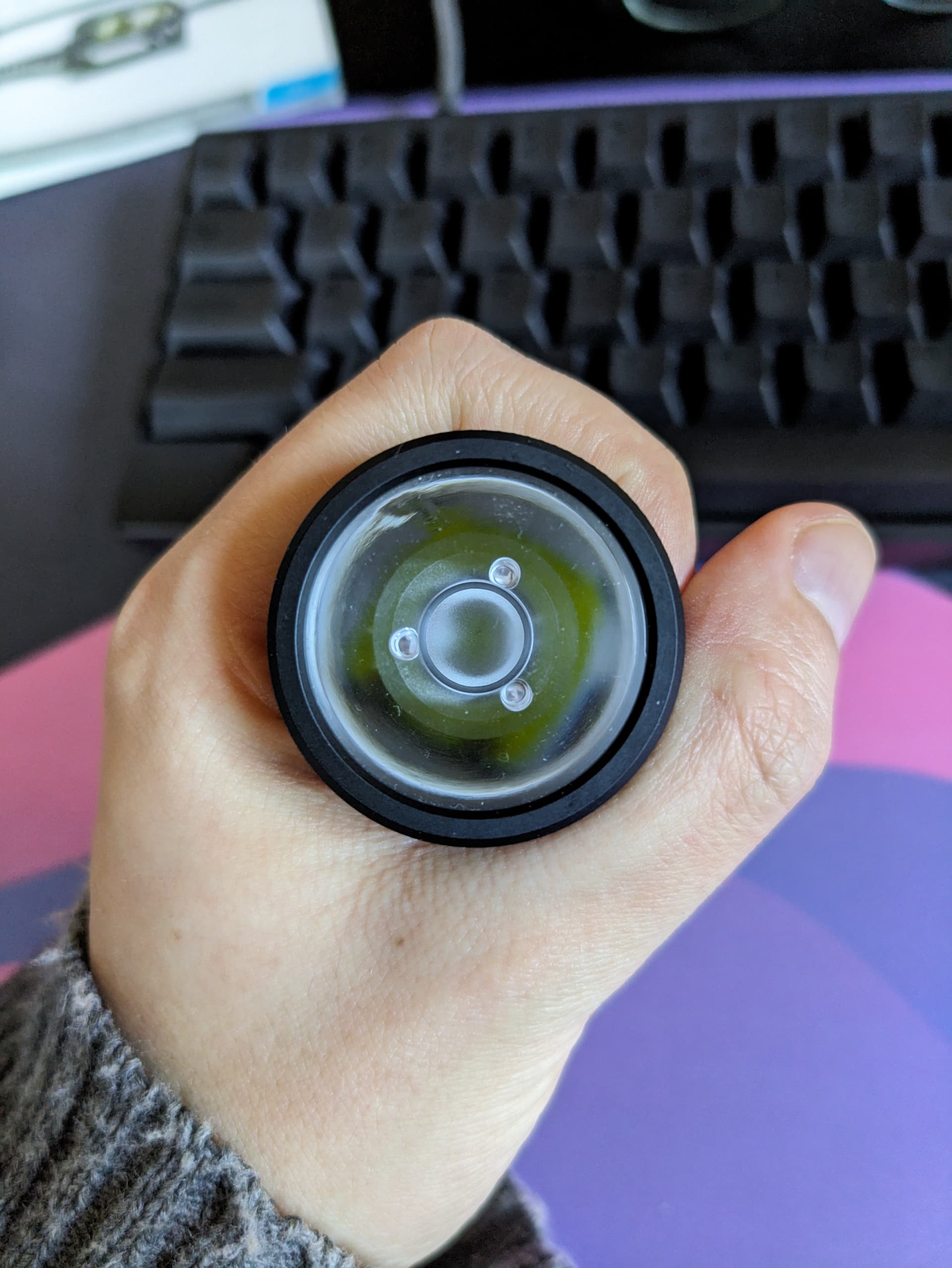

Does the IF22A lens have legs ? TIR lenses useed in flashlight usually don’t.
Yes, that’s right. But, in manufacturing, they could have a step that separates more cleanly and polishes off any jagged flange. Of course, this is cosmetic–does not affect the beam.
Iirc the one in the IF19 does, so I expected this one to have, too.
You guys are way too pedantic. Even the Acebeam L19 with it uber big TIR comes with a cutting like that. It contributes nothing to beam profile.
Too lazy to pull it apart, but you can even see it in this pic. IF19 has 3 legs from TIR to led PCB.
