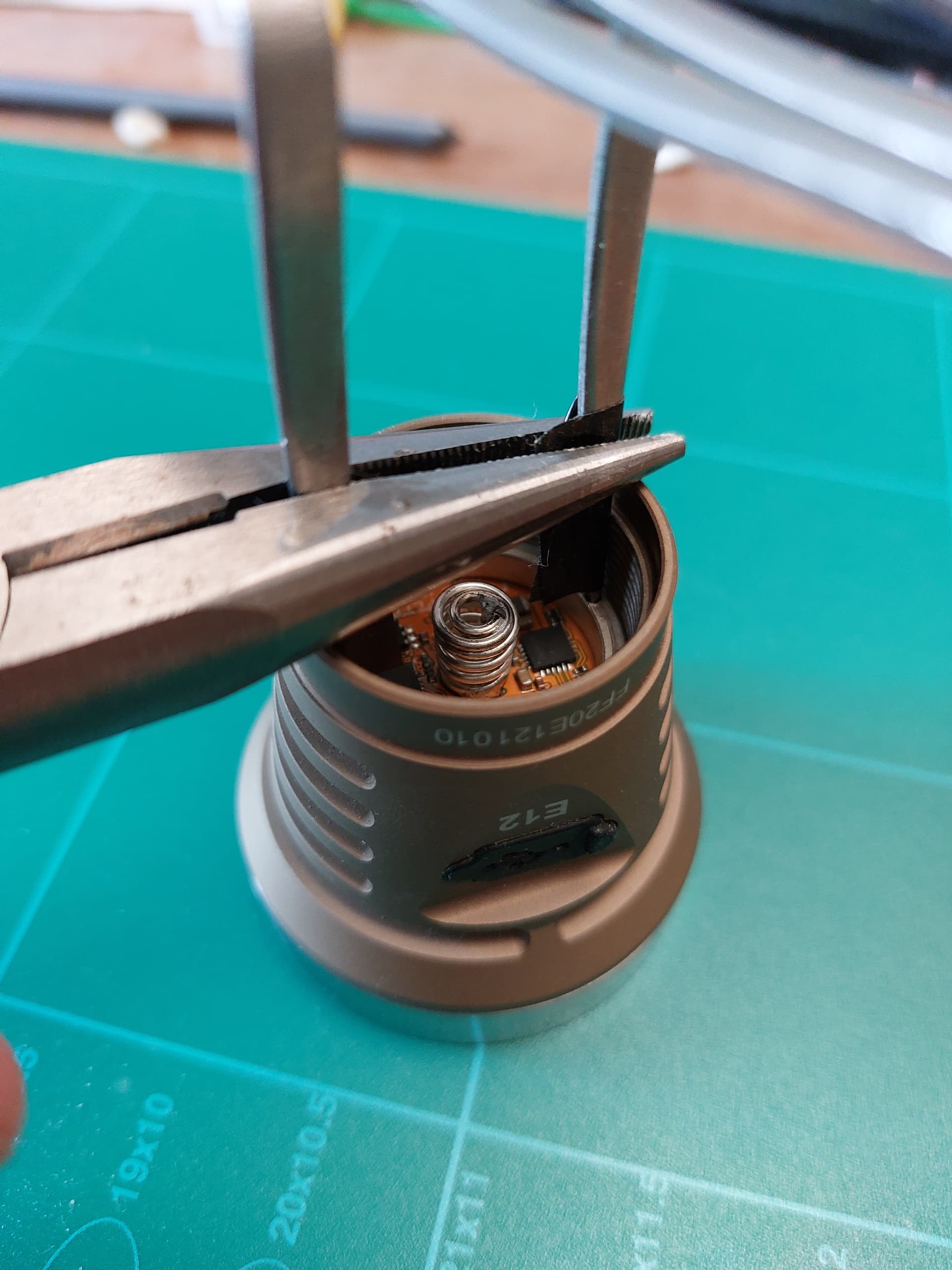

How do you people open this stuff? This is an S2+. As far as I can see I have to turn the retaining ring clockwise to unscrew. the only tool I have that can enter those tiny holes is a pair of tweezers, which aren’t happy about this job but unscrewed every pill I tried them on so far. In this case however, no frigging chance. It’s so tight I can barely manage to hold the outer part while trying to unscrew…
Thin nose or circlip pliers. I have these https://www.knipex.com/products/gripping-pliers/gripping-pliers/gripping-pliers/3741125 , 1mm tip.
If you don’t have suitable pliers you can try with a fork.
I have pliers like that, but the tips are too big - the driver has tiny drills.
I just found a solution as ugly as it is simple: I took the cordless drill and a 2mm drill bit, and made the holes large enough for my pliers ro fit. Unscrewed perfectly after ![]()
Necessity is the mother… of invention, of course.
If it looks stupid but it works it’s not stupid. Or maybe a little ![]()
The ring still has a lot of material underneath my drills, kept them shallow on purpose not to weaken it too much!

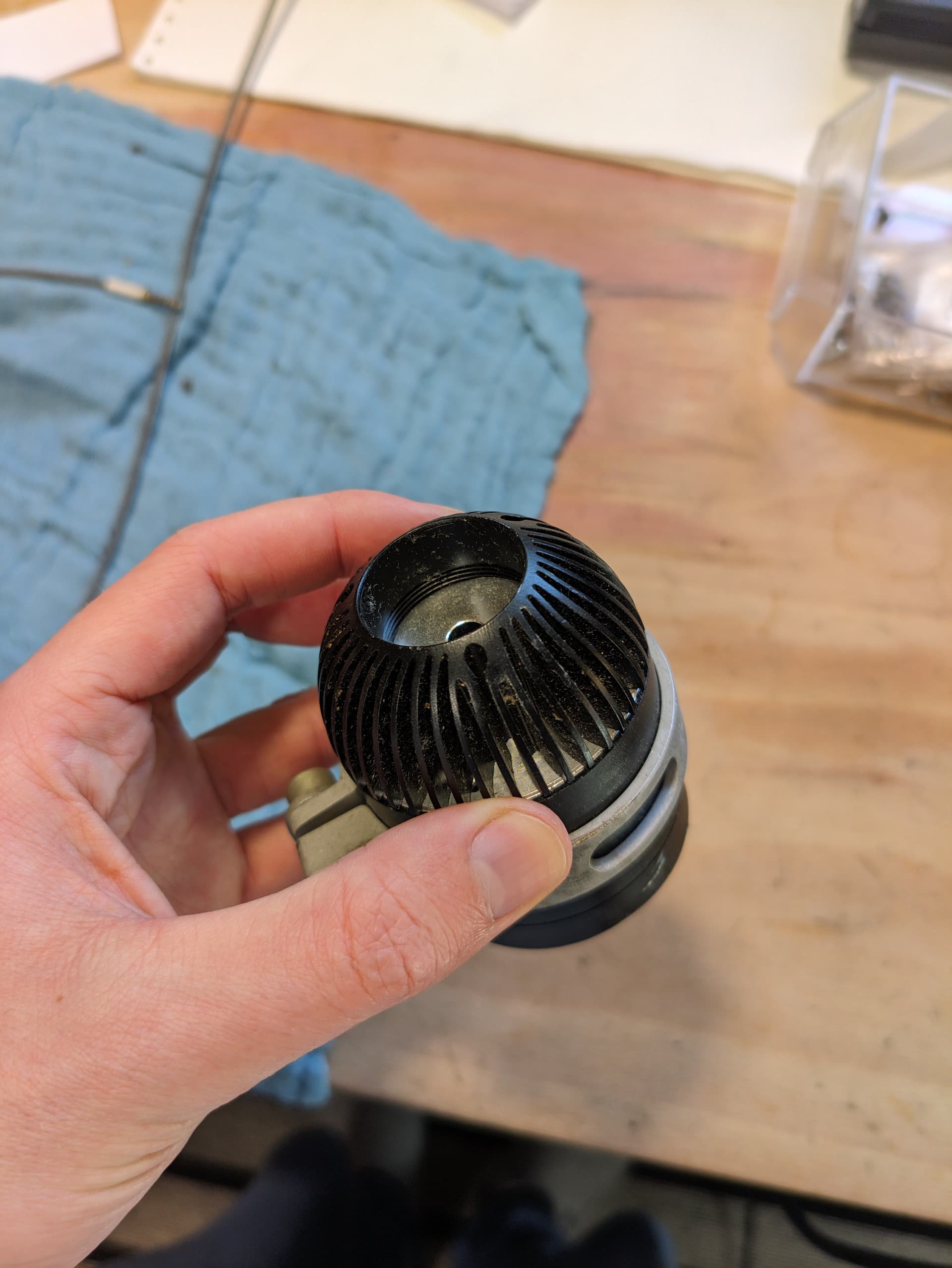

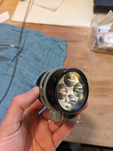

I just found this in my scrap box. Reflector seems to be ~50mm diameter (forgot to measure while it was open) and is super bad quality (chrome-plated plastic). The internals feel a bit flimsy (shelf rests on a ~1mm wide edge, how is heat transfer supposed to work there??).
Do you think this might be worth trying to turn into something useful (big buck driver, 3S LiPo battery since I already own those in backpack, 4 5050 or 3535 LEDs and a big quad optic), or would you just trash it? Original LEDs/drivers were shot.
Get a nice LED in a temp you want, a diffuser (scuff up some clear plastic, even), and make it an outdoor accent-light or area-light.
Doesn’t have to be pushed too hard, just a coupla hunnit lemons.
I got a solar-light that wouldn’t charge whether from the solar panel or via usb. Still got the nifty 3-wire LED panel with WW and CW chips. It’s got a diffuser already, so was going to do exactly that, use a shallow “cup” to act as housing and heatsink, have a simple stoopit resistor to limit current, and power it off a usb adapter.

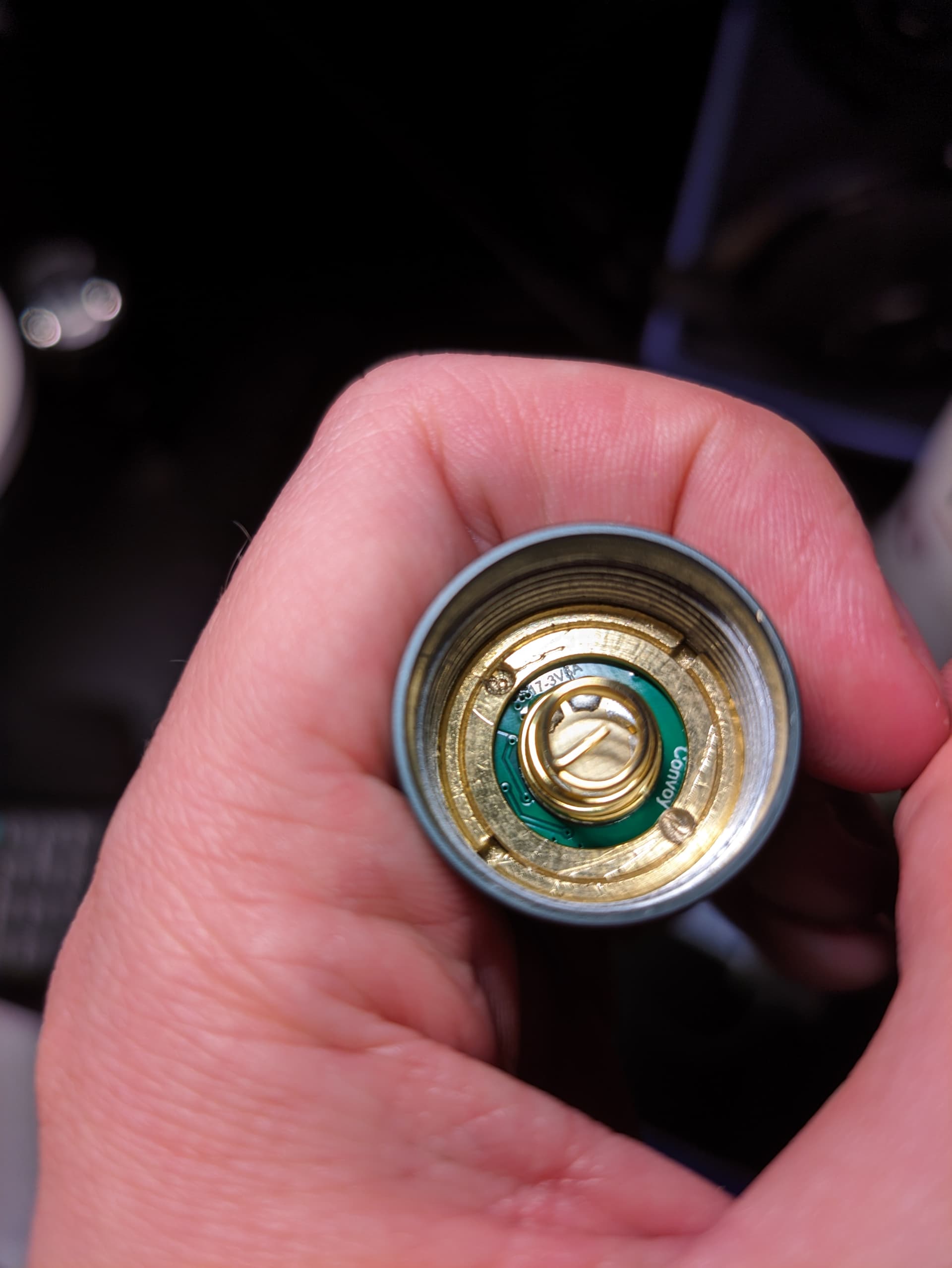

Can a failing/ defective switch cause the light to be stuck in one mode and you can’t turn it off?
Ramping and clicking the switch does nothing. Have to unscrew tail cap. Then when I tighten the tail cap it comes on in that same mode. Only way to get that mode changed is to unscrew the body from the head, then the light will go off.
Double click goes to Turbo sometimes and very low output other times. Double click will only work sometimes for the right mode or the wrong mode. Sometimes it does nothing. Much more. That’s the short version. It’s a K1 flashlight with Anduril 2
I am sure a bad or faulty switch can cause issues.
This glitch has nothing to do with the switch…
The only way to get to Turbo, (when it works), is to double click once you reach the high ramp. All other outputs below that,a double click returns to moonlight.
Most people like Anduril or Narsil… I prefer a simple UI with three modes that’s it.
All the stuff started 3 days ago… No Doubt a firmware problem.
