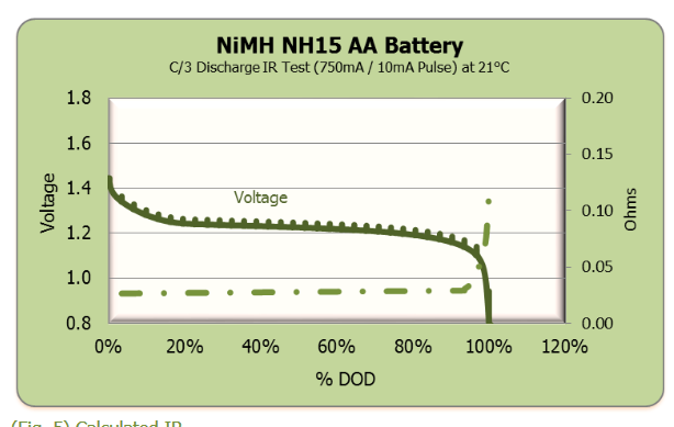

I’ve just bought a Lumintop Tool AA and am running it on NiMHs for the lower output and longer run-times. I know where I am with Li-Ion, but how do I know when a NiMH wants to be recharged? Is it at a particular voltage? If it matters they’re Eneloop Pro that I’m using.
The last time I used AAs in a light they were alkaline.
NiMHs have a fairly flat discharge curve. Drops off fast at the end. 1.1v and it’s about done. With higher discharge rates the voltage can run lower than this. But there is no way to monitor this inside a light.
Run a test to see how long it takes for the light to dim. Then use that as a time estimate.

Thank you, that graph makes it clear how hard it would be to test the voltage and get anything meaningful. I have a set of four and the light only takes one, I think just swap regularly is the way to go and / or carry a spare.
