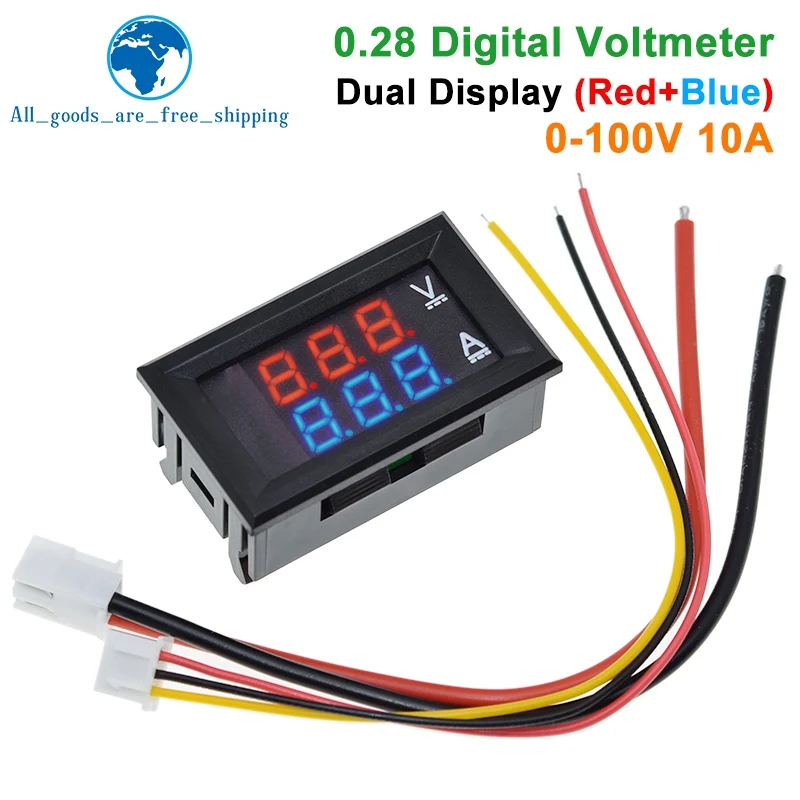

TZT DC 0-100V 10A Digital Voltmeter Ammeter Dual Display Voltage Detector Current Meter Panel Amp Volt Gauge 0.28" Red Blue LED
Is the above voltmeter suitable for testing 3.7v cylindrical lithium ion batteries?
I would give those things a real world accuracy of ~±10% or so, the 0.10% are definitely not true. 75 mOhm IR are pretty steep, if you plan on using it to measure current of a higher powered flashlight, no big deal otherwise.
So, depends what you wanna use it for, I guess. To build it into something as a rough ā€œbattery is half full, okā€ indicator, sure. Using it for accurate measurements, nope.

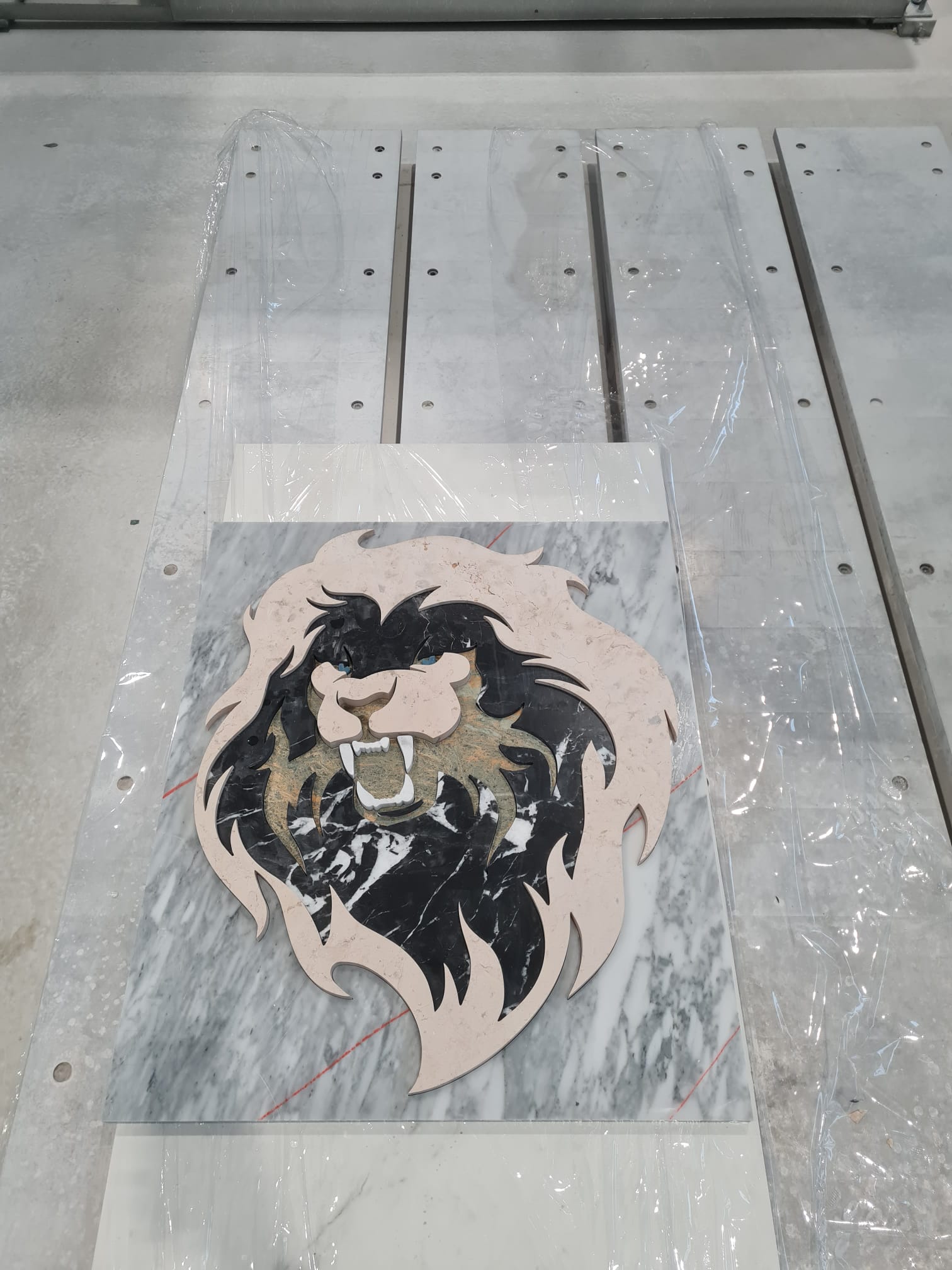

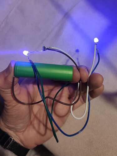

At my work a colleague is making a kind of mosaic of a lion made of marble. I wanted to put a couple of very simple LEDs inside his eyes, and among my son’s toys I found some pens with uv LEDs for writing secret messages. I’ll post a photo. How much do you think they consume? How many days 24/24 will go before a battery change? I would like to attach an 18650 to it.
I don’t have a multimeter at the moment. Thanks!
Might start out too bright (enough to pop the LEDs) on a full charge and then dwindle down to barely-lit as the battery drains.
You can use a LFP cell (3.2V start to finish) to avoid having to regulate anything.
You married to UV lights? They’re spitting out light that people mostly can’t see, and you’re only looking at the visible spillover. Better to use something like blue or white. More robust, and more efficient. OR, put a fluorescing piece of plastic over them to protect the LEDs and at least get more visible light out of them.
Thanks for the advice on LFP cells, I don’t know what they are but I will look into it.
At the moment I only have those around the house, but I can easily get something else. In the meantime I will follow your advice and cover them with fluorescent plastic.
Thanks!
Shine 'em around the house, see what glows. Plenty of source material to cut up to fit…

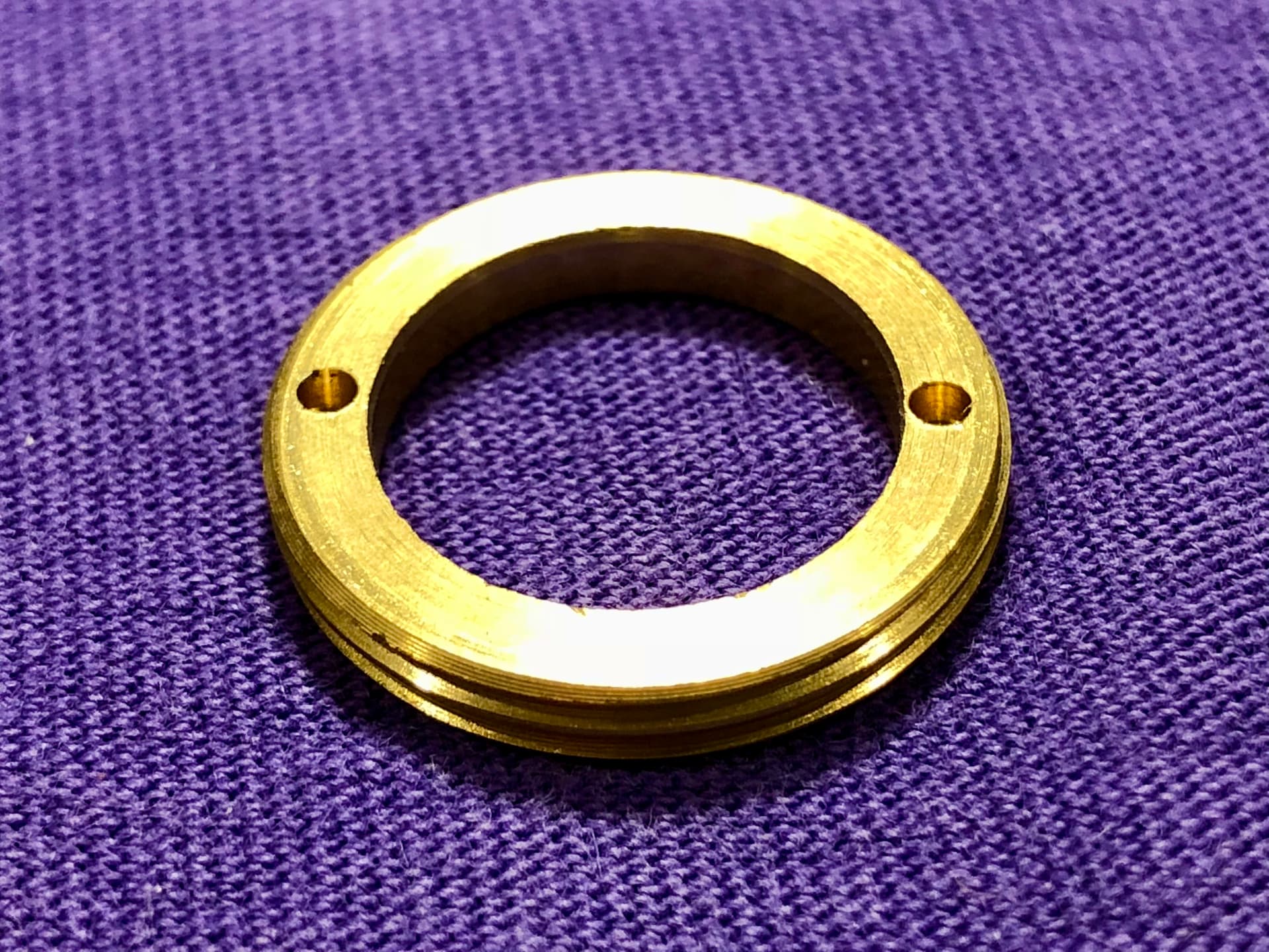

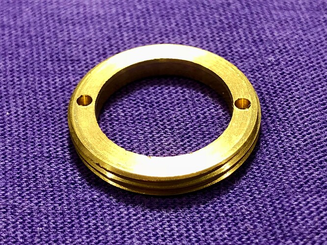

Anyone know where I can buy a switch retaining ring for a Convoy S2/S2+/S3/etc.?
I’ve checked Kaidomain and searched on AliExpress, but no luck. And general Google searches come up empty.
