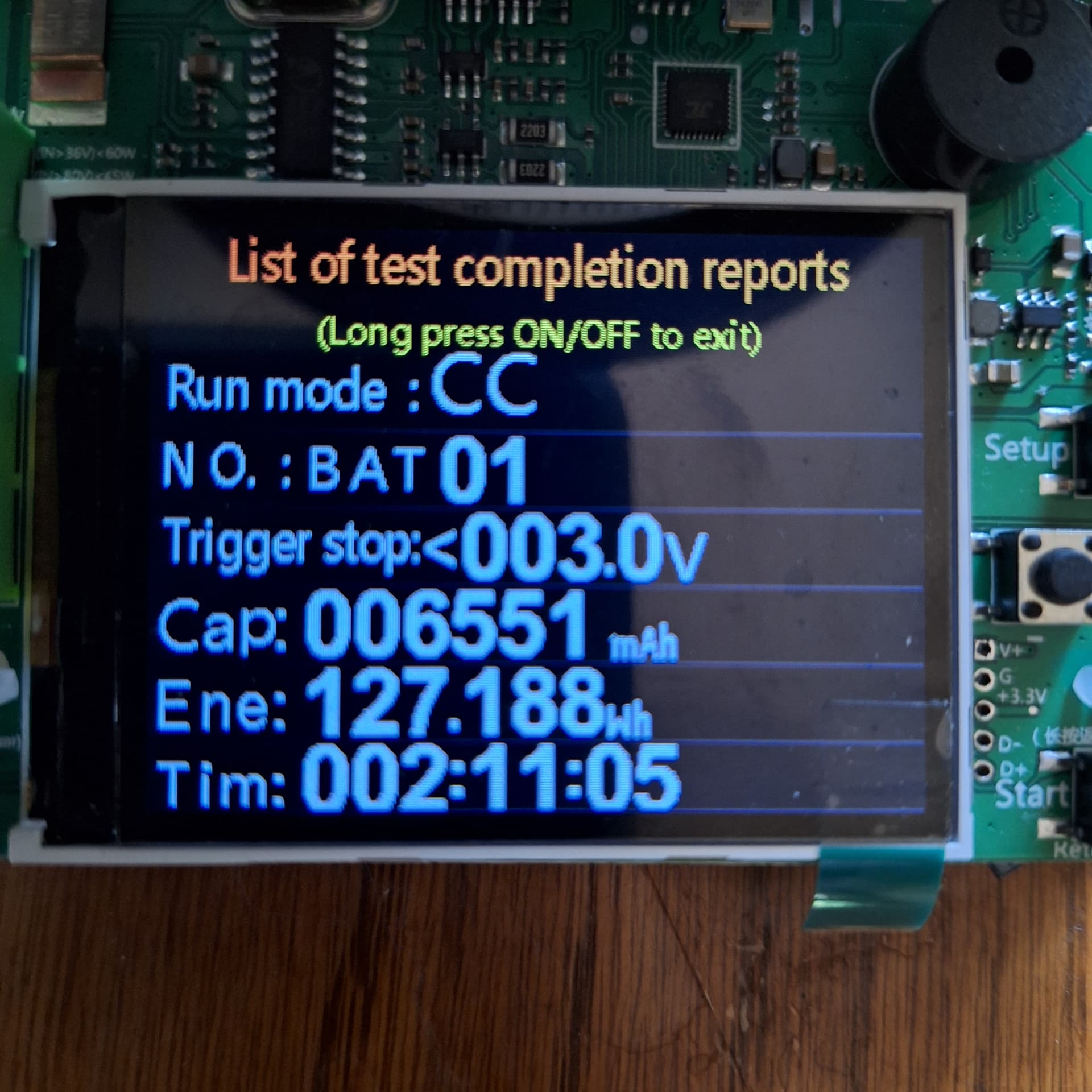

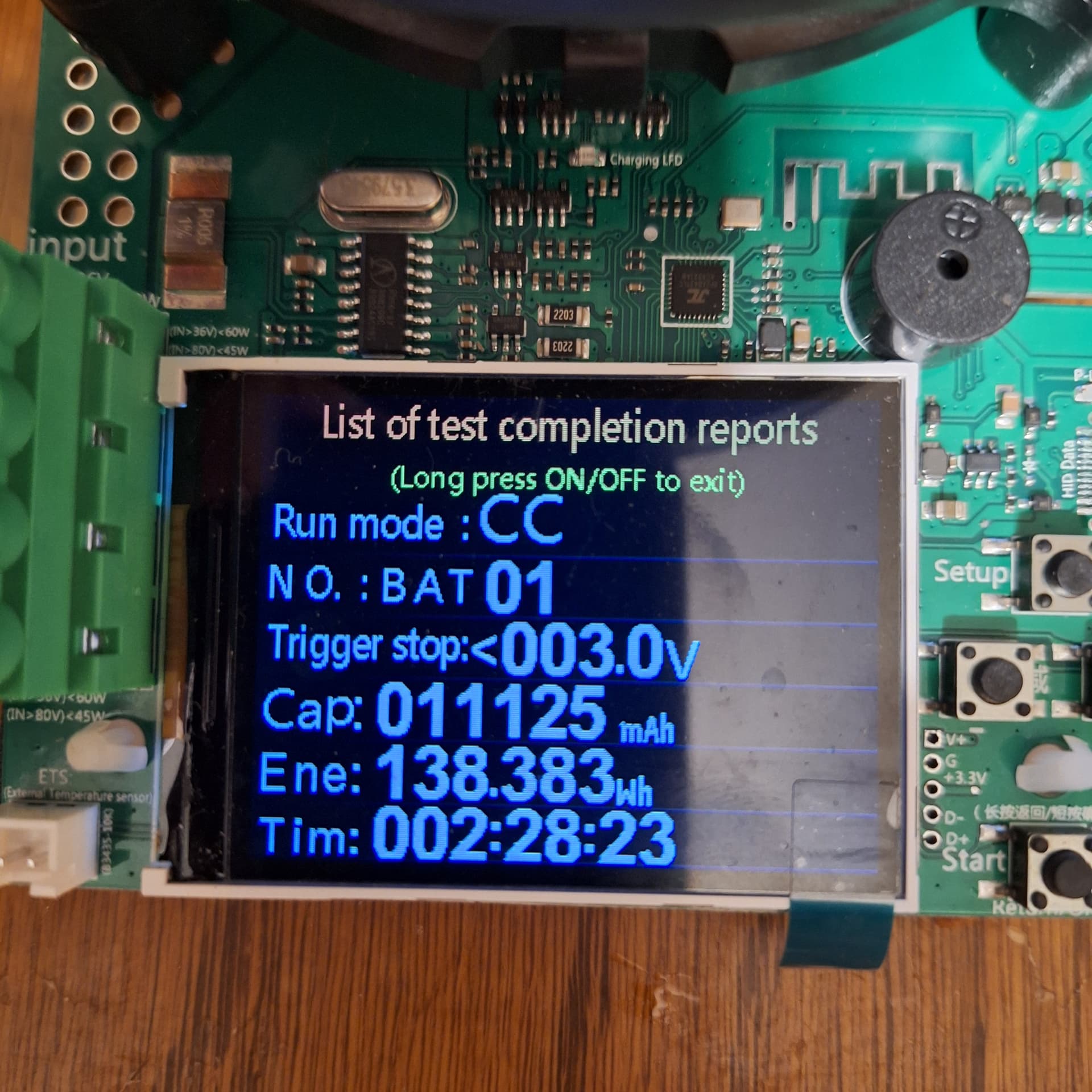

Well I am not a new user…but I have a question. I am in the process of testing a small power station/power bank. I got one of these Atorch load testers. The unit is rated at ~153 Wh/12Ah. When I test the PD output at 20 volts and 3 Amps I get 6551 mAh and 127.2 Wh out. (55% /83% of rated). Using the 12 volt dc output (constant current 4.5 amps) I see 11,125 mAh and 138.4 Wh. (93%/90% of rated). Can anyone tell me why this could be. My methodology perhaps? I know there is always conversion losses. But the manufacturer tells me both outputs should be better than 90%.
I am particularly suspicious of the PD mAh numbers.
DC
PD
mAh is capacity at a particular voltage. The “Ene” expressed in Wh is not dependent on voltage, it basically shows the total amount of energy available and those values are pretty similar for both protocols, a bit less for the higher power as is expected as this translates to higher amperage from the cell.
Yep. Those 12Ah is a capacity of the battery which is, apparently, LiFePO4 4S so has nominal voltage of 12.8V (12.8V x 12Ah = 153.6Wh).
Unless your station has a direct battery output terminals (XT60 e.g.) there is no point in measuring capacity. So compare only energy.
Why the measured energy amounts are much lower than declared ? … I dunno.
Maybe converter is very inefficient (for DC-DC converter this is unlikely). Maybe BMS cuts output too early. Or maybe battery has lower capacity than stated.
Thanks. The real question is why the PD output is measuring so much lower than the 12 volt output. Even using Watt hours. Certainly there is some voltage conversion inefficiency going on. Which would be greater for the PD output. As I think the 12 volt output is almost a straight through process. But the difference in the two measurements is way more than I expected. IOW if we use Watt hour it is basically volts X Current over time. So that number corrected for conversion losses should, in theory, match up pretty well. They are not that close. But there is an even bigger difference in the mAh numbers?
Crazy assumption: there’s a buck-boost converter, so double conversion is applied in case of 20V output.
Also to gain more food for thought you can run 12V and 20V tests at lower currents. If you have lot of time :slight_smile:
Thanks. Just trying to understand the differences in the numbers. I did use 60 Watt draw (or pretty close) for both tests. The total time to shut down is not that different. I got a 12% difference in the total discharge time and over 40% difference in the mAh numbers. Only about a 8% difference in the Wh numbers. There is something going on that I don’t understand.
I may try the tests at a lower draw, but you are right, it will probably mean another 8+ hours of testing.
