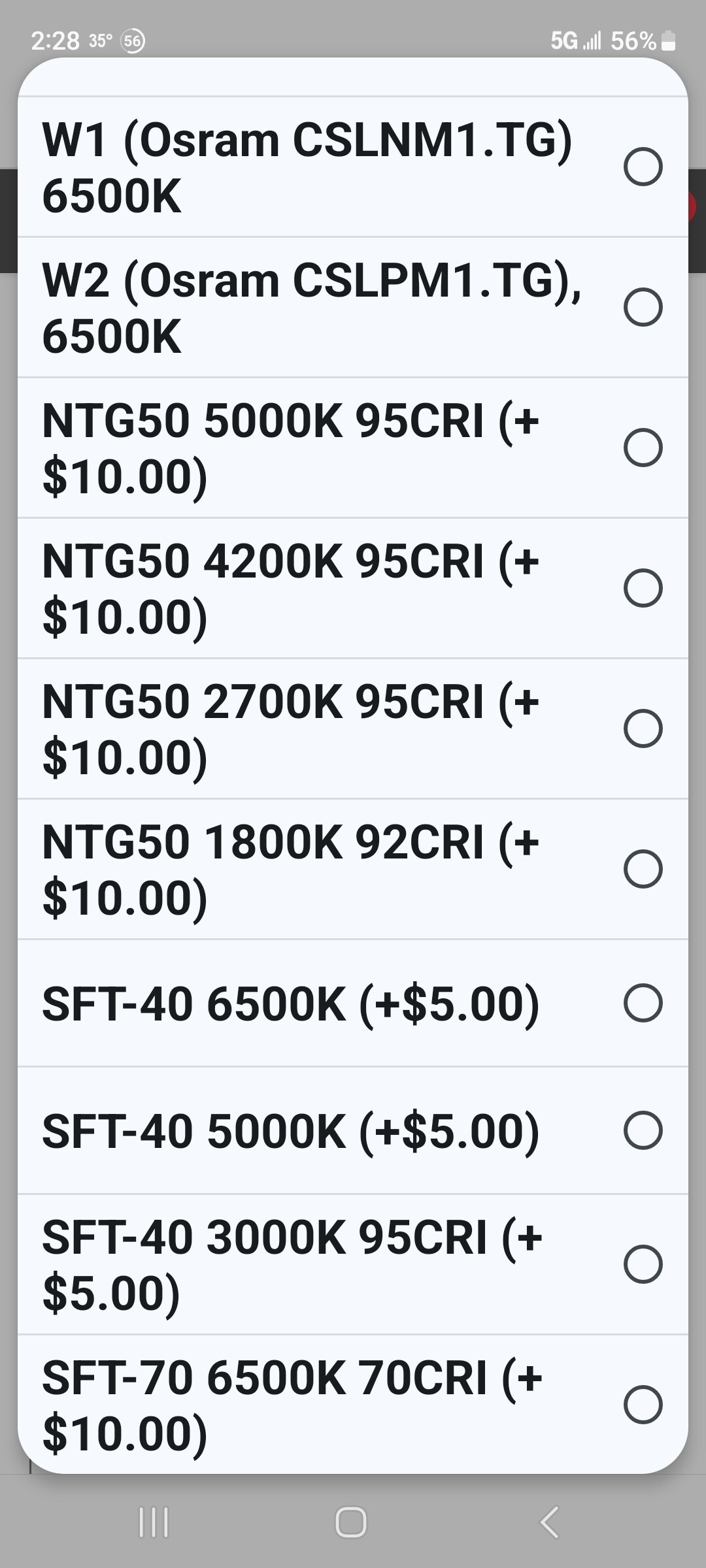

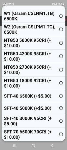

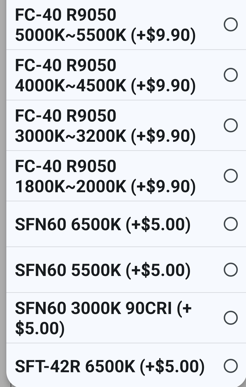

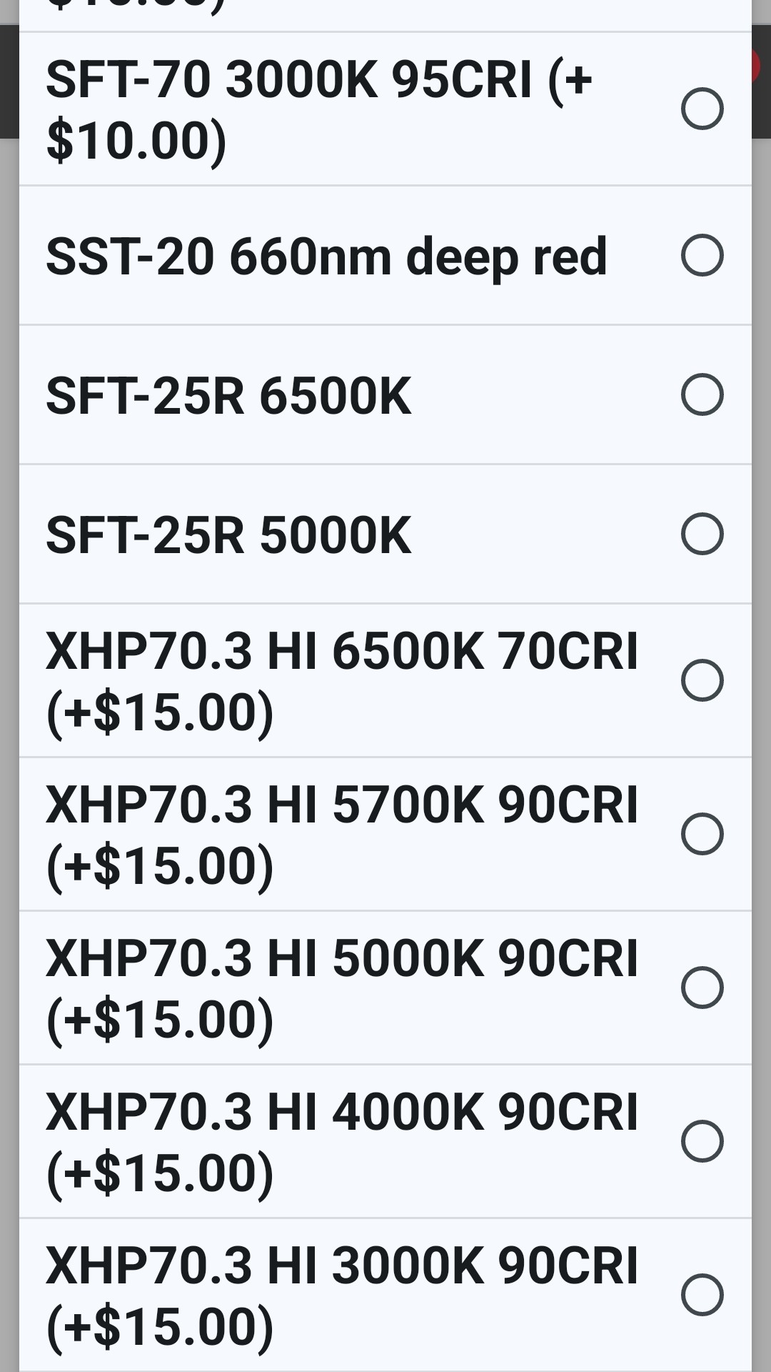

There are so many LEDs here that Iâm not familiar with.
Out of all the LEDs listed below which one has the best combination of output and throw. Sort of like the SBT 90.2 of all the LEDs listed.
It is For an Emisar D1K.
I am guessing that the XHP70.3 HI 6500 is a good choice??
Thx.
Iâd take the SFT42R, which is more than half of an SBT90.2 in performance and should get you around 700m of ANSI throw at 3000lm. In such a compact host, you need a reasonably small emitter to get good throw without draining the battery in a matter of minutes.
Agreed, or w2 maybe.

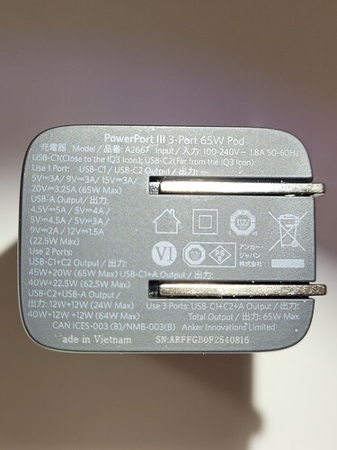

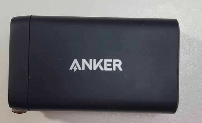

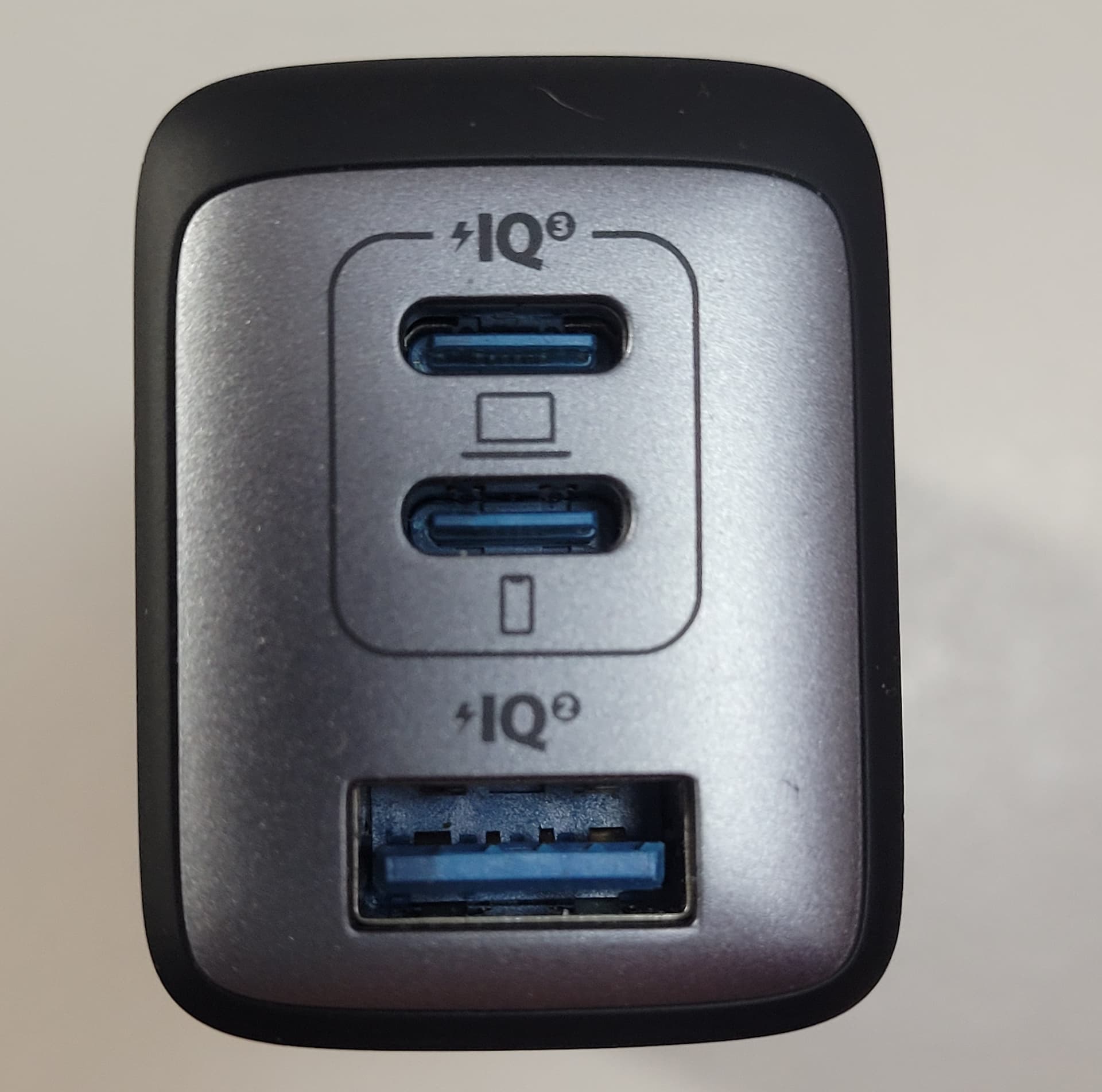

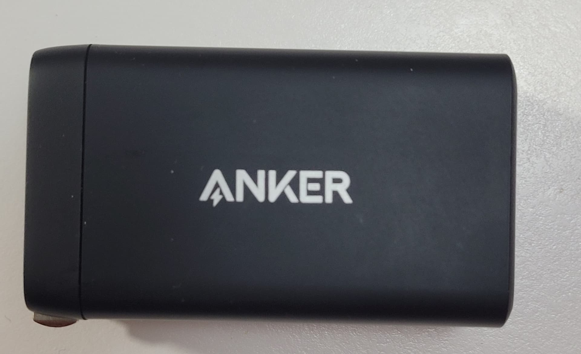

Can I use this Anker charger to charge a 46950 battery. The battery will be in the Lumintop Mach.. I hook up the USB and plug this into the wall instead of what they give me? I can tell you it takes 2 hours using this to charge the x75. Thatâs not bad at all.
I took some pictures cuz thereâs so much information on it. Probably the most important is it 65 Watts.
Thx.
EDIT: I just saw a review of this light that it takes 11 and 1/2 hours to charge with the charger they give you. I think itâs 4 amps. He also said with a 65 watt fast charger, thatâs what my Anker is, it took eight in a half hours. Iâm surprised it took that long. Because 8* 4200mAh( P42A) that is what the BP8 is, ⌠we will call that 32,000 milliamp hours. Same capacity as 46950,That only takes 2/ 2 hours 15 minutes. Maybe because they are parallel?
typically, a well designed smart/IQ charging circuit will give the devices whatâs needed. I donât know exactly how it works, but generally, if it is a modern power bank and a modern plug, itâll charge.
32000mAh, is it arranged 8p, 2s4p, or some other config? in any case itâs limited to whatever the circuit dictates. I suppose that in the 46950 cell, itâs designed to take almost the full 65WâŚ3.7V nominal Ă 14.222A, ~52W. if we assume 16A instead of 14.222A, then almost 60W.
HOWEVER, based on that chargerâs specs, the most itâs rated for at a single port is 40W, so whatever voltage and amperage its pushing would probably take longer than 2 hours to charge.
it ultimately boils down to how the charger, charging circuit, line power, and cell play together.
