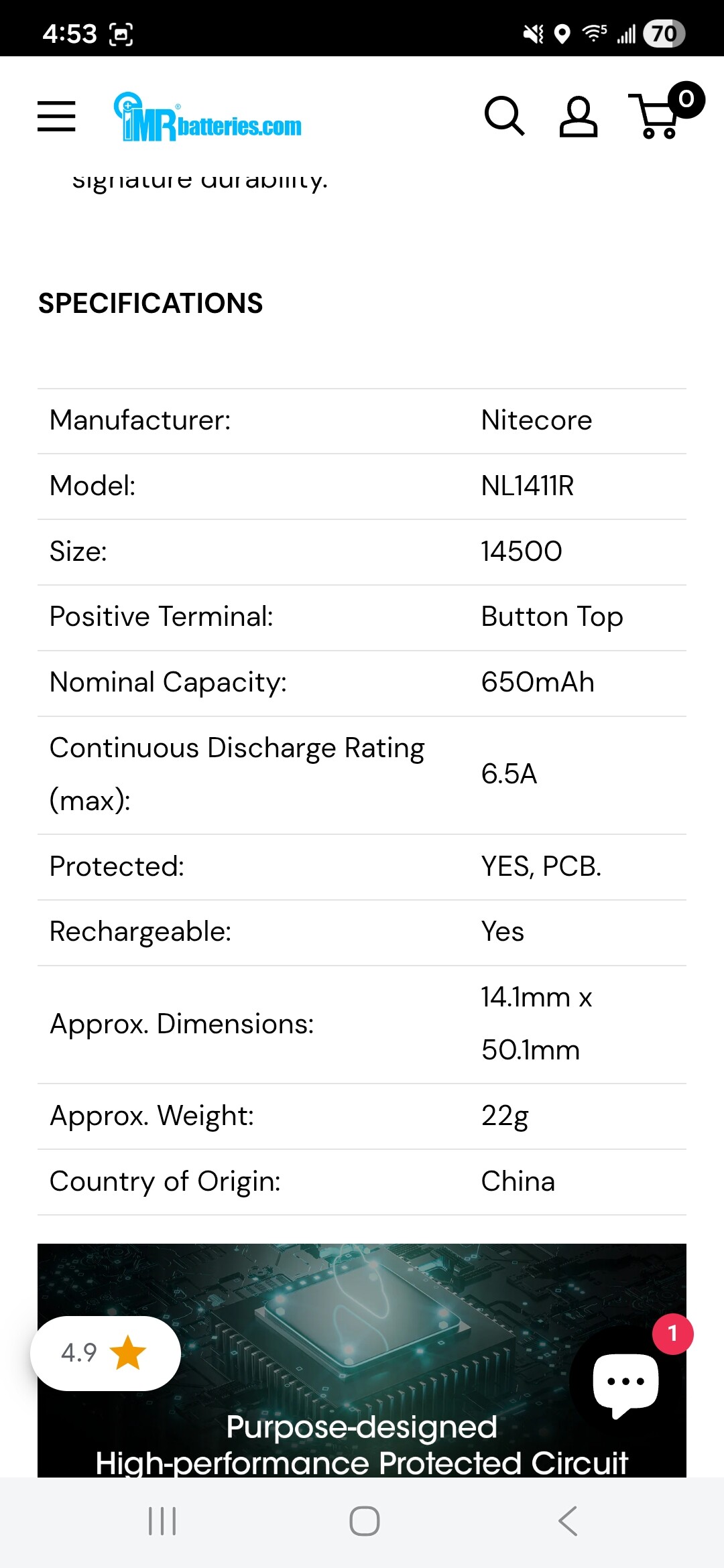

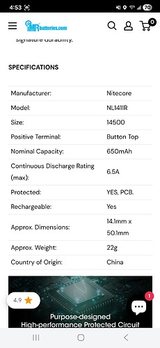

Oh, then depends on the light ultimately, if it uses more than 6,5A and 3,5A at max and if You plan to use that max. Both cells are protected so You might trip the protection circuit if You exceed their rating. And if I recall correctly the T6 has a 5A driver?
Do these specify max current? Continuous means the cell can work at that current for long periods, max is ok for a short time, don’t remember off the top of my head, but something like 15-30s maybe
Just a pesonal definition, but for me, a max continuous designation would be:
“At that discharge level for up to 30% cumulatively of the capacity of that cell.”
If a manufacturer says “peak discharge”, it should be able to handle spikes to that level. If it says “max continuous discharge”, then it should be able to sustain that level until at or near empty.
The way the site lists it is shady, in my opinion…why “(max)” if “continuous”, why not “max continuous” instead? I dunno, best bet is to contact nitecore directly and find out.

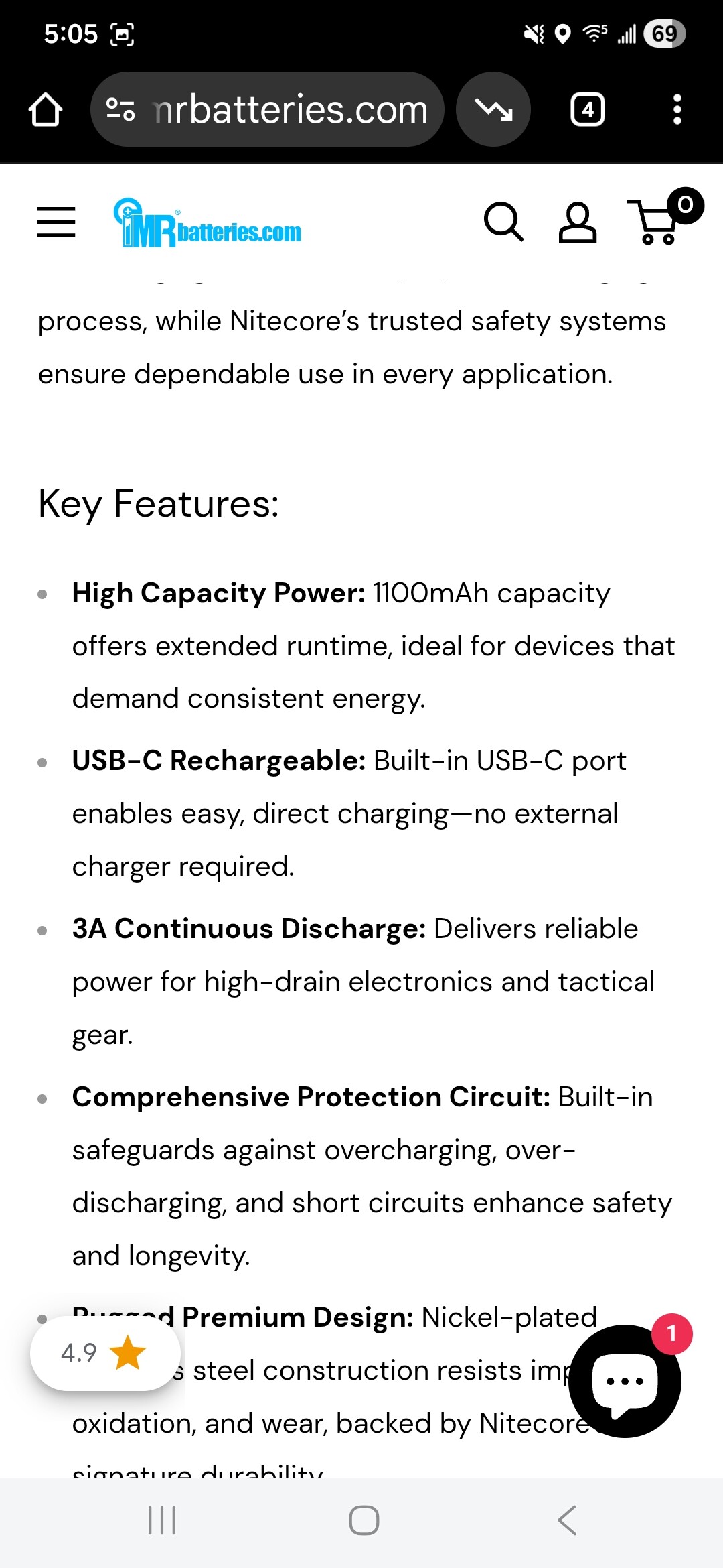

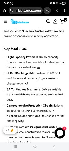

That shop You showed has mixed up description for the NL1411R. If You look at the following link Nitecore NI14500A 14500 650mAh Battery
You can see they copied the specs from it, a different cell altogether, not Your fault, I would take it up with the shop and ask for a refund/return
