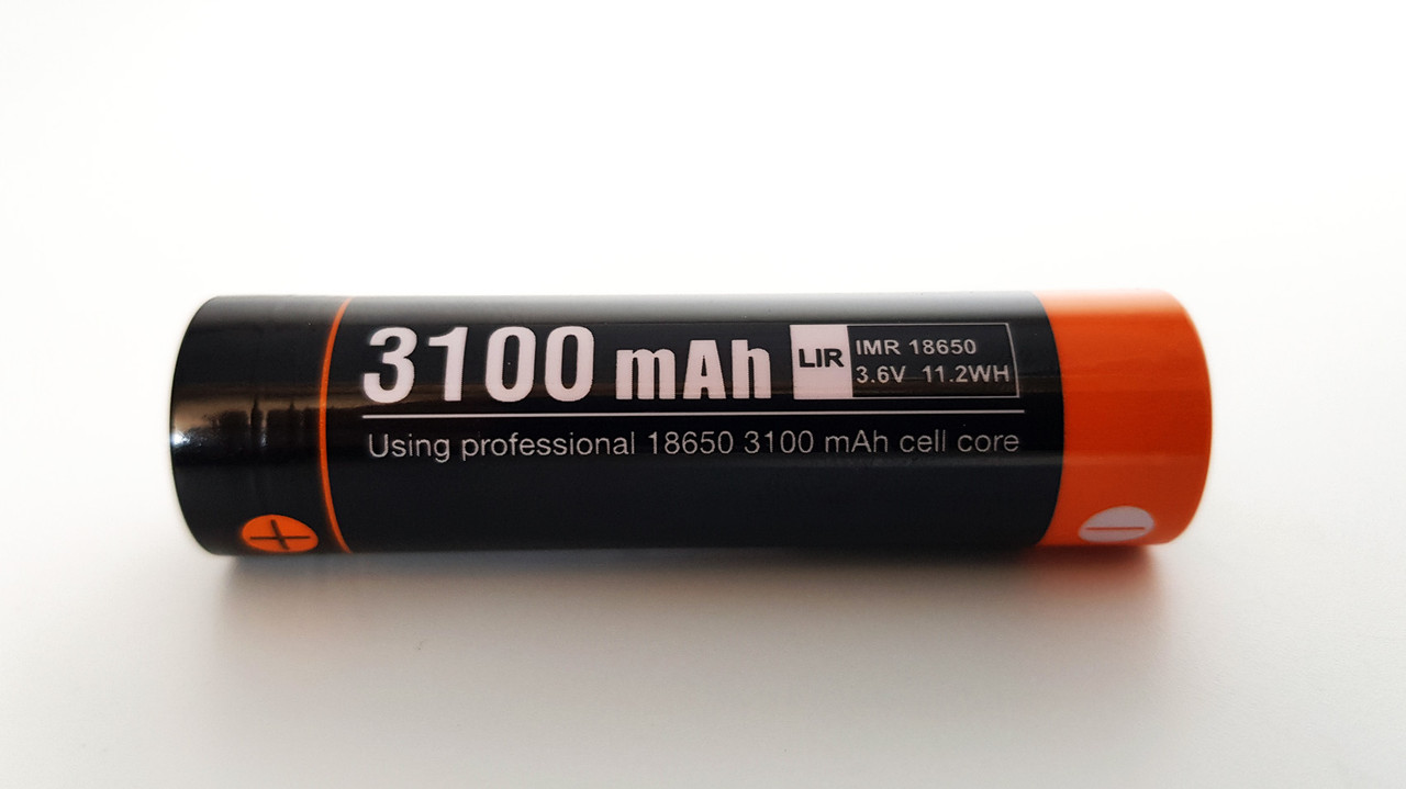

Does anyone know what cell is under the wrapper for the ACEBEAM batteries given for the:
X65 MINI - 4 Li-ion 18650 IMR 3100 mAh 20A ARC18650H-3100.They are Protected
My guess is 30Q OR VTC6?
,Thanks

I could not find anything conclusive, but Maukka tested them here and believes they could be VTC6. He measured about 3,000 mah. I dont know why Acebeam lists it as 3100mah.
If it is a VTC6, just keep in mind that it is rated at 15A continuous. It can do higher than that, just not continuously as it gets too hot. Acebeam puts 20A on the label as that is what the protection circuitry trips at.

I have some MJ1 UP BT I can use for spares. I think they have just enough amps for this[X65 MINI] Light.
