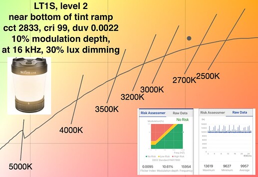

Things I like about the LT1S Lantern
compact size and single battery
built in USB-C charging and great battery life at modest outputs
can be used as a powerbank
NoPWM and very low Flicker Index
ability to turn off one side of the LEDs
adjustable color temperature (I like the warm end of the spectrum when winding down before bedtime)
Red light option
(not my pics)
