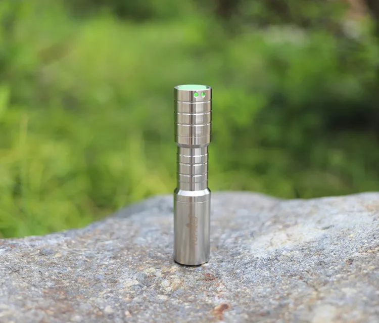

I own both a TG06S and a Jaxman E3.
The hosts are similar, but I have the new version E3 so there’s definitely some differences. As a complete light, I’d definitely recommend the E3; even as a host, I’d recommend the new E3 due to the stainless steel bezel.
If you have the opportunity, please buy from Jaxman: https://jaxmanjaxman.aliexpress.com/
He’s just one dude, making lights his way, and the E3 is not the first light of his that has been ripped off. (Infamously the “Cometa” is a copy of the Jaxman Z1.)

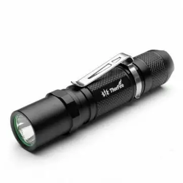

1 - for the 17mm drivers, I believe that the Convoy T2 (and copies/rebranded models, such as Manta Ray or Dancelite) will probably be the best host and the “cheapest” (~12-13€).
2 - the Alonefire X360 (similar to Sofirn SF10) and X380 (similar to the jaxman/ thorfires) will follow the T2. I bought an X360.
3 - for the 15mm driver, I am almost sure that the Lumintop Tool AA will be one of the best hosts, even if the driver need to be adpated to the pill, and it is one of the chapest. (well, in case we want a tailswitch, and not a cheappo twisty).
The T2 and the Alonefires are bigger but they can become almost “indestructible”, capable of taking a good beat.

Today I received the Alonefire X360 I mentioned above.
It is very similar to the Sofirn SF10, uses Neutral White XP-G2, driver is 17mm, with retaining ring. OP reflector
The physical lock-out is not possible (as it wasn’t with the SF10).
Modes are H > M > L > ML , all with PWM. Strobe is possible with double click.
Being a sturdy light, it will be a nice host for one of gchart’s drivers. ![]()
