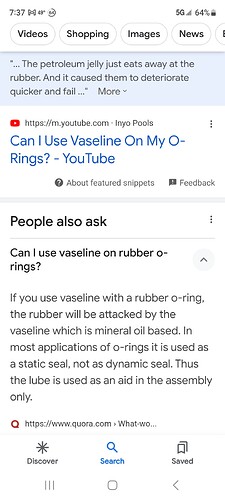

I heard something comparable to this several times. I definitely wouldn’t use vaseline.

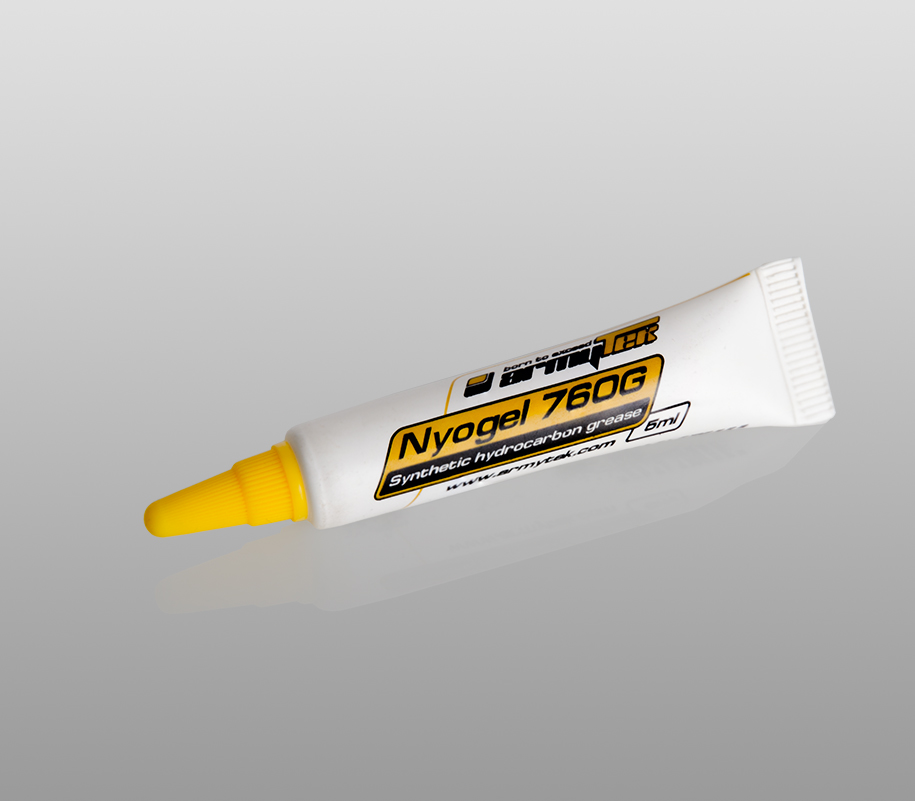

@TimMc . Where is that photo from? I recently bought some 760G (BTW, So far I like it. Great for Ti threads).
The only problem is the size of the tube. Probably enough for more than a lifetime of use for flashlights. The pic looks like it has a smaller tube. But I can’t read it. Several people in other threads have asked about getting a smaller amount.
It’s a 5ml (edit: 25ml) tube of nyogel from Armytek. It’s about the same volume as a 21700 cell.

Thanks. Smallest I found on the Nyogel was 50 grams. Way too much for my use. But I bought it to try.
I do like it. I have to say it is the best I found for Titanium threads. I just recently got it, so only time will tell how it works over time.
