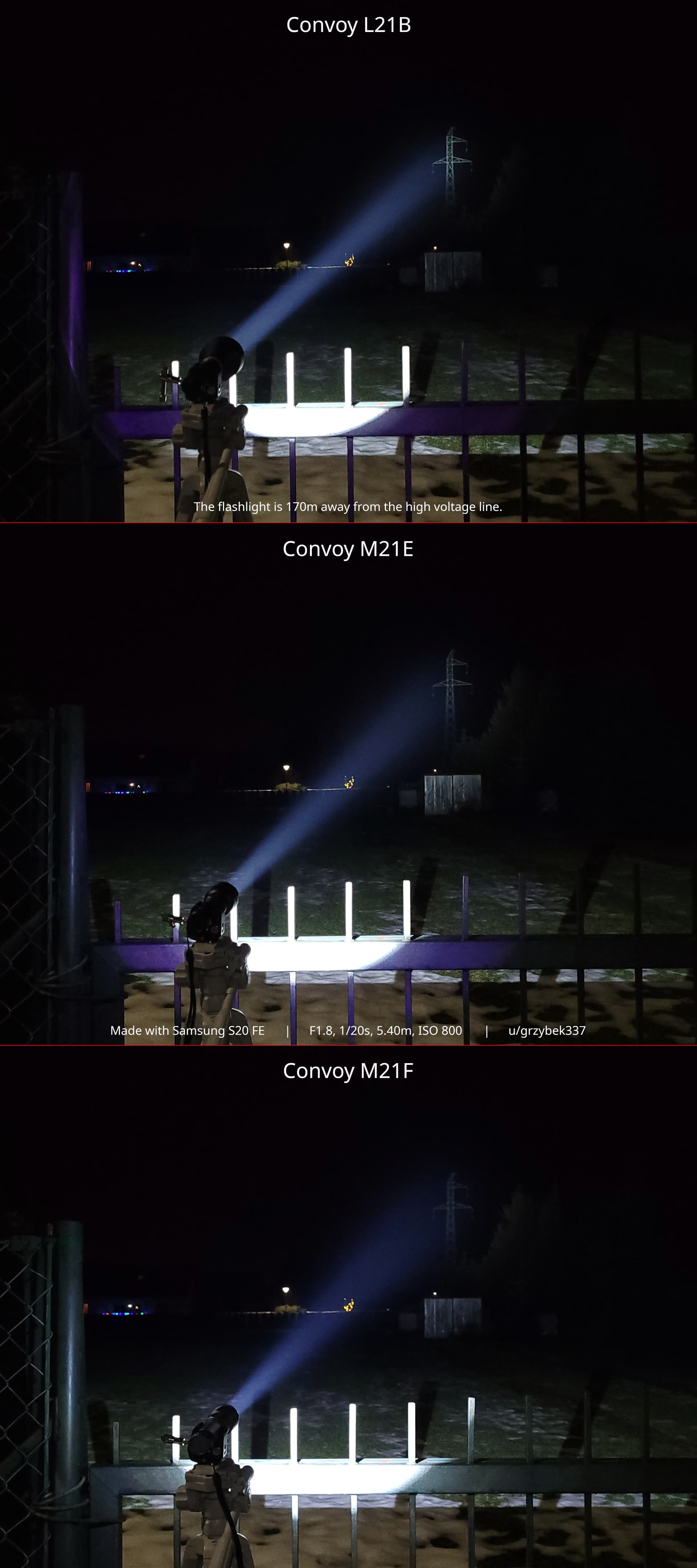

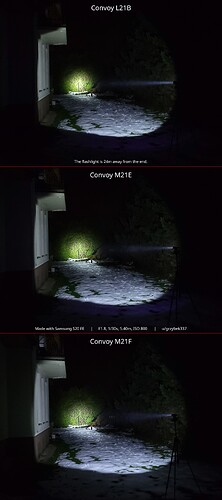

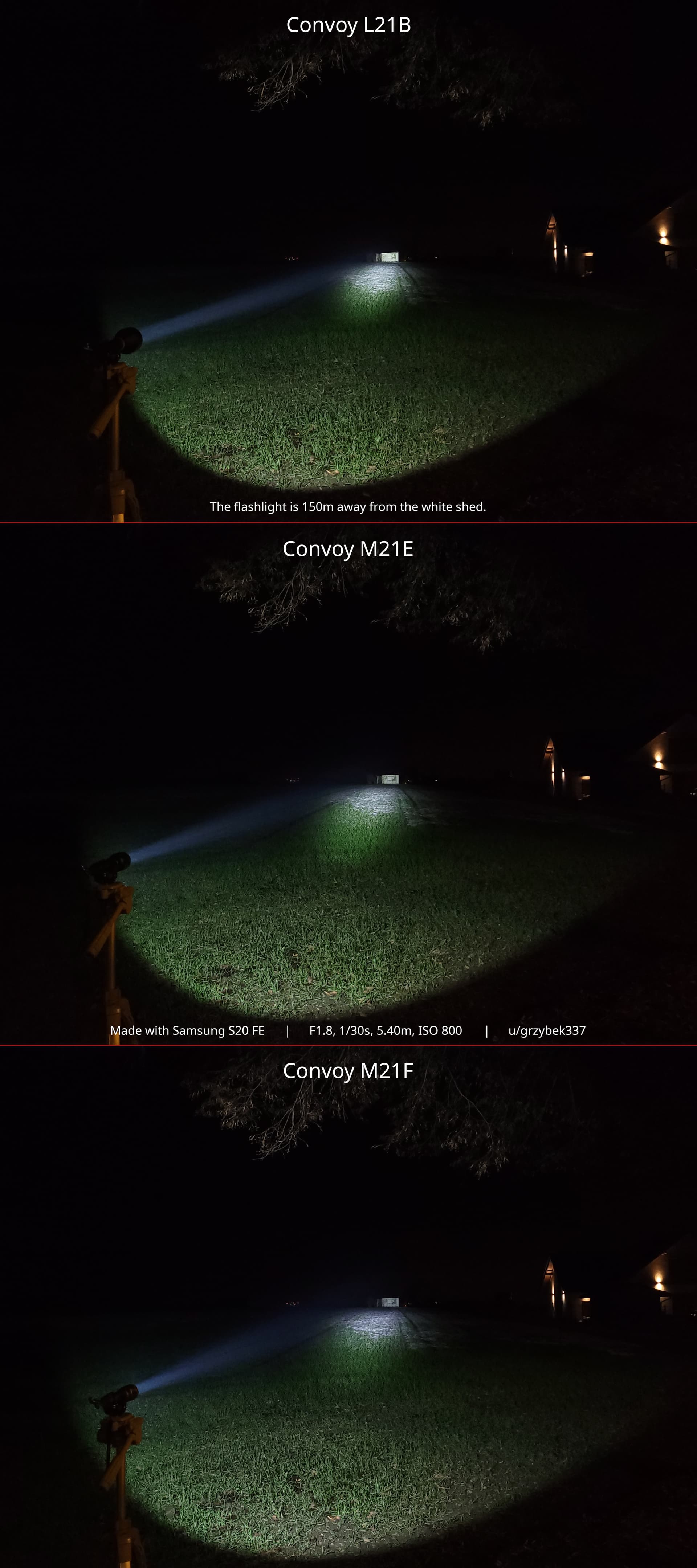

Flashlights compared (L to R) (measured ANSI throw):
  • Convoy L21B SFT40 (1300m)
  • Convoy M21E SFT40 (890m)
  • Convoy M21F SFT40 (700m)
They all use standart 21700 cells.
M21E and M21F use a side-switch and have integrated USB-C charging. The L21B has a reverse-clicky tailswitch and is available with either the 12-group UI or the simpler 4-modes UI.
30 meters:
50 meters:
150 meters:
170 meters:
350 meters:
