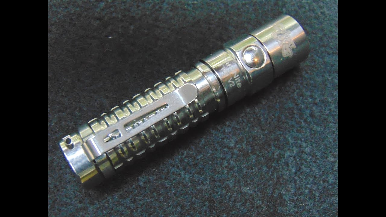

This is a dual chemistry light , meaning it can work from AA (alkaline) , NiMH , or 14500 cells. It is also made from Titanium , so (in my personal opinion) looks very stylish.
The light is pretty compact and has a magnetic tail , so it can be used hands free when stuck to something metallic. The magnet holds pretty firmly on something like the rougher Refrigerator surface and especially on a flat surface , as demonstrated with the scissors and the metal Thrunite box the light came in , even through the outer cardboard box , it still holds pretty firmly.

The Clip can be attached at either end of the tube for head UP or head DOWN carry of the light. When the clip is attached at the head end of the light the T10T V2 can also be used as a headlamp. There is also an eyelet in the tailcap if you wish to attach a lanyard. The clip on this light is also made more sturdy than the original model of this light and will stay put on jeans , slacks or a ball cap with NO problem.
“Ribbing” instead of knurling is used on this one. It provides sufficient grip and I like the looks of the ribbing on this light. The threads are well cut on the tube and inside the head also. The spring inside the tube (one piece tube) looks to be well attached in the bottom.
The branding (etching) is also well done on the light. The emitter has been changed from the original T10 V2 , which had the XP-G3 and the T10T V2 now utilizes a XP-L emitter with OP reflector (pretty much perfectly centered on my sample). In the end it proves to be a much smoother beam than the original model and without the olive or greenish corona around the hotspot as the original model had.
