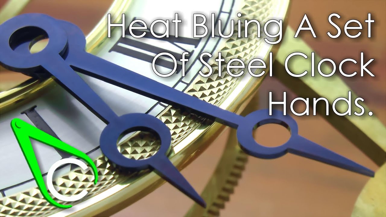

Here’s a video that explains it a bit better. He does his with steel, but the principle is the same with titanium.
Looking forward to your updates!
Thanks for the video. at 5:00 mins, what is the box and material in it?
It stopped the steel to be touched by fire directly.
Brass and brass shavings I believe
