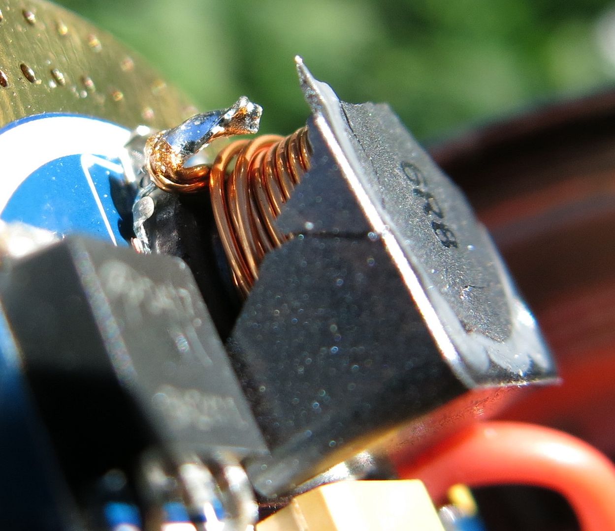

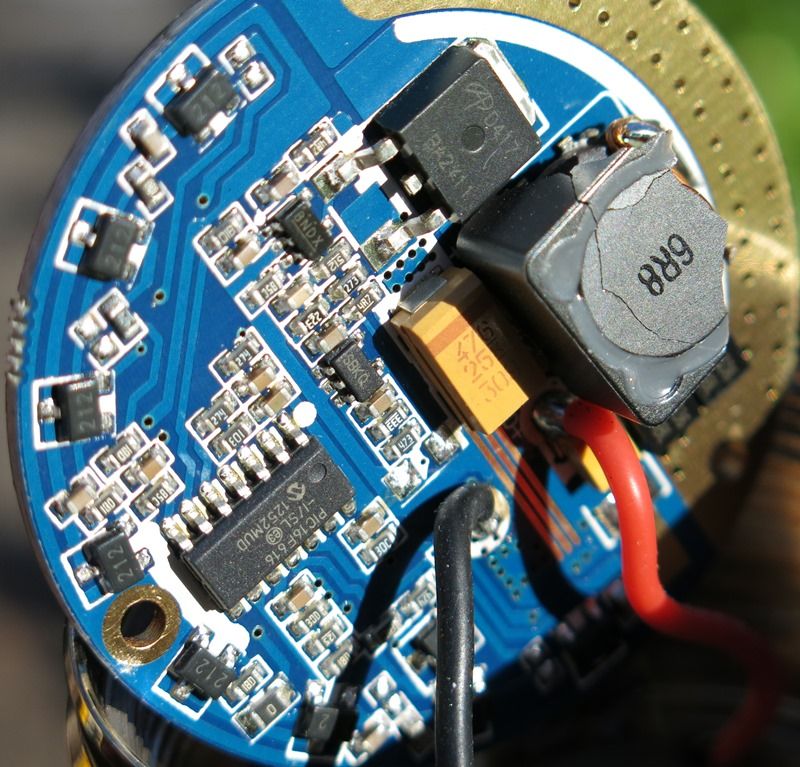

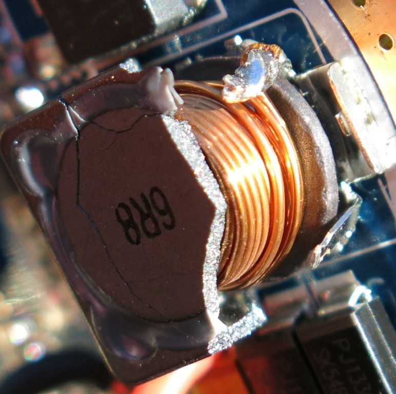

I have just pulled the driver out of it and was surprised to find broken plastic parts which were originally from around the coil. The following pictures are from this light.

looks like the coil got extremely hot, maybe do to a short in the curcuit, or did something contact the coil to break it? ( as in a part of the magnetic control ring turning & hitting it and breaking the coil’s casing)

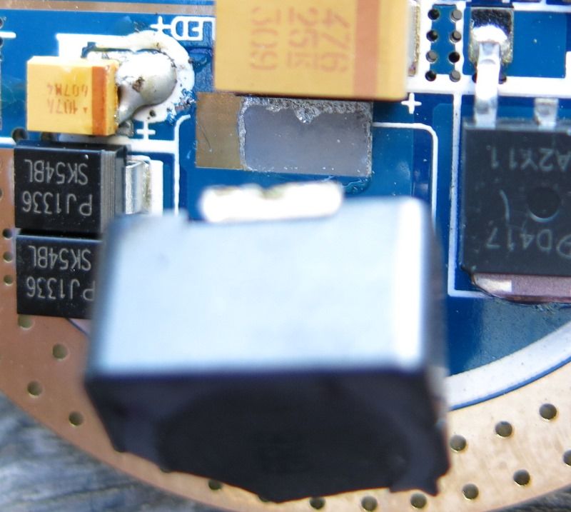

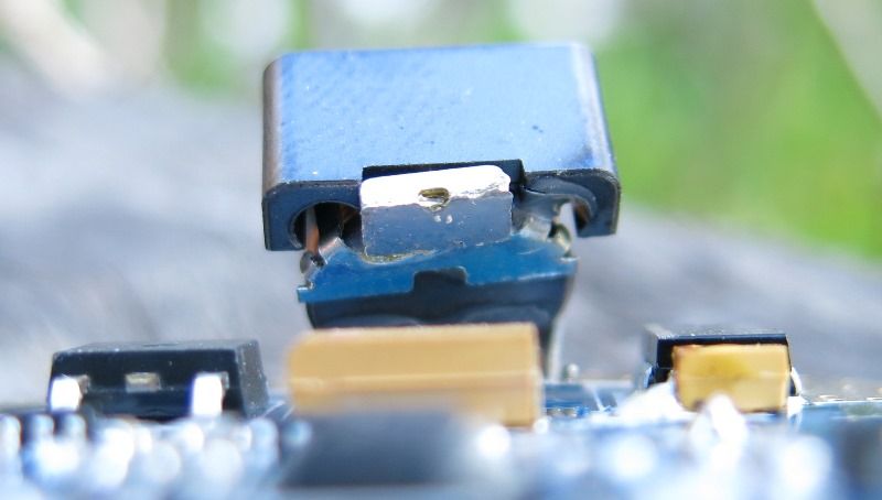

I cant see anything that can come into contact with it and theres no smell of anything that is burnt. I've just removed the drivere and it appears that there may of been a dry solder on the pad under the coil. I'm not sure if this a heat or electrical path.
That's not plastic,it's ferrite/iron powder.Replace inductor and it should be ok.
No…cheap Chinese ferrite coils…I have a 470 coil in a “tail light” that I put in my riding mower as a headlight and one didn’t work…so I ended up opening it up and sure nuff…the coil was split in two
That pad is a surface mount power inductor
Need a measurement of the size of the inductor, the distance between the pads, and the size of the pads
6R8 is 6.8uH inductor

The inductor is about 9.5mm square but the pad that is not attached sticks out making it about 9.5 x 11.5mm. The pads on the driver are large being about 7x3mm. A smaller inductor would make it a lot easier to solder on as theres no room on the side that is not attached due to a yellowish block being in the way to get a soldering iron tip down there.
Have you tried going to thrunite? That’s no doubt a cold solder joint, the pic clearly shows that, ask for a replacement or to buy a whole new driver for parts.

Bump. Just wondering how this faired for you after contacting Thrunite. I have this exact same issue with my TN32 except mine still works as normal. Heard something rattling in the head so I took the driver out and the coil was cracked and broken pieces of metal went everywhere.
