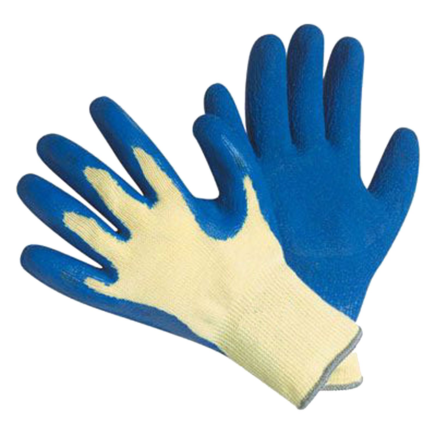

I’ve bought a lot of work-type gloves in my lifetime and while most of them were barely just ok they never fit my hands/fingers as well as these, much less gripped as well as these. I’ve bought 6 pairs already and everyone of them is consistently cut so that I can pick up a dime on a concrete floor without a blink. And man do they grip flashlights well.
I wear a Medium. IOW, the smalls are true Smalls, the mediums are true Mediums, and the Large/X-Larges are true too. Soft knit tuff yet comfortable fabric on the back that still allows your hands to breathe and flex. I don’t know how they did it, but they did it. I’m convinced a glove genius may have designed these.
At less than $3 a pair an unmitigated flaming bargain. On sale they go for $1.99. Ridiculously and embarrasingly effective compared to other POS gloves that cost 10x as much, fit loose in almost every finger, can barely pick up a large screw off the floor, are mis-sized, or cut grossly incorrectly. These are none of that shoddy BS “It’s a Brand Name so it must be good” yet actually non-functional misleading crap.
If you can’t unscrew something on a flashlight with these then call in somebody a lot bigger and stronger like the Mother-in-Law.
Thank me later.
http://www.harborfreight.com/coated-rubber-grip-gloves-medium-90909.html
I’ll definitely pick up a pair on the next trip to harbor freight.

Thanks for all the helpful and useful advice so far! The Harbor Freight gloves referenced above seem to be a good bargain. I’ve also found using a Sharpie style/sized marker, like their fine point series, that fits in crenulated groves if they’re deep enough and gives one leverage to spin off a crenulated bezel… they’re also a soft plastic and shouldn’t damage the metal. It seems to me there should be some plastic tools to remove the really short crenulated bezels or the smooth bezels with dimples along the inside, somewhere I saw mentioned using a watch case removal tool.
