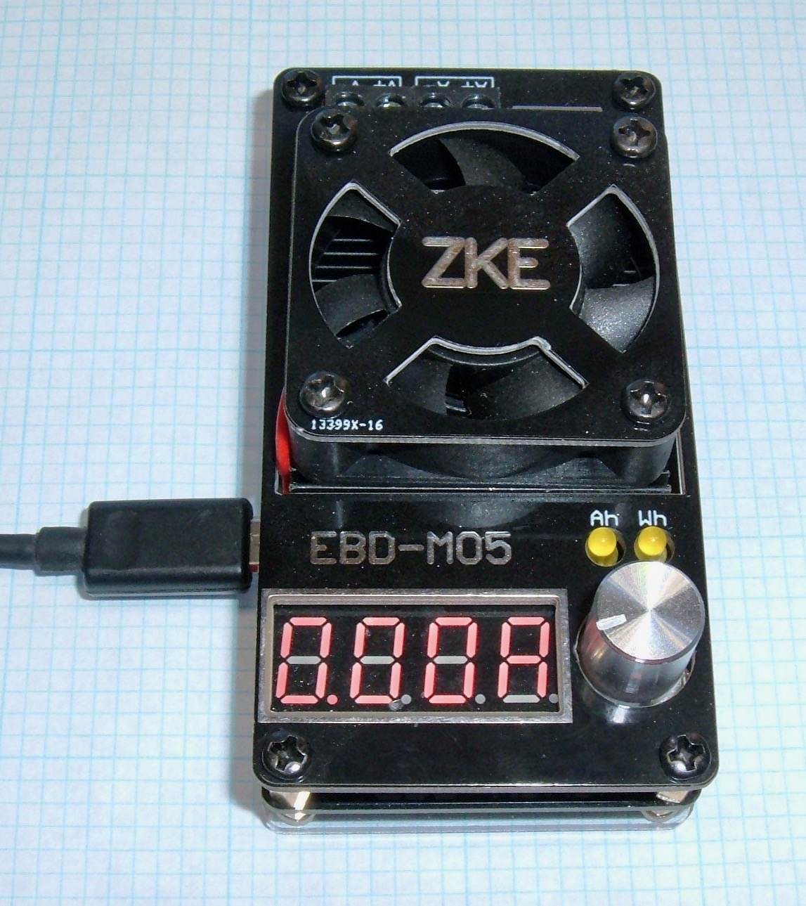

There’s the smaller EBD-M05 (5 Amps / 30 watts max), this is also 4-wire measurement. Can also control cut-off voltage. Price should be somewhere in the US$20 vicinity.
And likely some other models I haven’t really tried checking from their site.
(I have the EBD-USB+ and EBD-M05 although I don’t have a proper battery cradle/holder so I haven’t really used my EBD-M05 much ; although I use the EBD-USB+ quite regularly for checking USB devices, powerbanks, etc).

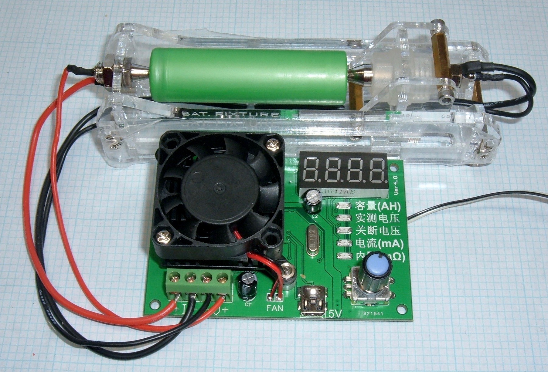

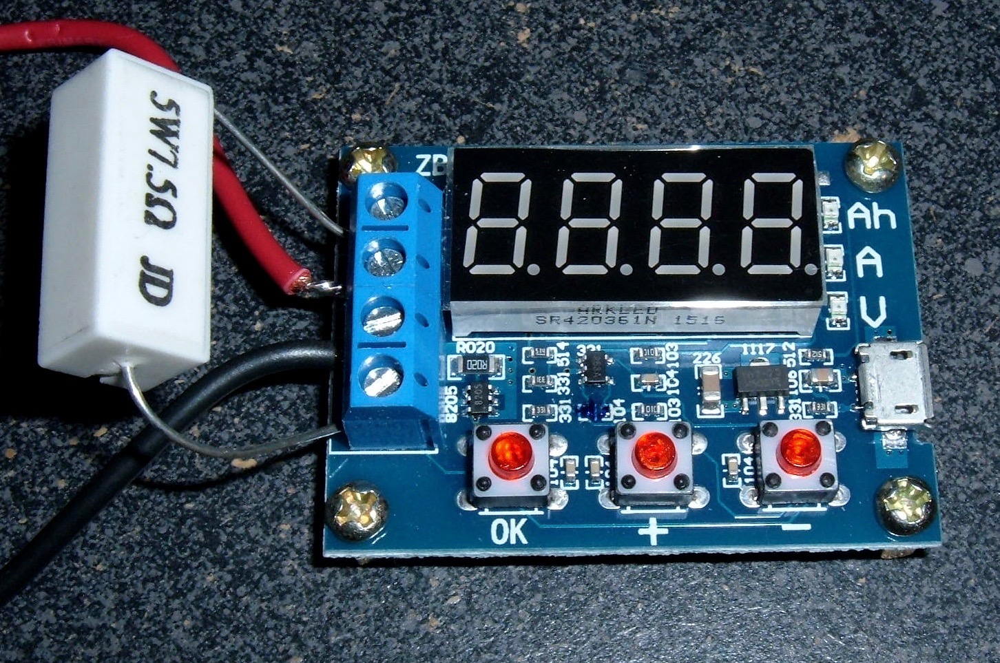

This site has a review of several of the smaller battery discharge testers (has voltage cut-off):
I think the EBD-M05 is rated more highly.
Followed by the TEC-06 and ZB206+, which seems to be OK for their price.
The ZB2L3 and HW-586 not so much…
