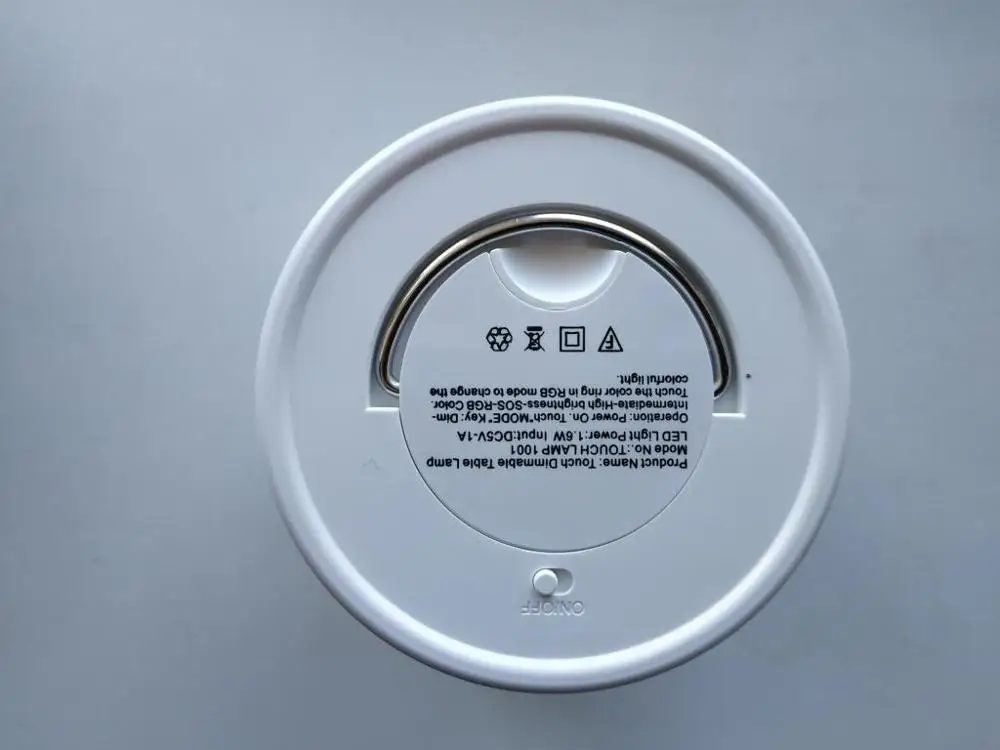

Maybe this opens up?

The battery in the lamp cannot be removed, the bottom cover is glued. The lamp has PWM in most modes, it does not shine very brightly, but like a night light or evening light, it is quite acceptable. I did not succeed in disassembling the flashlight without breaking it, so while it is working normally, I left an attempt to get inside.

I bought Lantern a year ago at Gearbest. It works reliably. Changing colors is very easy. It is not sealed with glue. It is easily demountable. The battery can be replaced when it is connected to the connector. There are three small screws under the sticker. Other screws are at the bottom. Remove the bottom cover and remove the batteries. The circuit board is also fastened with screws. The battery connector is at the bottom of the PCB. Disassembly is complete in 5 minutes.

Just because yours wasn’t glued doesn’t mean that’s the case with all. There could be variations between all the different sellers
It is true. The only certainty is death. Perhaps my answer helped someone…
