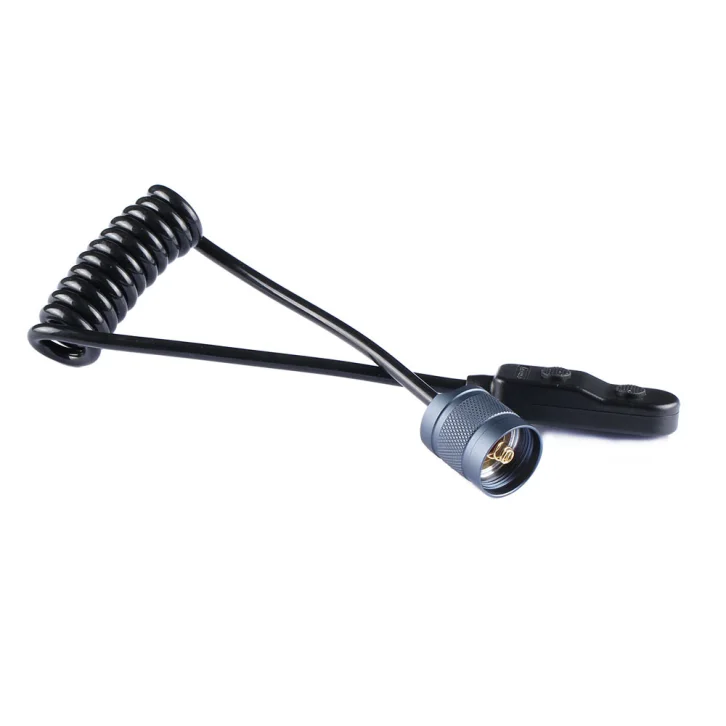

Transistor MOSFET tailcap and switch cord extension?
Are there any switches like that, but one that use mosfet, not direct current?
Problem is resistance of such switch and cable - i tried to mod it with much thicker cables, but still, resistance is around 0.2 ohm, so that is FAR 2 much for switch.
Basically id like to have bicycle light with remote switch, but I would like to push more amps, and its impossible with remote switch like that that just use like half meter of copper wire, even if I use 2mm copper wire resistance is too big.
