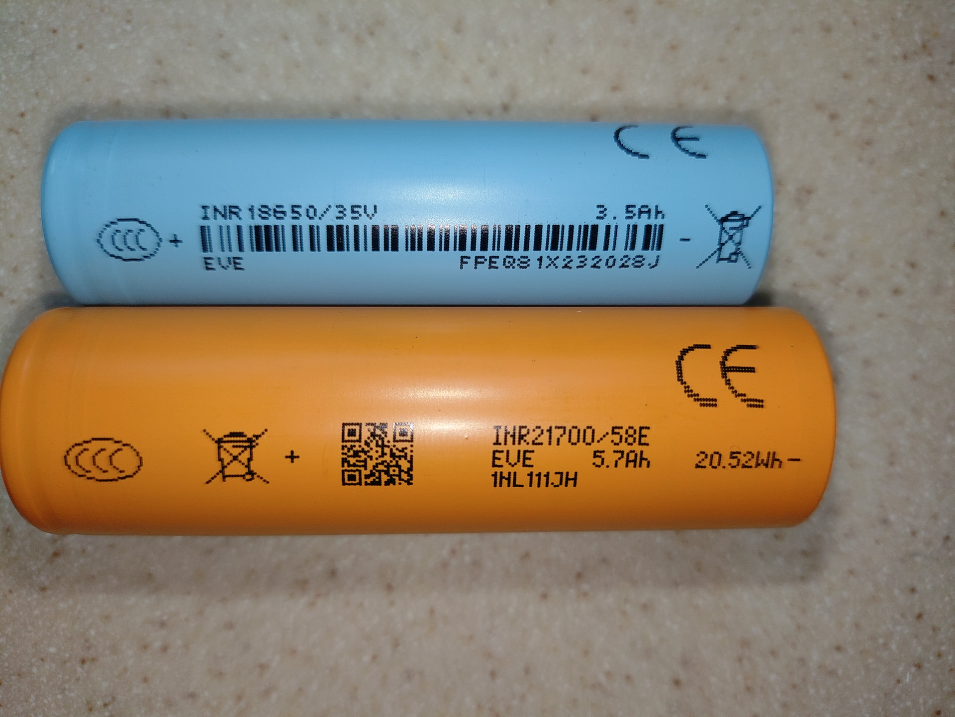

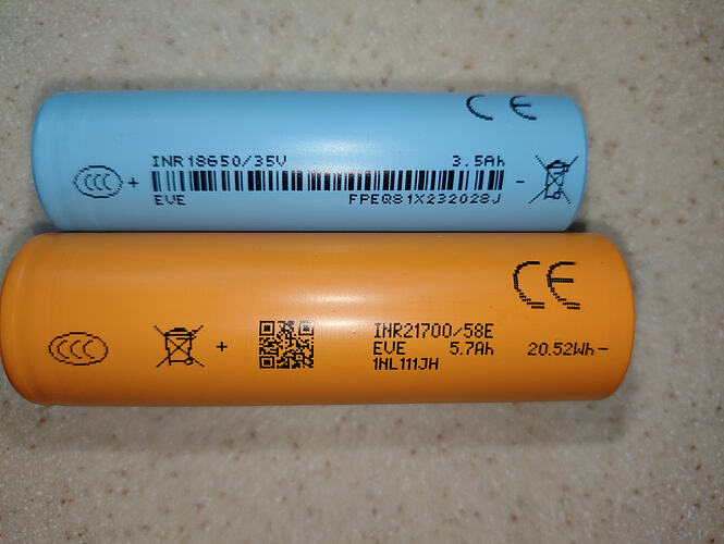

I’m not sure what they’re enforcing at the airport but China has a 2024 law requiring the CCC mark on lithium batteries and power Banks sold and transported in country. It stands for China Compulsory Certification. It means it has passed a series of tests laid out in some certification standard that they’ve adopted.
So to get around it I would recommend carrying an additional flashlight or 3 with type C port to recharge things.
Or you have to buy new cells. It looks like Eve is putting the mark on most of their cells now but companies outside of China probably aren’t real keen on doing that.
Thank you very much for this information! I am not up to date on this. The cells you showed do have Ah /Wh ratings, and should hopefully be ok. Luckily, my old cells are wearing out and I plan to get a bunch of new cells, all of which are from Chinese manufacturers.

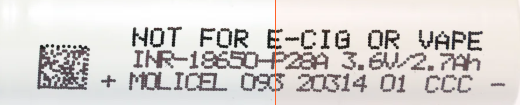

Do you think the “CCC” at the end of the Molicel P28A label stands for this certification?

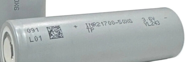

Strangely, Tenpower, being a Chinese manufacturer, does not seem to have the CCC on the 50XG:
There are a few caveats. First of all I’m not fully up to speed on this. My understanding is:
If the batteries are being manufactured to ship outside of the country then they don’t have to bear that Mark and I believe they don’t technically have to pass that certification. But apparently some or most manufacturers just make sure everything’s going to pass that standard and put the mark on everything because some of the product may end up in devices in China. But the other thing is when they first start a batch and it hasn’t been tested yet you may have stock images of a battery before it has passed the tests and those images may be of some of those first test batches.
So if you want the Mark you may need to ask the retailer where you’re going to buy them if the Mark is on there.
Apparently there are also other carve outs. If the batteries are manufactured for industrial or medical or specialized equipment they don’t need that CCC mark. They are still required to go through other rigorous testing procedures. But they’re not necessarily manufactured for portable consumer use. So batteries with 50 amp CDR aren’t designed for portable consumer use. So I guess as long as they have all the other information that you specified above, the airport maybe okay with it.

Even the EVE 35V you photographed above won’t be let through because it doesn’t have a voltage rating printed, as completely obvious as it is.
