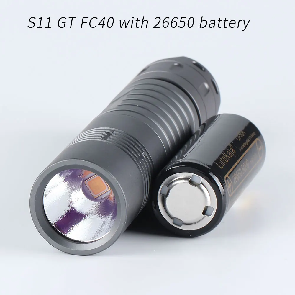

I buy a Convoy S11 GT FC40 with battery on Simon store on Alie.
I have a problem when the lamp is at full power at 100% : Every 4/5 seconds it goes out and comes back on half a second later. I hear a little noise, a click each time it happens.
