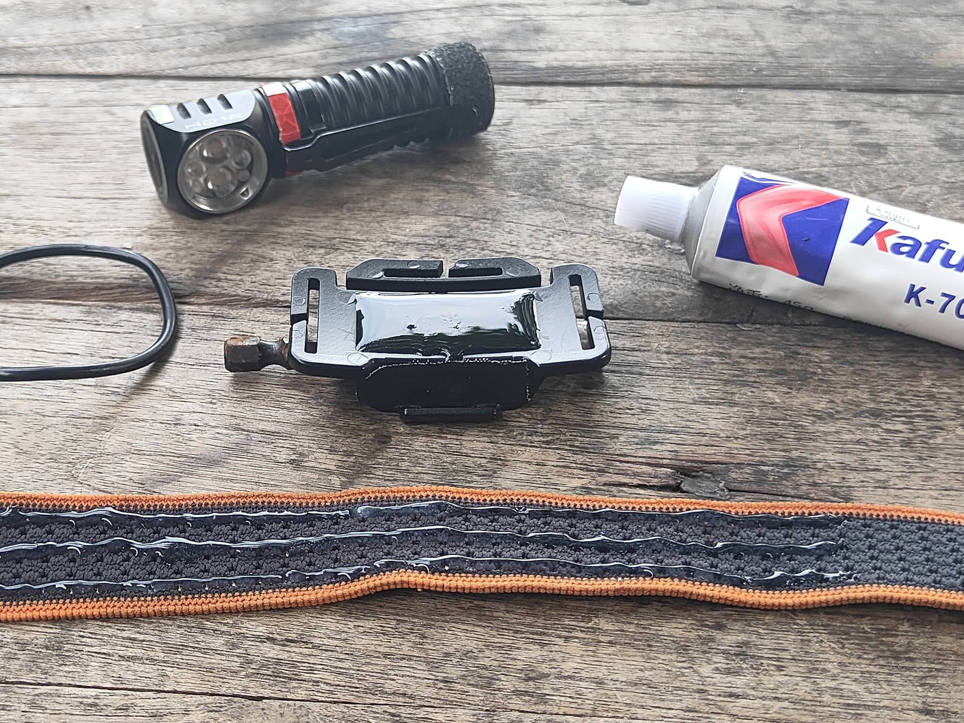

Trying to make the head strap more comfortable
It’s setting, so I can’t report the results yet, but there may be another use for Kafuter K-705.

:⁠-⁠) I’m especially curious how this extra ‘cushion’ that I made by filling the bracket void (which will be under the strap and will be still softy even when it cures) will work. Need to wait a day or two as it cures with moisture, probably a few mm a day.
p.s. I’ve heard about Kafuter before, but @QReciprocity42 recent adventures with domes reminded me about it. Kafuter has the whole variety of glues. This particular one is a pretty flowing and self-leveling silicone which adheres relatively well and cures to a v. soft rubber - feels like Haribo Goldbears.
This is a bit different from silane-based UHU Max Repair, which I’ve been happily using for years and almost used for the strap. UHU is more adhesive (sticks to fabric pretty permanently) and cures to hard rubber, but it almost doesn’t flow.
Will report.

I love UHU - will definitely stick (I used it to ‘weld’ tears in fabric). The end result will be rubbery, a little on the harder side - but structurally strong. It’s pretty thick and harder to spread and level.
The K-705 (that’s the one I used above) sets softer and may not stick to the fabric forever, but spreads well and seems to adhere well enough. Being soft, it’s pretty comfy on the head and stretches well with the strap.
There is another idea that I haven’t tried. There is another Kafuter (there is a lot of them actually) K-5705 which is supposed to be even thinner. So maybe the idea of stencils or masking and painting with it could be the neatest?
On the HD12 strap, I put masking tape behind it for the silicon not to drip through the holes. For the bracket I roughened and cleaned the surfaces.
p.s. The shoulder strap looks like a job for UHU.

Since it’s made for fabric applications, the transparent version (though white out of the bottle) flows with the consistency of a white glue like Elmers®. When spread out lightly in a thin layer over a masked-off area as I did with a tiny paint brush, it dries to a soft, yet firm & flexible “non-slip” end product as silicone does. After a couple of years of nearly daily use on a knee sleeve, which I wash regularly, it’s maintained its flexible, non-slip properties with no signs of degradation. Hopefully that helps!
