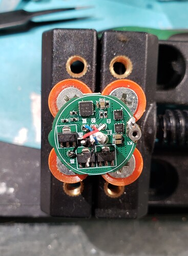

Here’s a pic of the driver out of my TS10 Max:
7 Thanks
Thanks! I was just replying that I wished I could see the other side but I wasn’t interested in looking myself.
So that answers the question, just one 7135 chip, right? Thise two others that look similar are something else?
If there’s just one, that’s too bad. Seems like there’s room for more with a little rearranging (maybe easier said than done).
The bottom right one is the 7135, and I believe the other two are mosfets. I’m far from an expert though, so I very well could be wrong.
Looks like it, yeah. Odd form factor for MOSFETs.
Looks to be a single 7135, and then it has two SOT-89 mosfets (for direct drive)
It probably uses the same firmware as a TS10v2, which would mean it uses “hybrid” drive up from the max 7135-only until turbo, which uses PWM switching between the 7135 and the FET
The TS10 uses them as well, IIRC.
It mightve been done for some supplier reason, instead of the usual 5060 MOSFETs that so many other drivers use.

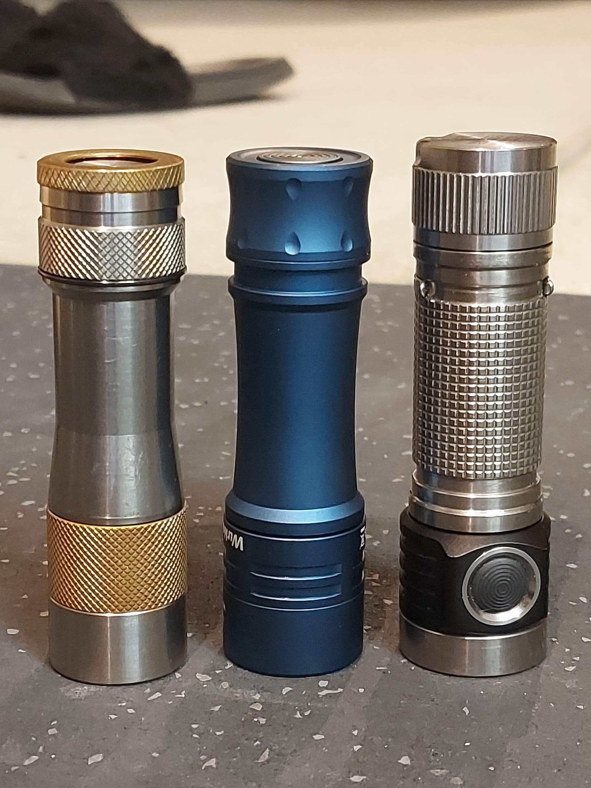

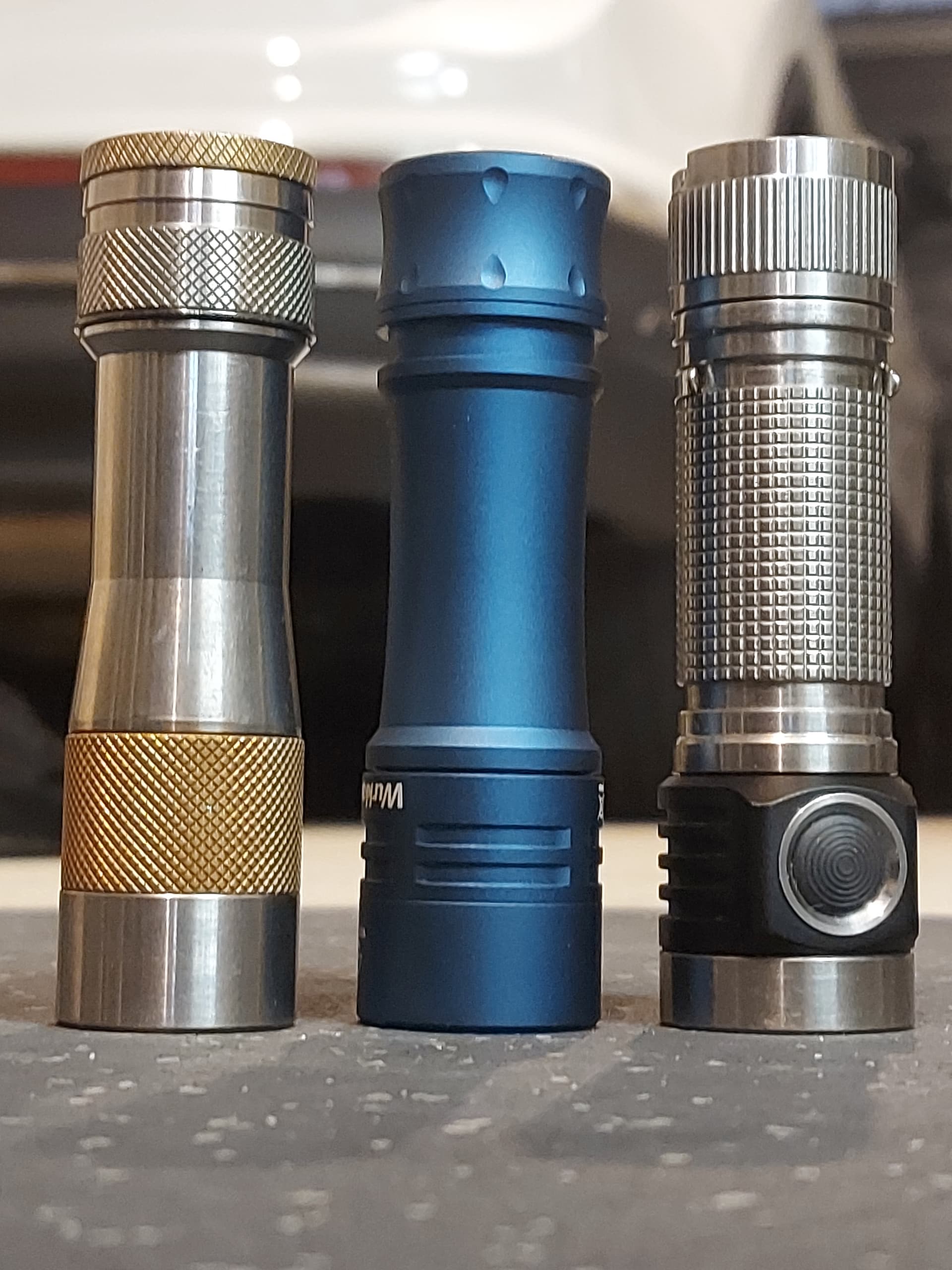

I’m a huge fan of this blue color ano . I added one of those super fat yellow rubber bands to create a cigar grip and the two colors look great together.
It seems they did something a bit different either with the surface prep or the anodizing on the max. In dimmer light as in the house it is a pretty standard almost drab matt color. But in the sunlight it has an almost metallic look to it. A bit of sparkle. I like it. I didn’t notice this until I took it out in the sun to take pictures.
Yeah, I think the blue looks great and I’m glad they didn’t just go with black for the initial release. I think the blue would pair nicely with some copper accents like a bezel and maybe something in the clip area. I can feel myself getting closer to a modding rabbit hole with this light…
