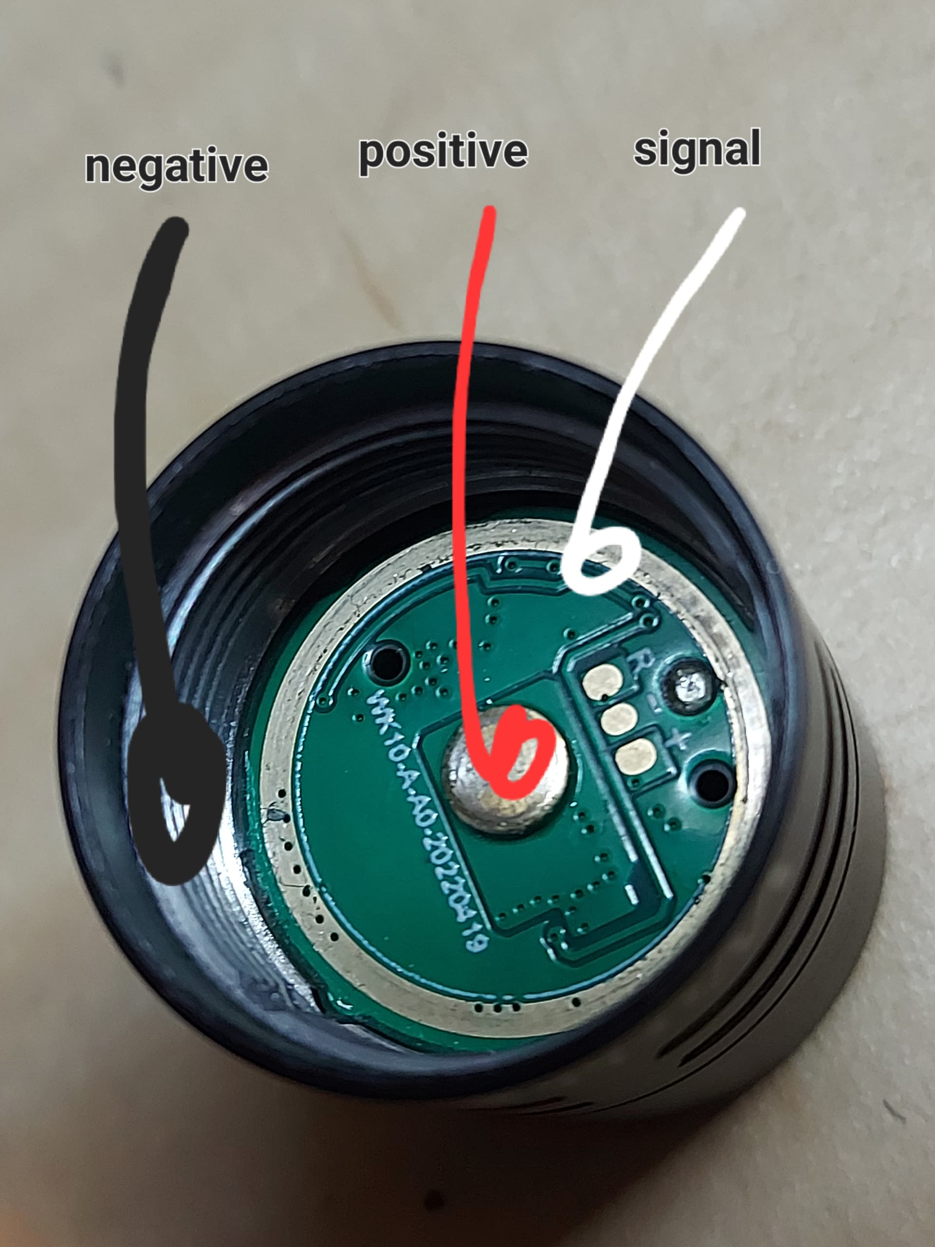

True, but i often have issues woth reliability on my kr4. I find its factory reset somehow at times, which is no bueno
The only times I’ve seen that are when I tested and tried leaving the head or tailcap looser than I normally do without even trying. Both the TS10 and KR4 have issues with the signal tube if you stop tightening them at the slightest increase in resistance, but if you twist it about as hard as is required to open a new bottle of soda, that will allow the signal tube to make contact more reliably. It doesn’t need to be torqued down like it owes you money, merely a bit more assertively than some folks are used to.
Hopefully Wurkkos will take the lessons learned from the TS10 and KR4, and make it a bit less finicky without having to resort to gluing the tailcap. And I think the issue is that the tailcaps are made a fraction of a millimeter too long in an attempt to narrow the gap where the o-ring is, or at least specced close enough that the normal variation in CNC machining can push some likes across that line into fussiness.
I think usually they make the inner tube a little longer, and don’t anodize the threads on the outer tube where it’s supposed to be closed/opened, so that both tubes reliably make contact despite tolerances. Downside of that is, that the battery makes contact before the switch does, which can lead to weird behavior. I think FWxx needed a firmware hack so they wouldn’t fac reset at every battery change.
Edit: this also leads to recommendations to only open either one or the other side - if one side has anodized threads, you shouldn’t open/losen it, as if you tighten the un-anodized one first, the other won’t make contact anymore if the inner tube is a bit longer. Confused me a lot for a while why manufacturers tell to only open one thread and not the other.
Anodizing the ends would be problematic, so I assume there is some post-anodizing work on both ends of the signal and battery tubes to ensure bare-metal contact.
I’m a bit more concerned with the tolerances involved and how they might stack if there is no spring involved to allow for more leeway. The signal tube spring in the head of the KR4 allows for more of a mismatch between the battery and signal tubes than the TS10. The TS10 manages with just the spring in the tailcap for the battery, which mildly impresses me. As a machinist who usually worked to a ±0.005" (±0.127mm) tolerance, I can see how that may potentially lead to the sort of tolerance-stacking that could cause problems even with parts that are technically within specs.
I suspect that part of the reason I avoid the issues that some have, especially with TS10’s, is that I have “optician thumbs”. Take a pair of “plastic”-framed glasses and try popping the lenses out and then back in again. Many find it hard, but I find it routine. I think that that should give you a clue as to my grip strength, along with implications about how that may skew my perspective of how much force is required to make an Anduril light with a tailswitch and signal tube reliable. Despite that though, I’m still mildly impressed that the TS10 is pretty reliable despite lacking a spring for the signal tube like the KR4; it implies a degree of craftsmanship not normally seen at that price-point. Take it from someone who has made many wing-spars for Boeing aircraft and parts for SpaceX rocket engines that have had looser tolerances and higher price tags.
The threads are irrelevant as the tube ends are the actual contact points. So long as the machinists allow a little extra space for a few microns of anodizing without seizing the threads, bare the tube ends afterwards to allow for electrical contact, and make sure everything the tubes can make contact with the rings in the head and tailcap without requiring strap wrenches to torque it all down, I’m happy.
I think you misunderstand the function of the inner tube. The inner tube carries the switch signal to the driver (e-switch). The outer tube carries the power to the driver/led.
Hi Terry, with the TS10 being a 14500 triple emitter, wouldnt the TS10 MAX be more interesting if it was a quad emitter (even CSP’s) being a 18650 flashlight? The design looks awesome too
You have it backward. Stick a battery in the body without the head. Check voltage with a DMM. The inner tube will always show voltage, the body threads only when depressing the switch.
Edit, this applies for V1, apparently not V2.
Are you measuring this on a v1? They changed it in the v2.
Oh yeah, V1. Didn’t know they changed it. Thanks.
