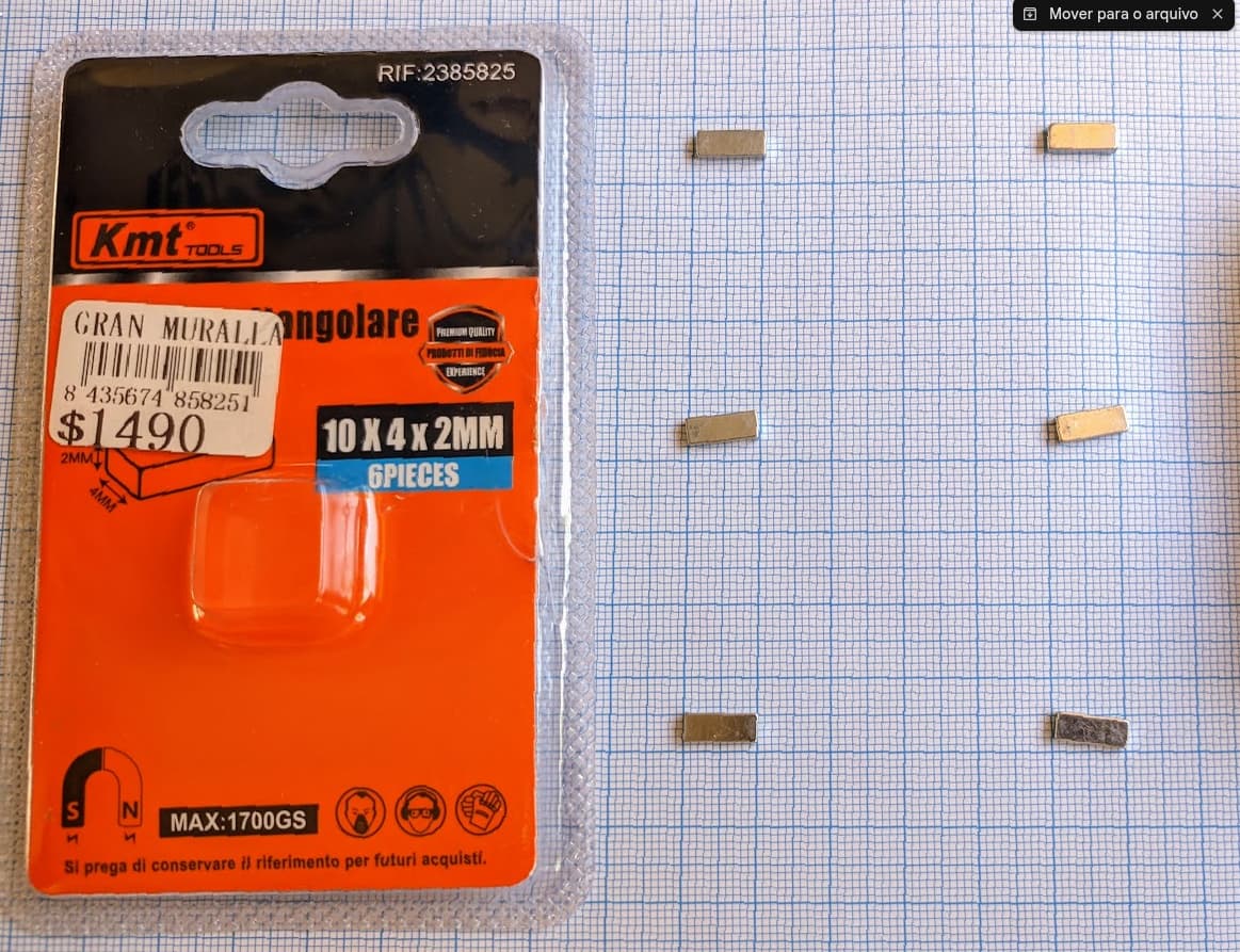

This stuck in my mind for quite some time, and the other day I finally managed to procure the ideal magnets for this: very strong, and with a rectangular format that’s even more appropriate than (IIRC) the usual circular format the other guy used:
(quite cheap, too: those 6 magnets cost less than CLP 1500 – about USD 1.50)

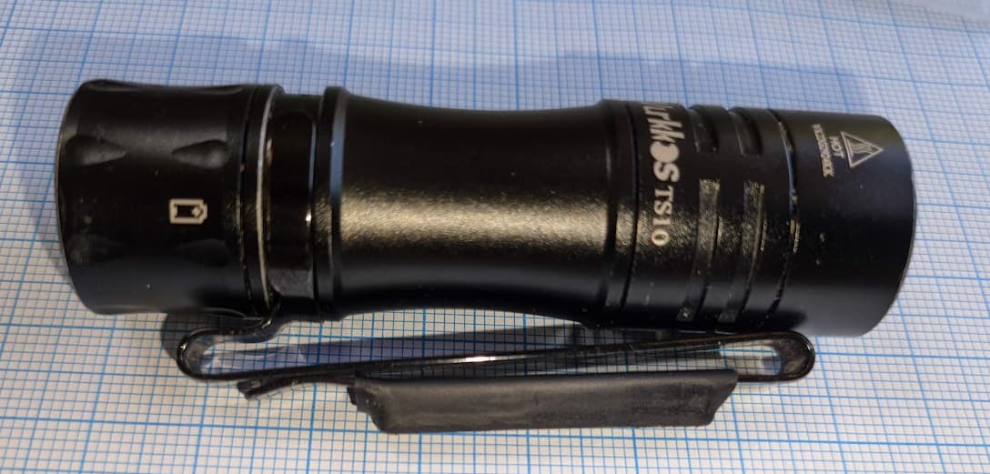

So, here’'s what I did to mod my TS10 v1 (with the Wurkkos enhanced clip):

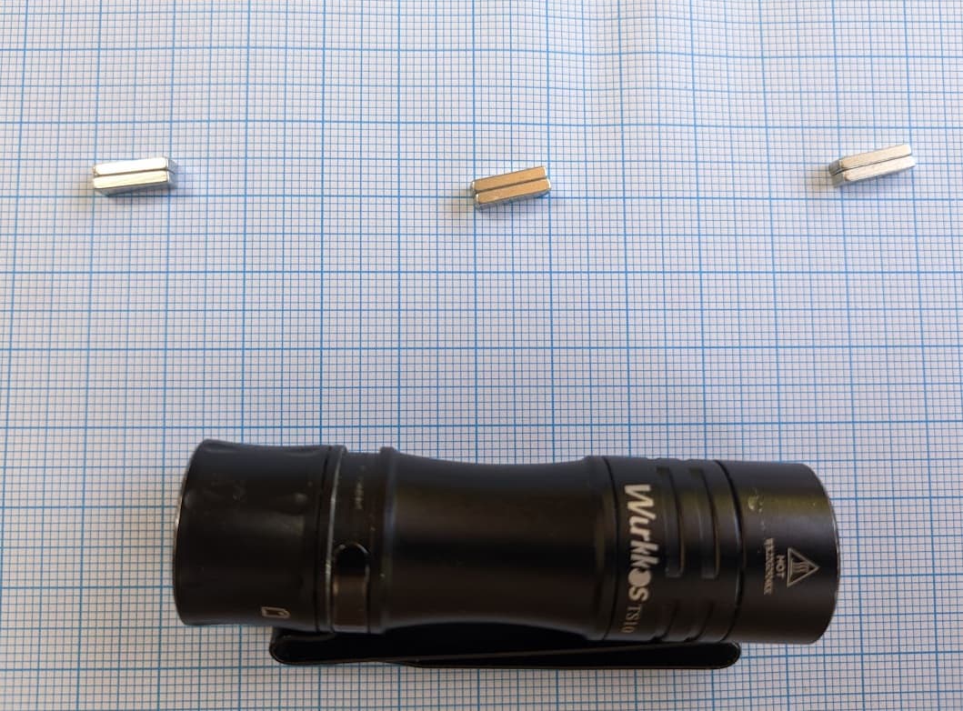

  1. grouped those magnets in pairs, respecting their magnetic poles – otherwise you’re going to have a hell of a time pairing them ;-):

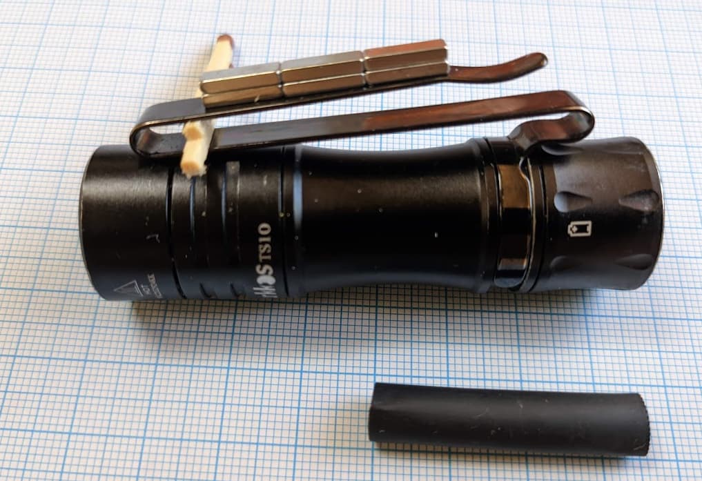

  2. Grouped the pairs in a triple, again respecting their poles, on top of the outer part of the clip:
  3. used a couple of matchsticks to separate the lower ‘jaws’ of the clip, and sized/cut a segment of heat-shrink tubing of the apropriate caliber, and long enough to cover the magnets along with the part of the clip they’re resting on:

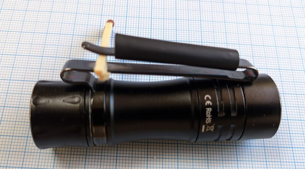

  4. Put the heat-shrink tubing in place and changed the position of the matchsticks to prepare for heating:
  5. Applied heat to the tubing (using a soldering iron – if using a heat pistol, you might want to cut out the matchstick ‘heads’ first to avoid any fires :wink:

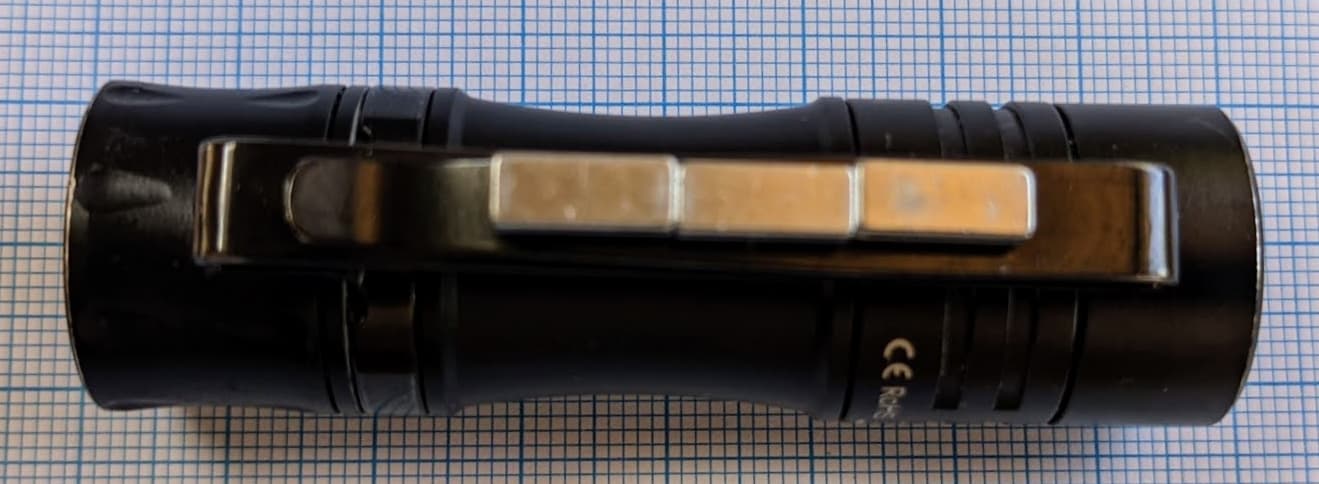

And here’s the final result:

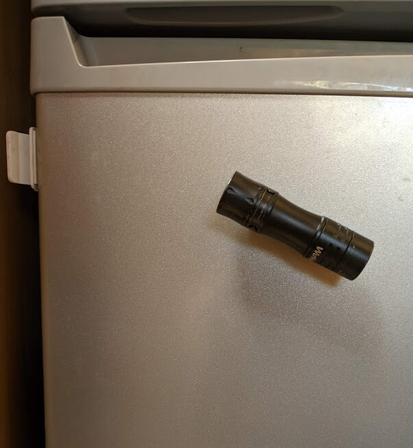

Then I stress-tested it at the refrigerator door (easily the most moving metal surface in my home :slight_smile:) and it adhered perfectly and stayed adhered:
So, mission accomplished – now one of the few shortcomings of my dear old TS10v1 has been corrected :+1:

Thanks! Been using it every day since then and it works great, better than I predicted.

Thanks for the info. I’m using opposite-poles through-out (both vertically in the 2-magnet stacks, and horizontally between stacks) and it’s adhering like there’s no tomorrow, gaps or not, to everything ferromagnetic.
Other people’s mileage may vary, of course.

Yes, I’ve been using the magnets on mine extensively. They really help whenever there’s a ferromagnetic surface you can stick it to.

This could work, but would make the light stick out 90 degrees from the orientation I get with the magnets on the clip – on a vertical surface, the clip magnets allow me to rotate the light 360 degrees while a tail magnet would not allow that. But a tail magnet could work better on an horizontal surface like a metal roof to illuminate directly down.
