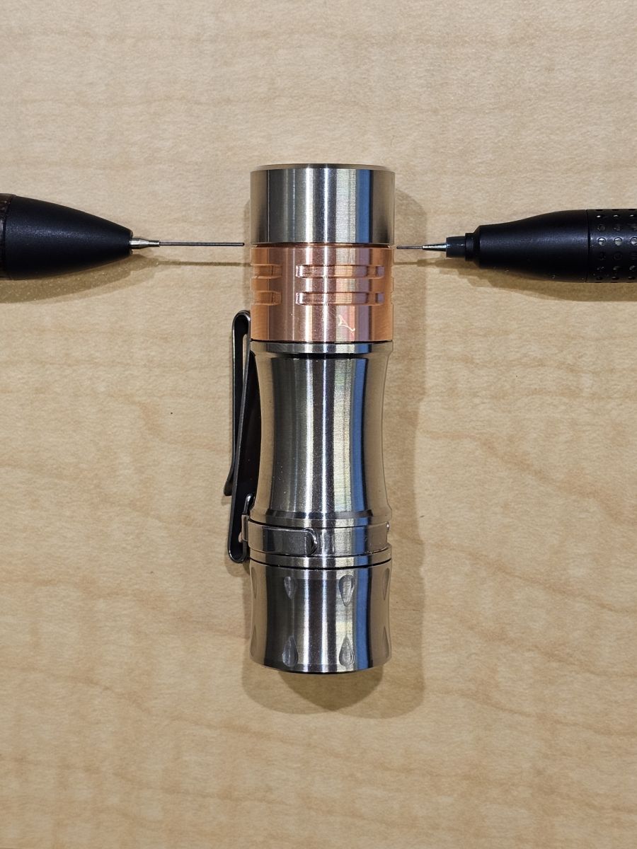

I received mine yesterday and noticed the gap too. I attempted to scale my photo to match the size of the one posted by TimMC, and I believe the size of my gap is more or less similar.
I tried to measure the gap using some mechanical pencil leads. A 0.5mm pencil lead will not fit in the gap, but a 0.3mm lead does. So, I estimate the gap to be around 0.4mm, as jon_slider suggested.

Yeah, the closest gauge that fit well was 4mm when I checked. BTW, I have the original Ti, the TiCu, and blue anodized Ti TS10s. The gap is essentially the same on all of them. Again, though I would prefer no gap, the way they are doesn’t bother me. It does not interfere with function and I doubt it impacts water resistance. But it is another area of concern for collecting dirt… :woozy_face:
It is curious that they all are basically machined the same and QC didn’t catch it early in the production run. Perhaps they just do not consider it to be a significant problem.

If all v2’s have the same size gaps, then it may have something to do with the new MCPCB? Thickness of the the MCPCB may have changed and machined parts could be left unadjusted.
I measured both my V1 and V2 mcpcb’s thickness and both measure within .03mm according to my digital calipers. I actually swapped a V1 mcpcb with E21A emitters in my Ti TS10 and there’s still a gap.
thank you for confirming the mcpcb are equal thickness
I wonder if there is variation in the Tir legs
or if there is variation in the shelf depths
thoughts?

I ordered a pair of V1 mcpcb and optics a while back. I’ll try using one of those and see if that makes a difference.
It seems strange that the shelf depth would be different from V1 to V2. I assume the CNC program would be the same except the feeds and speeds and the tooling used to turn them.
It’s probably closer to 0.4mm. I need to measure it properly.
