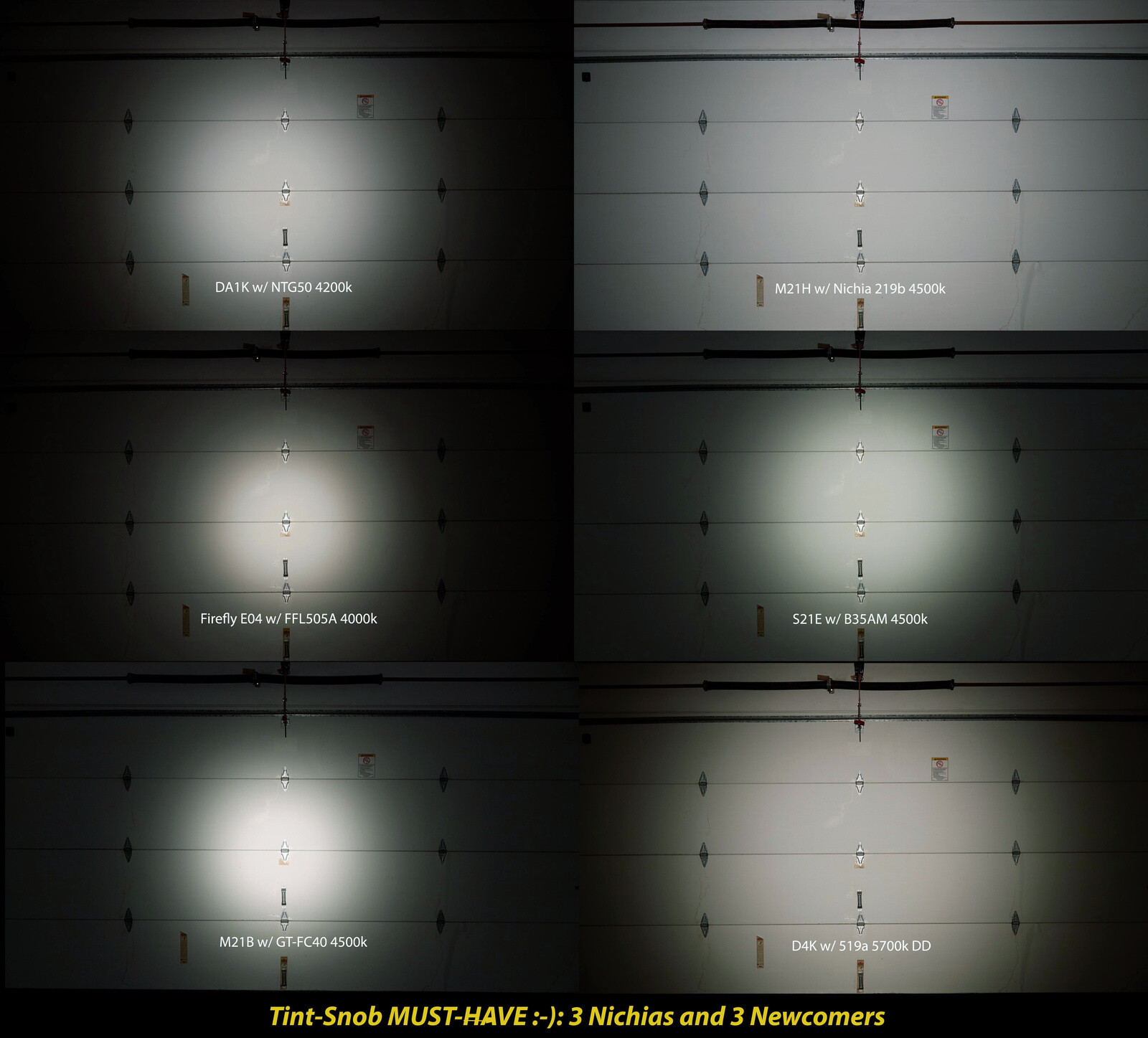

Very surprised to hear, especially since I seem to have similar opinions of LEDs as you, having read many of your posts. Probably we have differe bins, if not different CCT or optic.
The B35AM I’m referring to is the 4500k version from Convoy. It has top notch measurements (Ra 98, R9 99 from Simon) and does not have a hint of green in picture or IRL. It’s Duv of around -0.0050 is too negative to be green.
I like to use 219b sw45k for comparison because of its popularity, and I like it. But… I love B35AM 4500k (and NTG50 4200k). My best description of B35AM 4500k: less rosy but not green, more like warm tone of morning sun.

Well, yeah, all of the above. But also, different eyes.
Here’s how it looks if I white-balance it to match what I see:
I have a DA1K w/ NTG50 4200K, and a couple of D4K w/ 519A 5700K DD, and a bunch of lights with 219B 4500K. Also just one light with B35AM. This pic (at least on the two screens I checked, and by pixel peeping the raw RGB values) is pretty close to how those look to me IRL.
I find the NTG and 219B look like a pretty pure white, while the 519A DD looks a little bit golden, and B35AM looks a little bit green. Would love to have the 219B or the 519A DD in a TS10.
Edit: To clarify, this was a global white balance adjustment across the entire image, and a slight brightness boost. I didn’t modify anything on a per-beam level. The color of each beam, relative to the other beams, is the same as the original image… it just shows how they’d look with a slightly different white balance setting on the camera, or to someone with slightly different eyes.

Yep if B35AM looks that green to your eyes then we are definitley talking about two different creatures.
