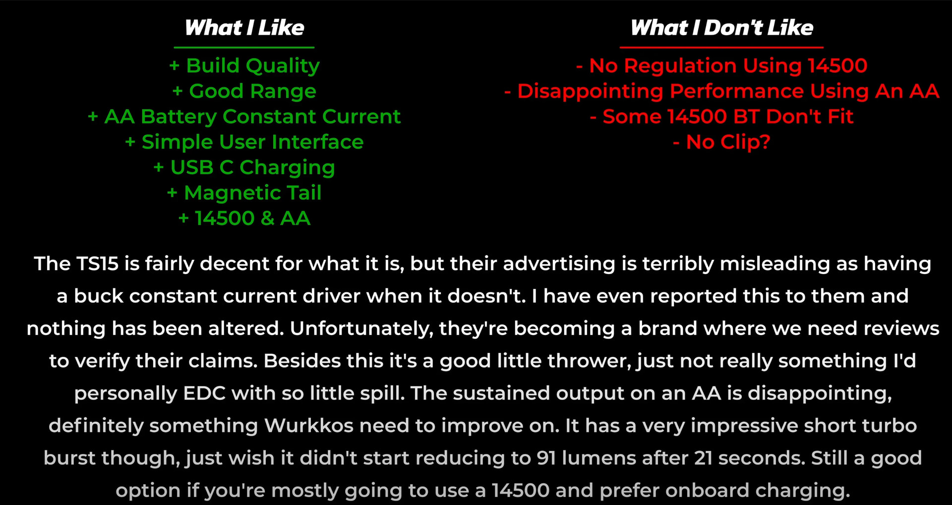

Btw, Wurkkos claims the TS15 has a buck driver, but it is not true. See this note from PiercingTheDarkness review:
It’s probably boost for AA and linear or FET for 14500 battery.

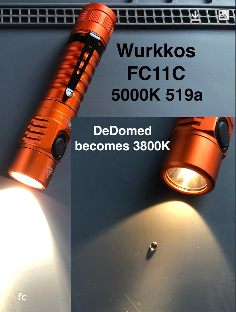

Dedomed 5000K 519a would be about 3800K:
I think the path of least resistance for Wurkkos would be to use the SC13 buck driver with 519a 5000K LED, in a TS10SG with USB 14500 battery.

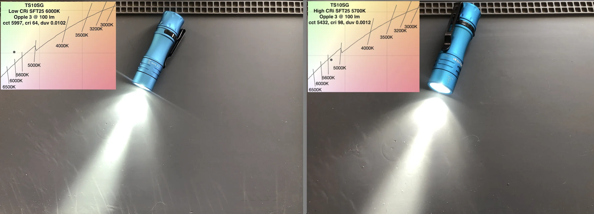

Im also a big fan of the TS10SG with a High CRI SFT25 5700K:
before and after:
The TS10SG w SFT25 is nice and Throwy..
With a Buck driver and High CRI SFT25 5700K LED, a new TS10SG would appeal to all the people that wanted the KR1AA to have more throw than the D3AA…

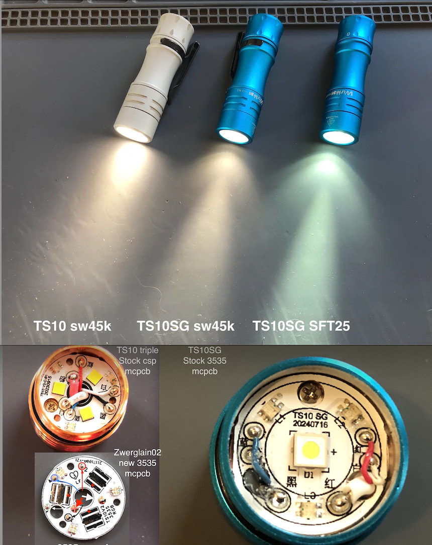

A 219b or 519a is a direct swap onto the existing TS10SG mcpcb, would that suit you?
Or do you prefer a TS10 triple? (requires a new mcpcb):
It is simpler for Wurkkos to put a 219b or 519a into a TS10SG than into a TS10 Triple. Because the TS10SG mcpcb is already compatible. The TS10 triple would need a redesigned mcpcb, similar to the one by Zwerglein02.
But a 219b or 519a in a TS10SG wont have as much throw as an SFT25.
