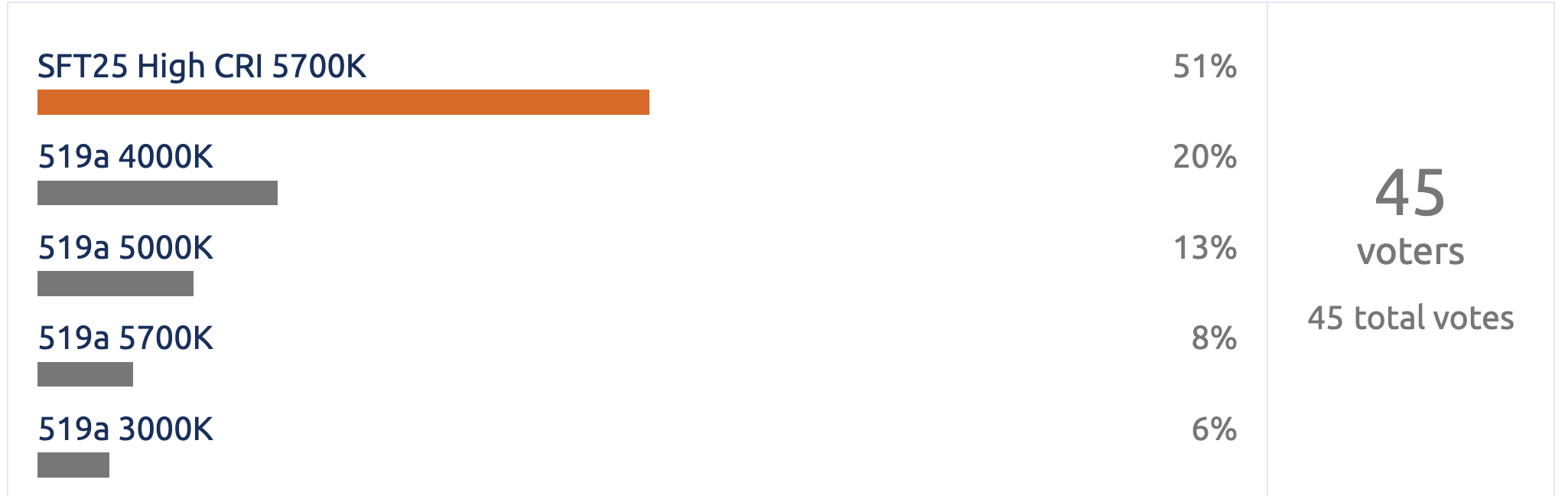

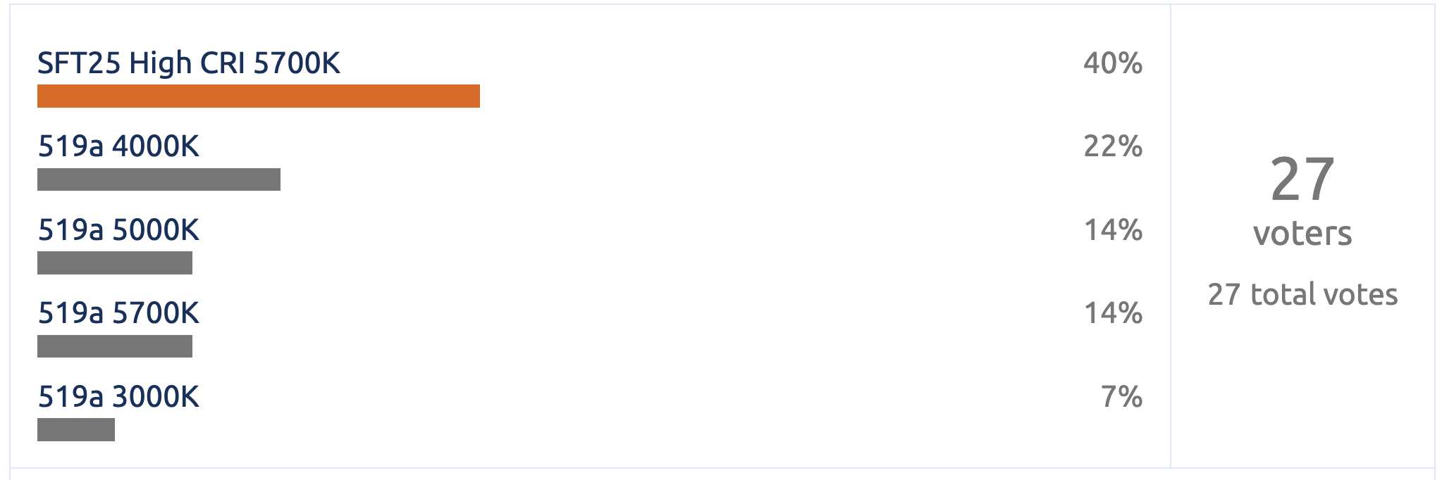

Nobody offers a light with High CRI SFT25R 5700K.. I made a poll for a TS10 with a Single LED. Here are the results so far:
Wurkkos would have the most unique product, with no competition, if they were to decide to build a TS10 with a Single High CRI SFT25R 5700K (maybe no Aux would sell, Im not sure). I highly recommend including the USB-C 14500 battery.

The poll does show there is 49% interest in a 519a TS10SG, and also 51% interest for a High CRI SFT25 5700K TS10SG. They are two different products. The poll shows interest in both.

I think the poll also shows that the SFT25 version has a certain amount of interest, about 51%. The remaining 49% of poll responders are interested in a 519a version. Although the 519a respondents dont all agree on which CCT, the 4000K has the largest interest among the 519a group.

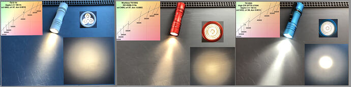

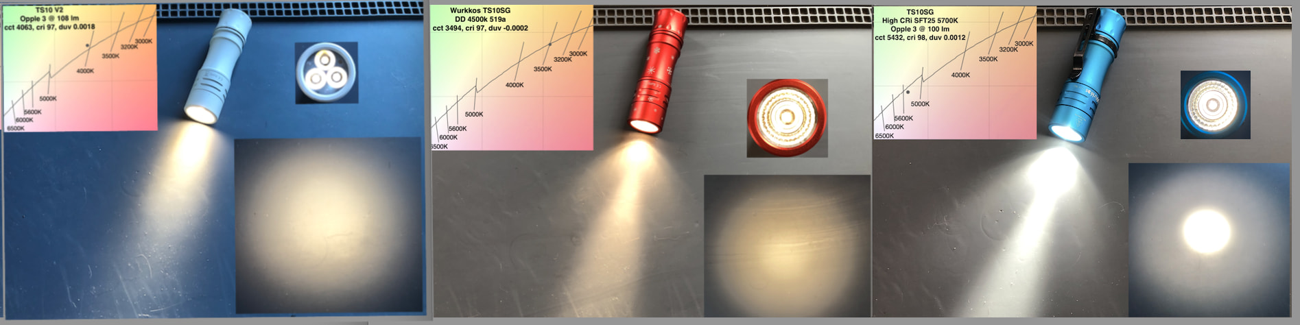

I agree the TS10 Triple is the Most Floody, on left. However the DeDomed 519a is also Very Floody in a TS10SG, middle. On right is the TS10SG with High CRI SFT25 5700K, we can see it has a Very Defined Hotspot (with Much more Throw than the other two lights).
(Notice the beam shapes in the bottom right corner of each pic.)
When using a wide LED like the DeDomed 519a, or the NTG35/Hopthink LED, the TS10SG is surprisingly floody, and good at close range.
