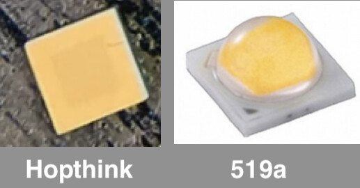

only DeDomed 519a fits the triple
the Hopthink LED has no dome, so it fits under the triple lens without modification.
agree! I am very happy with the Hopthink LEDs from Emisar (they use the inhouse branding NTG35 for the ones that use the same 3535 solder pads as 519a)

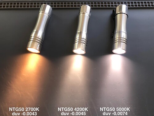

the ones in this pic are 5050 footprint but the same 2700K, 4200K, and 5000K color temperatures are available in 3535 solder pad footprint

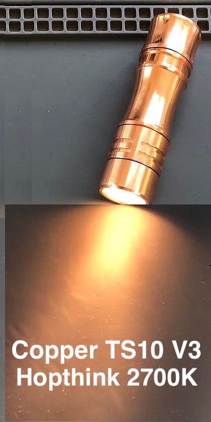

I think a limited run of Copper TS10 Triple with Hopthink 2700K LEDs with 3535 footprint, and a Buck driver will be very popular.

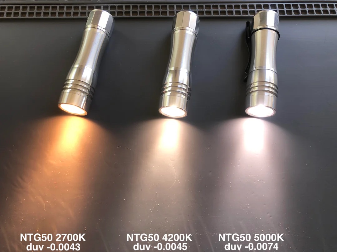

I would like Aluminum with Clear Anodizing.. like these KR1AA:
