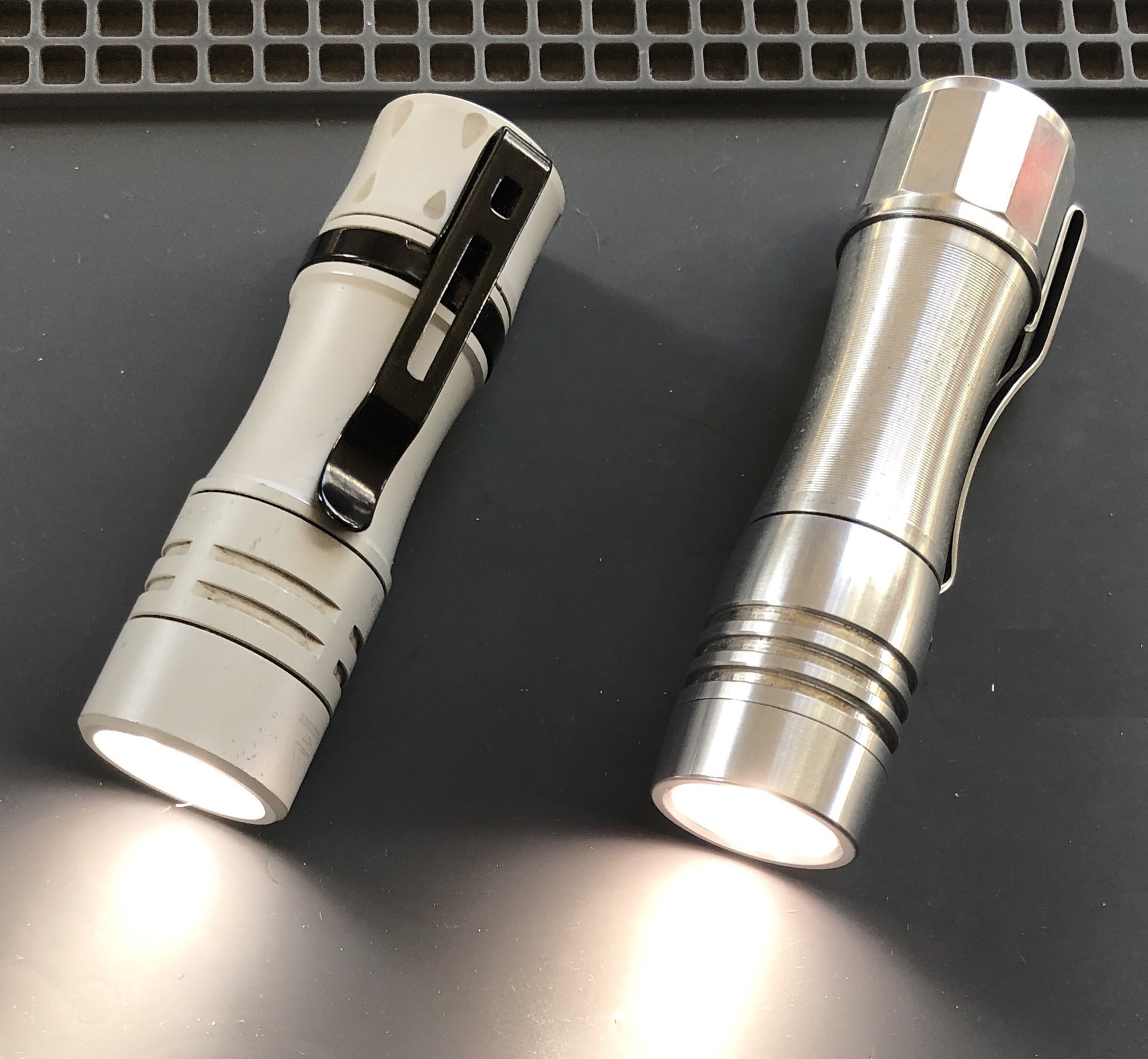

one suggestion, consider Clear Anodizing instead of the Silver Anodizing.. here is an example on my KR1AA on right:

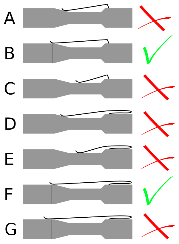

The clip needs some changes.
I’ll try to illustrate…

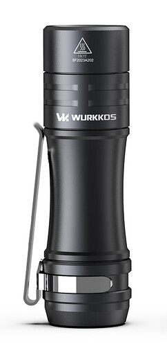

Style F is ideal, but style B is good too. The Wurkkos HD10 clip is very close to ideal for this light, but it looks like the TS10v3 design changes will make the clip land at the wrong place. Here are the issues with each style:
  • A + D: The clip lands on the slope, so it is hard to clip on to things.
  • C + E: The clip is too short.
  • G: The clip goes past the seam between body tube and head, so it scrapes when twisting the head to change the battery.
Ideally, the clip should be just land on the body tube, right before the seam to the head.
Also, 2-way clips are bad at 2 things instead of being good at 1 thing. I really don’t like 2-way clips.
Here’s my favorite design, with the clip adjusted to fit better:
23 Thanks
I agree. F would be the way.

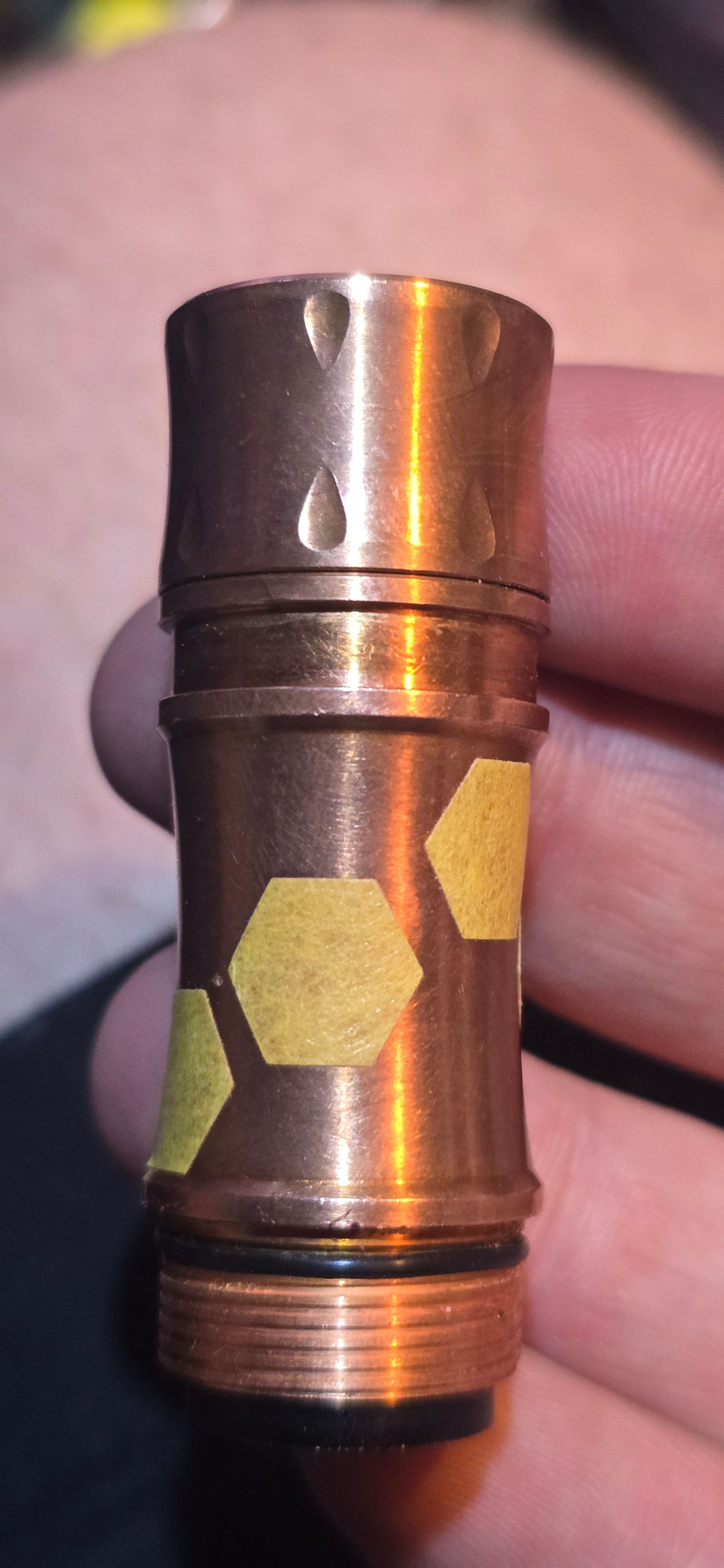

I love it! It has me cackling like a mad scientist because i read this while in the muddle of masking my copper for etching.

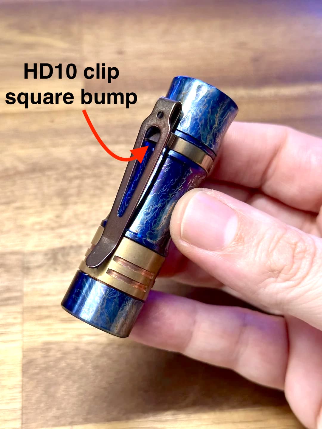

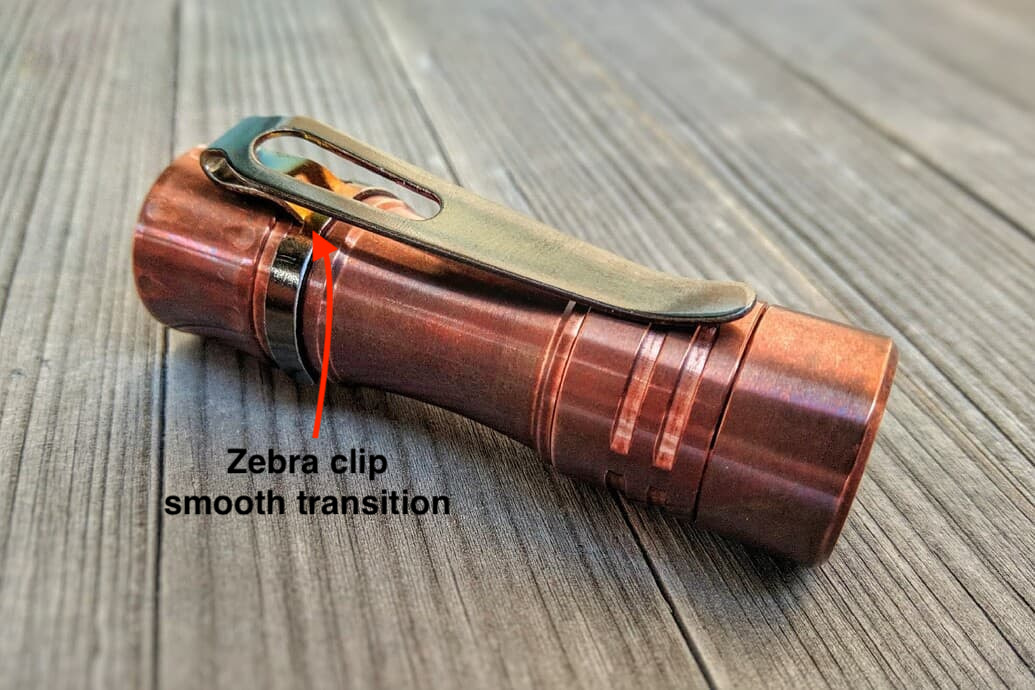

the Wurkkos HD10 clip is very similar but does not have a smooth transition:
