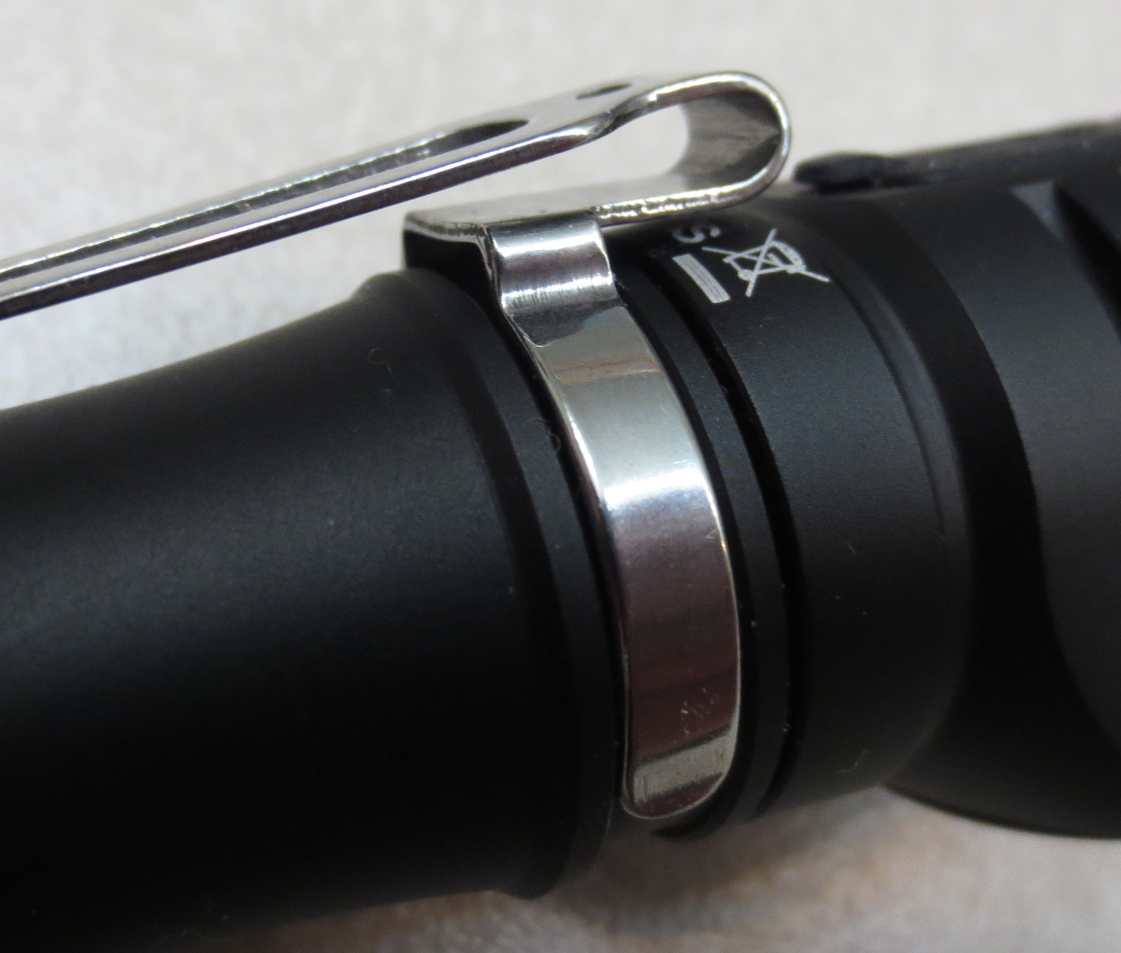

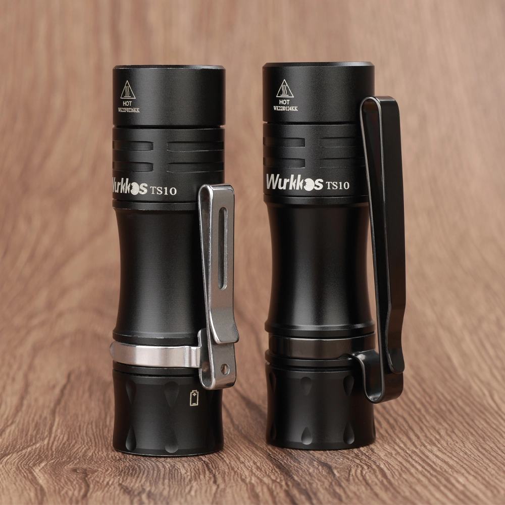

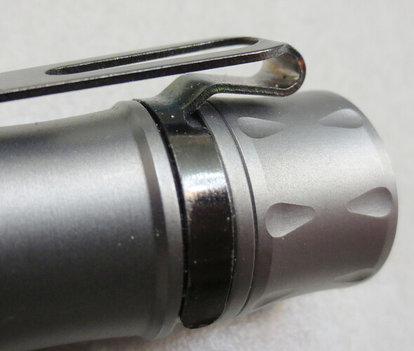

The difference may be a bit clearer in these pictures:
The HD10 clip had its “arms” bent up at the center to raise the connection above the groove. This square shape of the “shoulders” could catch on fabrics while clipping it onto things.
The TS10 v3 proposed clip has a"tongue" to reduce that problem, but it would be even better if it was shaped like the ZebraLight clip. (“tongue” may be a weird word for it… not sure what to call it)
The ZL clip has nothing to catch on.
Maybe a ramp? Anyway, I see what you mean.
great photo, thanks, clearly shows the raised square that would force me to fiddle to get the clip over a pocket seam.. some enterprising person would probably be able to design a small 3d printed ramp that would press fit into that square notch.
what I do think may be good about the HD10 clip, is the existing length of the blade..
Im guessing the tip of the blade will be long enough to still reach over the collar at the head end, from the new clip position on the TS10 V3 tailcap design..
This is the old silver TS10 clip. On the Wurkkos website is an new BLACK TS10 clip without tongue.
The clips TS10 black vs silver have different shapes
Black TS10 is the top far right clip
Nice. Looks like Wurkkos already has clips with the smooth “don’t catch on fabric” design. (on the right)
It’s way too long, but it has a good shape where the arms meet.
