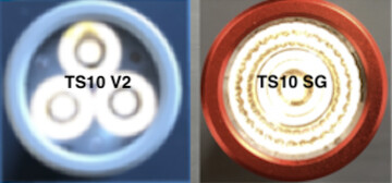

Can you please confirm if you mean the TS10 V3, will use the TS10 SG Single LED design, with One Domed 519a?
like the red TS10 SG on right?:

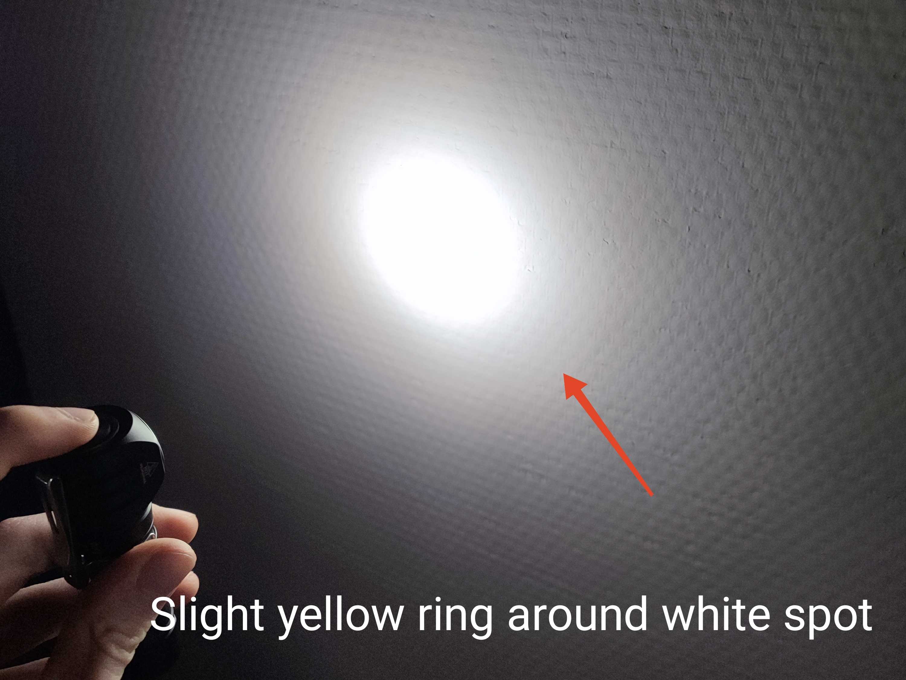

The 219GF could be used to fit under the original triple optic of the TS10, as it has no dome, the beam would probably be very similiar to old CSP2323 emitters but without the shift in tint from the sides of the CSP emitter or the dome of the emitter.
Most noticable in the cool tint of the CSP2323 emitter, not as much in 4000K version. It is much more noticable in person than in this picture.
At cost of slightly lower CRI though

Yes, we will test whether it is necessary to redesign the TRI lens to make its size better
the single LED TIR from the TS10 SG does not need to be redesigned to work with one 519a, the single LED TIR is compatible as is
but if you want to redesign the TIR to be completely smooth, not with dots and not with fresnel rings.. that could give the cleanest beam
the TS10 SG single LED MCPCB also works with 519a, without redesign..

I agree with the choice to use a smooth TIR than the pebbled one. I sanded down my TS10 SG lens and it looks dramatically better. If it were frosted that could improve and smoothen the beam too.
It is quite throwy though. I’d say slightly further than the default pebbled. So the angle of it would need to be changed.
Although I’d rather see the classic triple. And leave the fresnel for maybe SG V2. A flat lens would probably throw quite a bit with something like XPG-R.
