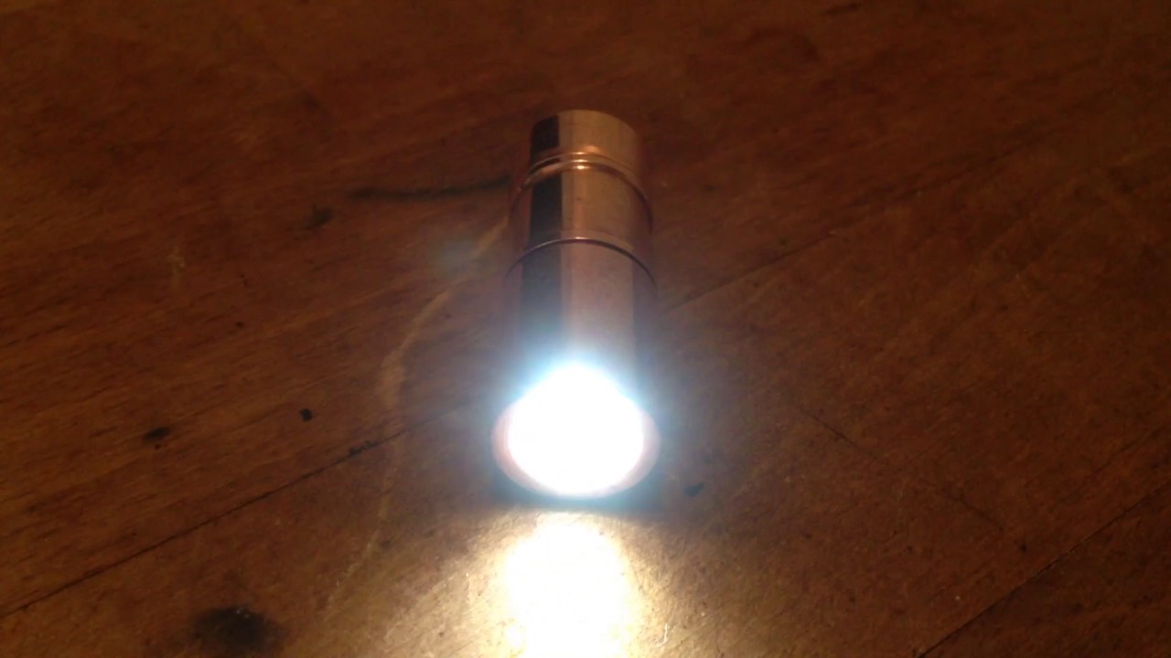

here are couple of pix anyway
like other Astrolux copper lights, these come coated with lacquer, so they stay shiny. I used acetone to wipe off the lacquer. looks like I missed a few spots
