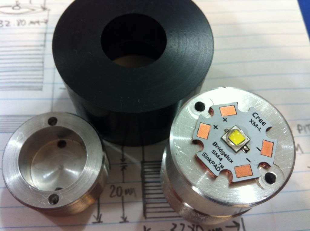

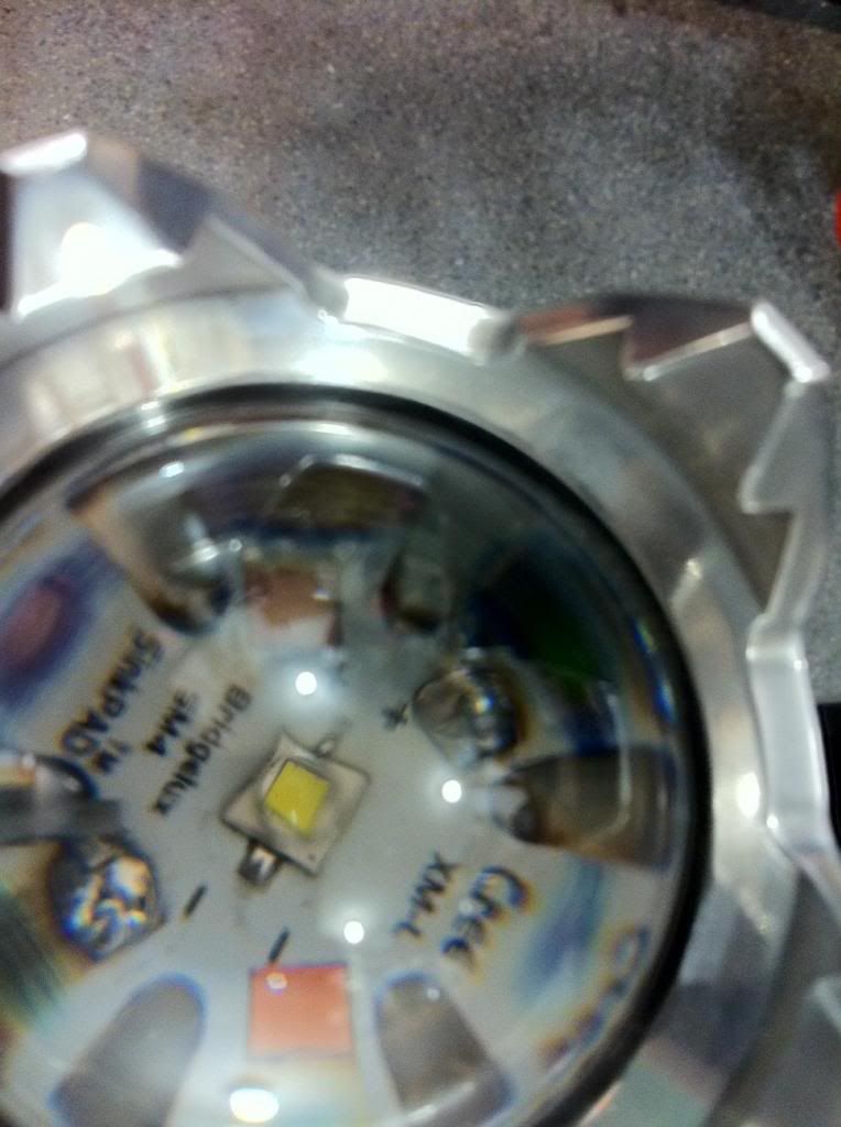

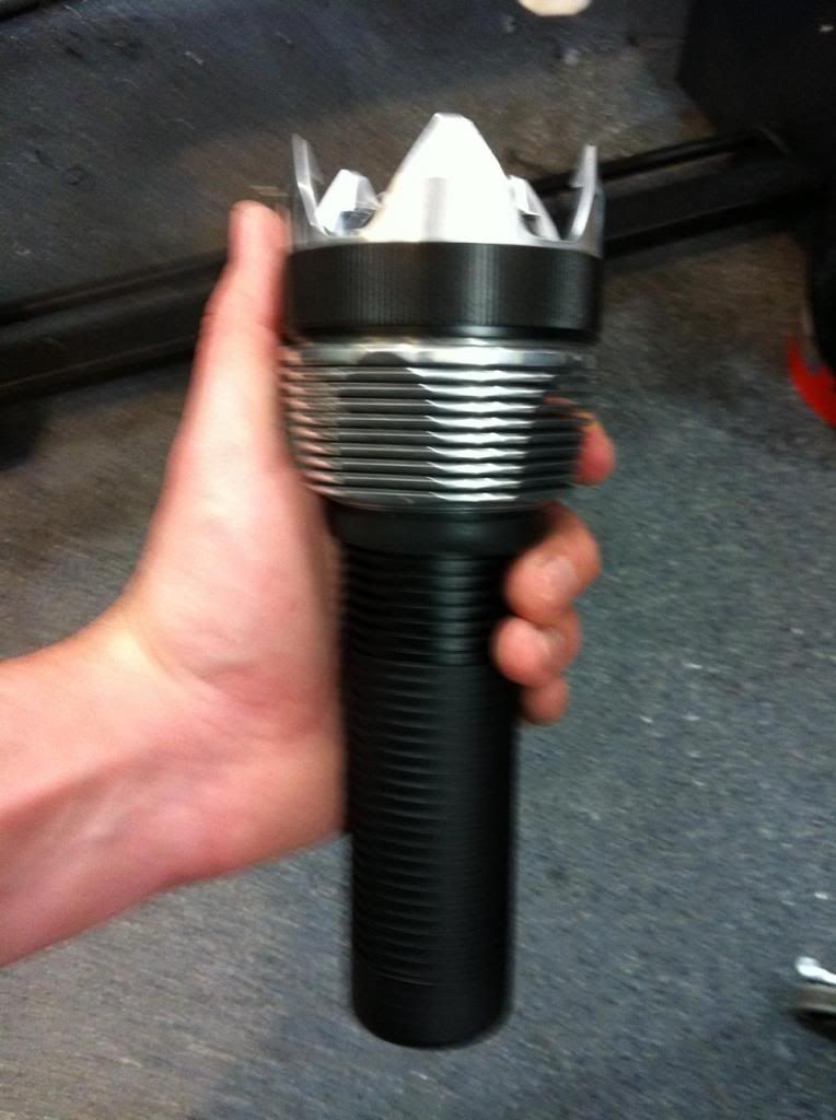

First, my septuple XM-L module with wires soldered to the contact board and to the star board itself. All that was left to do was apply some AA and solder the contact board to the heatsink. That was quickly finished and I installed it in a L2 host along with an AW IMR battery.
An amazing soldering job by ChiX.
So what light did it beat you ask? My TR-J18! In my integrating bathroom, the TR-J18 clocked a measly 278 lux (DRY got 259); this monster however managed 421 lux... I tried to measure the current but it maxed out my DMM, so current draw is more than 11 amps (where my DMM usually trips). My personal guesstimate is around 17 amps. As for beamshots, I plan on getting all of these lights out this weekend (along with my Vinz triple XM-L) for some beamshots.

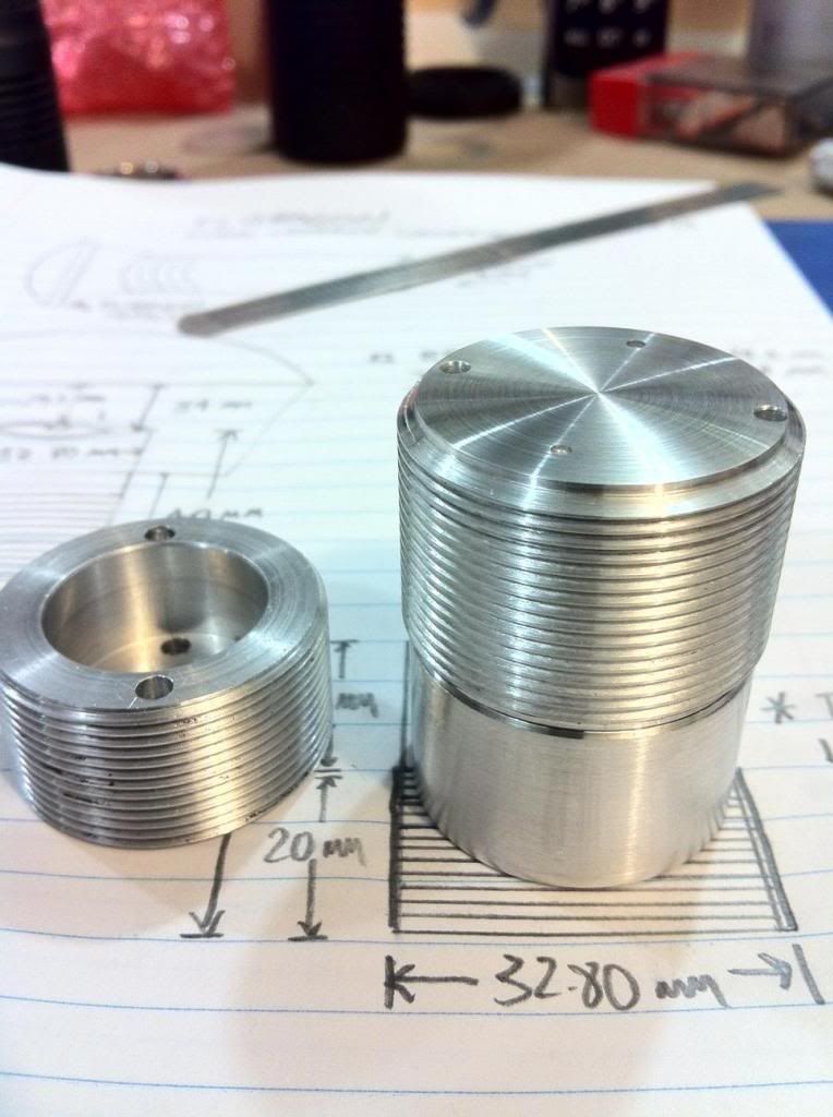

On to the other thing in the package. Some of you may remember that I recently got a Flydragon aspheric, this thing has a 3 inch diameter aspherical lens in it. It currently runs off of a 3P pack of NCR18650B direct driving an XM-L2 U2 mounted on a sinkpad attacked to a very large aluminum heatsink. It beat my X6 in throw, for reference here a beamshot of my X6 is at 350 yards.
This thing is a good bit brighter than my X6, I would say approximately 230kcd if I had to guess. Again, I have not measured this yet and I will try to do it at some point. Here some build pictures are to hold you off.
Original heatsink on the left, new one on the right.

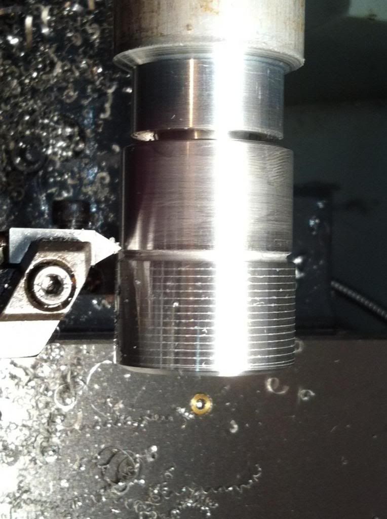

ChicagoX is an amazing machinist and all of his work on these things is impeccable. I am truly amazed and I recommend him 100%. PilotPTK desgined these boards which allowed me to actually make this as I have no idea how to do that, and MRsDNF machined the 7 XM-L copper heatsink for me. Thanks to everyone who helped with this!!! Beamshots will be in the next post once they are taken.

Haha… scaru, you crack me up. I can’t believe that circuit board didn’t burst into flames :slight_smile: I really wasn’t sure the traces would hold up - I had no room for them since the entire PCB is covered in XM-L pads :slight_smile:

I'm glad you like the results, scaru - that PilotPTK 7-up board is a work of art !
