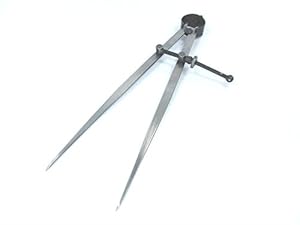

I have an old “chart divider” or caliper that I use (had to look up the name).
Picked up at a Sunday market for a few coins.
