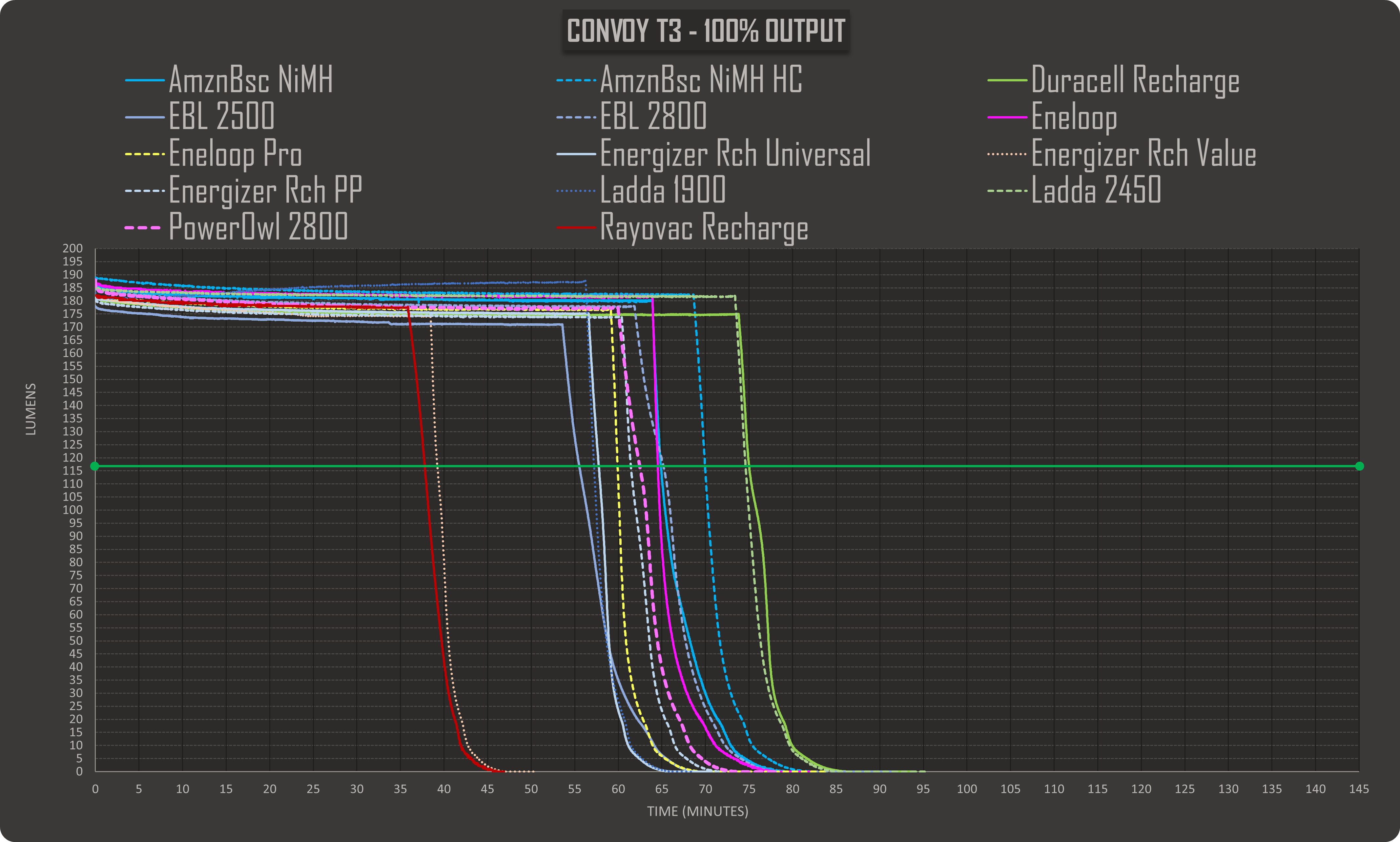

NiMH
Most NiMH batteries had very similar measaured capacities between the high and low current tests, which was quite impressive.
In both the CBA and the Convoy tests, NiMH batteries were able to hold their voltage very steady trhoughout the run, allowing them to produce consistent performance through their lifespan - very nice!

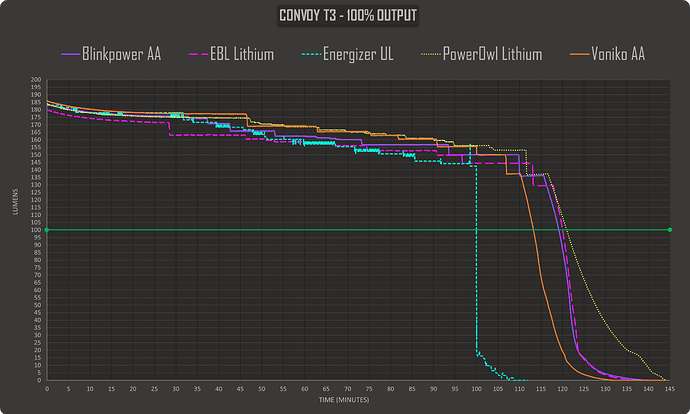

LiFeS2
These cells had significantly longer runtimes across the board, though they lost some capacity in the higher current draw tests relative to the 250mA test. We also see declining voltage throughout the test.
Runtimes in the Convoy light much longer than any other type, and output was not flat but still held fairly steady throughout the run.

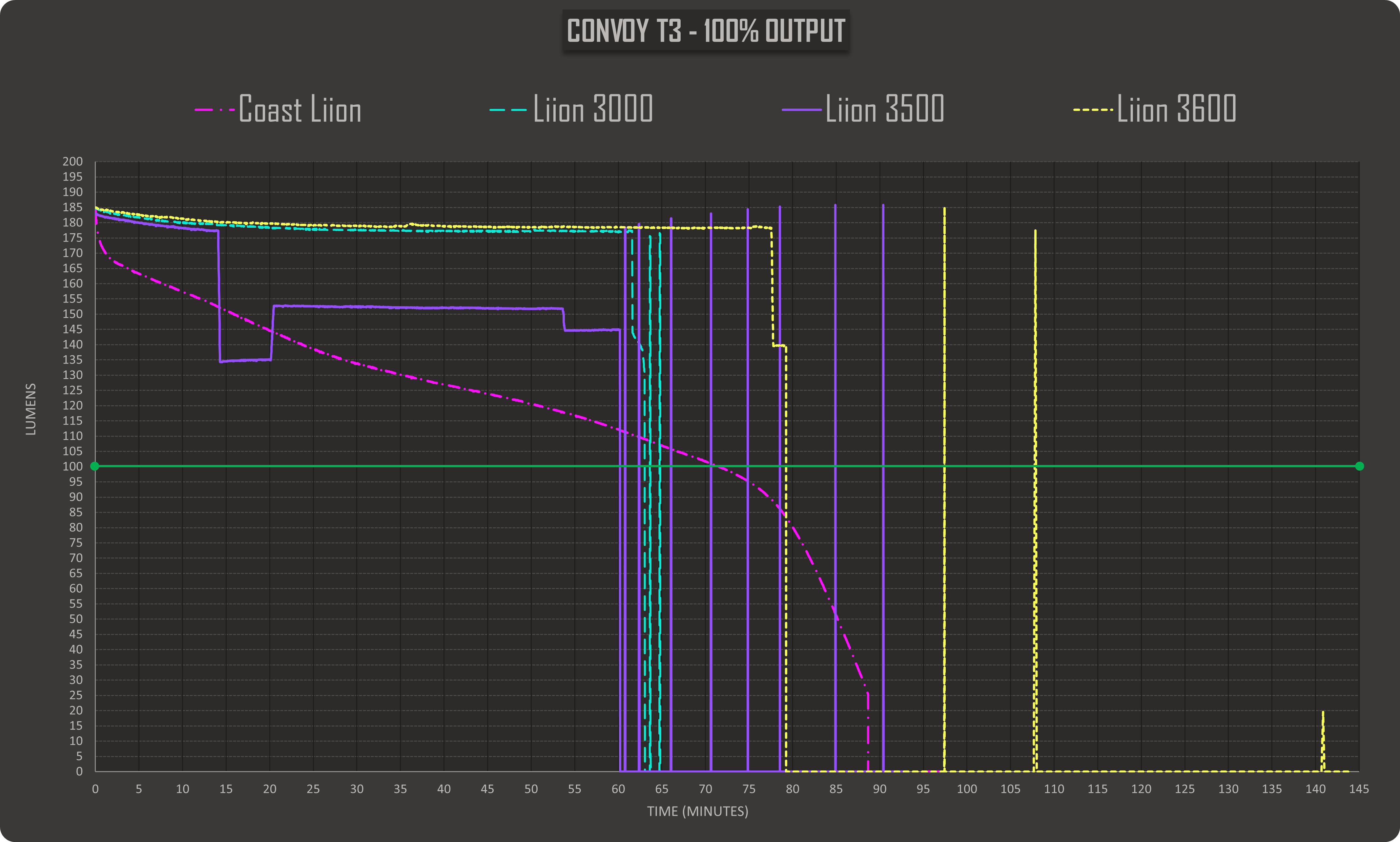

Lithium-Ion
Here we see much more variation between the different batteries tested. Capacity between the two CBA tests was pretty close, though most lost a bit in the 2A test.
2 of the batteries (Zepath 3600 and EBL 3000) held their voltage perfectly flat until dying, while the EBL 3500 and Coast Zithion batteries did not.
In the Convoy test, we see the same results. Overall runtimes are very good, on the longer end of the scale. (Note the sudden jumps back up to full output displayed after dying for a couple of these. An artefact of the buck conversion and voltage recovery)
