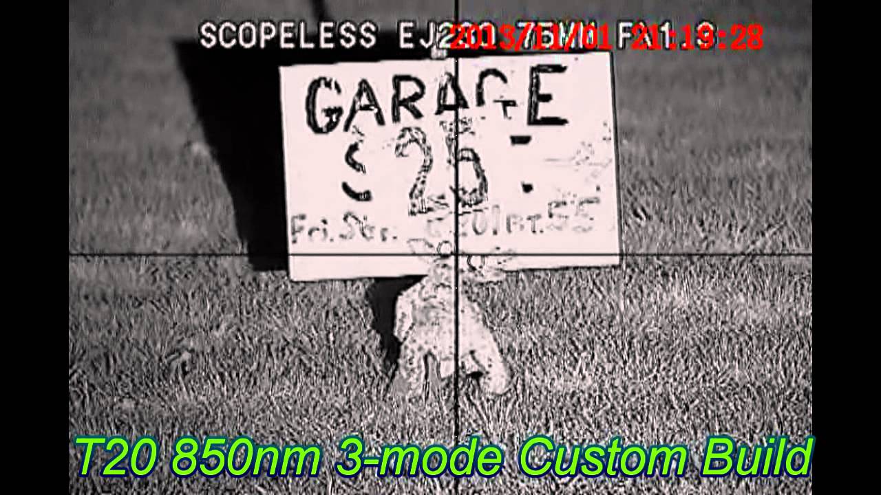

You are absolutely right. 850 is better for night vision cameras:
LOL……If you noticed the pic I posted of my NV it is from Roland’s youtube the 1.0 I believe. Yes 850nm is better for cameras and will light objects up at much longer ranges but also will spook some animals. 940nm is a much better wave length to use for hunting but you lose distance. I am just learning this stuff and it is a hand full to swallow. I am using NV on an airgun and my limit is 100yrds on small game and 50yrds is pushing it for a yote so the 940nm is perfect for me.
