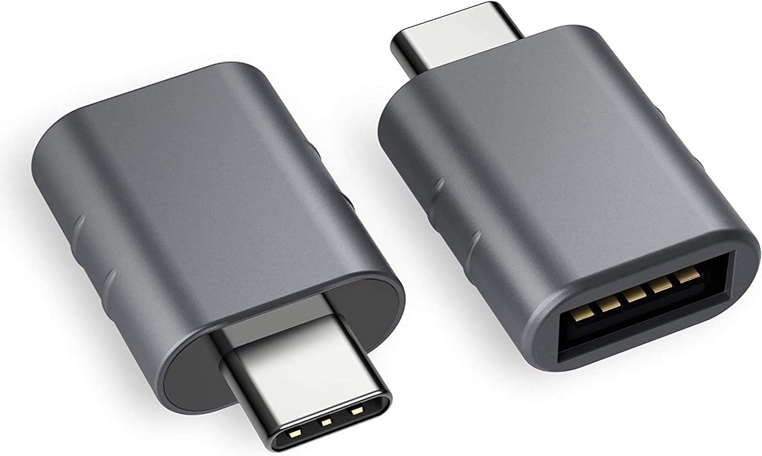

Also, powerbank function does NOT work with my Pixel 4 when using a C to C cable, but it DOES work when using a C to A cable with an A-to-C adapter.
Hold the phone! So…you use a regular C-A cable (that you might use to charge your phone from a charger), and you…add this thing to adapt USB-A end to USB-C so it fits the USB-C port on the HD20?
https://www.amazon.com/Syntech-Adapter-Thunderbolt-Compatible-MacBook/dp/B07CVX3516
Correct, this worked for me. Specifically, I used the A to C adapter that came with my Pixel 4. Obviously, I can’t guarantee it will work for you.
My Pixel 3a charges with the same kind of adaptor (so C-A-C but not C-C) but at well under 1A. Anyone got it to fast charge a phone?
It will output max 1.6 A, but if the phone detects an old-style adapter (like which is emulated with the C-A-C adapter) it might limit charging to less than 1 A.
