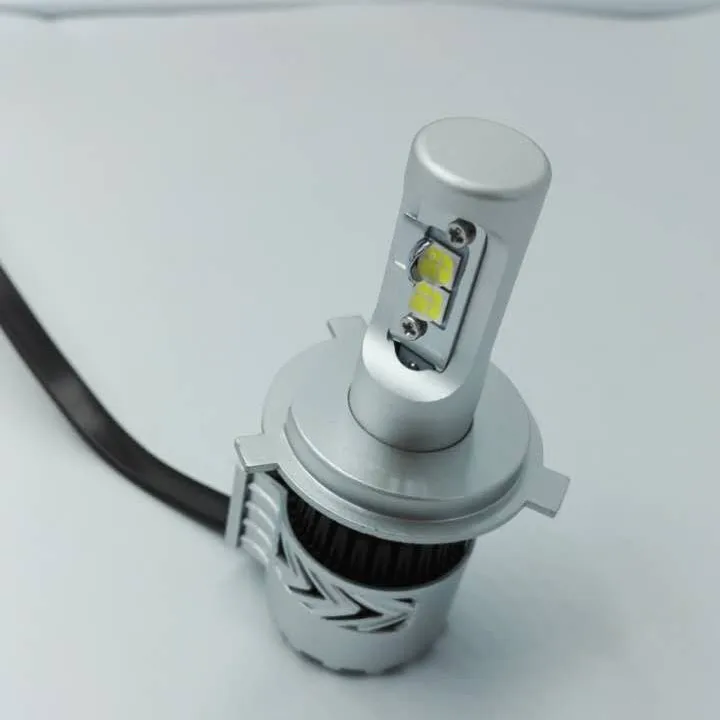

Thought I’d give these LED car headlights a try. Bit of a minefield buying them, all the usual Chinese lies and bad descriptions, but eventually found some on Amazon. These were listed as Cree MK-R, but the pictures obviously showed XM-L2’s.
So I decided to take a punt. They are about double the cost of high output halogen options.
I opted for these specifically because I wanted a good beam profile and cutoff. And the COB variants and such just didn’t inspire confidence that they would be an good.
I fitted them to my 1999 Subaru Impreza Turbo. They use a clear lens and a shaped reflector with a scatter guard.
Installation is pretty easy, although the fan unit makes the bulbs bigger behind the light unit and makes fitting the retaining clip a little harder. I also had to leave off the rubber dust covers from the back of the headlight, although I could adapt them to make them fit.
Here is a first comparison. The LED is rated at 6000k, which is a little cool for my tastes. The halogen is an Osram Nightbreaker.

First hurdle, the LED bulbs seem to have slightly larger flanges and don’t sit in the recesses fully.
Quick bit of trimming with a pocket knife and they fitted a treat.
Almost impossible to tell they are in there with the lamp off.
No other fitment issues noticed.
I did take some pics of the units working outside of the housings. Dip/low beam uses the two leds under the little sheilds.
While main/high beam uses all 4 LEDs. The big advantage here is, you don’t loose the low beam profile like you do with a halogen H4, which doesn’t illuminate both elements at once.

Thank you very much for this review. I ordered a set. There is a very similar 80w version that have a one 4 die emitter on each side of the tower, but I chose this one you reviewed because I want lower power consumption and want to swap one led per side with warm while XM-L2's.

Looking at your pics, it appears this is the model they sent you (looking at the box), but I see no low beam shielding in the pictures in this ad:
http://www.ebay.com/itm/272160525664?_trksid=p2057872.m2749.l2649&ssPageName=STRK%3AMEBIDX%3AIT
