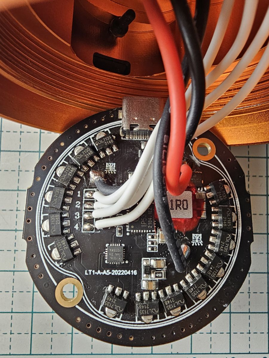

The PCB is marked as LT1-A-A5-20220416.

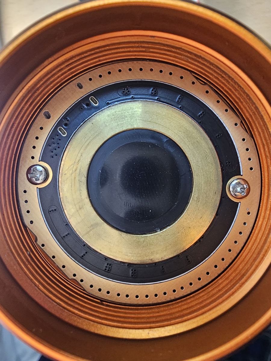

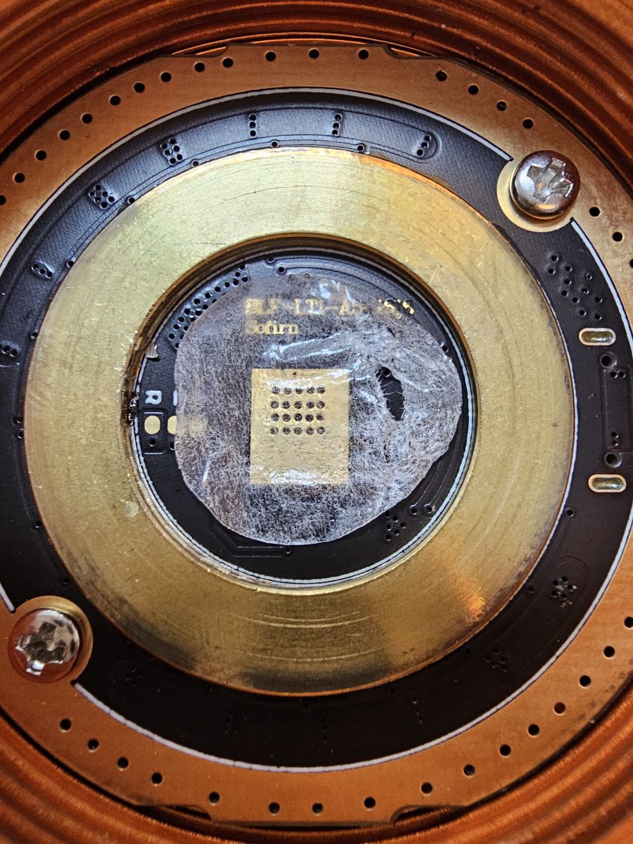

A black plastic part is inserted in the center.
I heated the plastic and successfully removed it by prying it out. It was held with a double-sided tape.

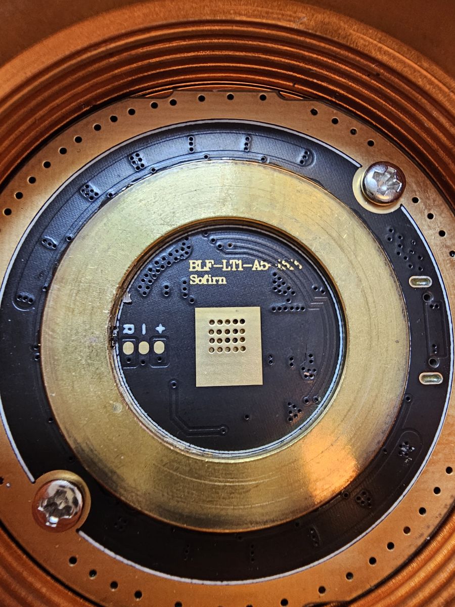

There is the standard 3-pin flashing pad.
