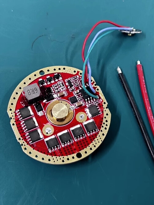

The driver was the biggest hurdle after this, but after hours and hours of scouring Taobao for flashlight and led junk, I eventually managed to find;
  • a 50mm MCPCB with an “NBT160” SBT-clone.
  • 47mm sized “violent flying andrew”(Anduril? Thanks google translate :D) 3V driver, to be paired with an SBT90, originally apparently made for the Dongdonghai DDH8 host (seller pic);

I also wonder if there’d be any easy way limit the max current of the driver (thinner wire swap?)? The listing description mentions to “use double wires if you want more than 35A” of power, but personally I’d rather set the top level to something more slightly sensible like ~20A max. I suppose you could set a new max ceiling level in the ramp, if the light really has anduril, or?
The carrier PCBs I got already from JLPCB, but some some of the china stuff I’m still waiting to arrive, so this will be sitting for some more time. I’ll try to post an update if/when I eventually manage to finish the conversion project :slight_smile: .
