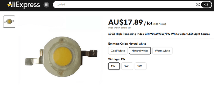

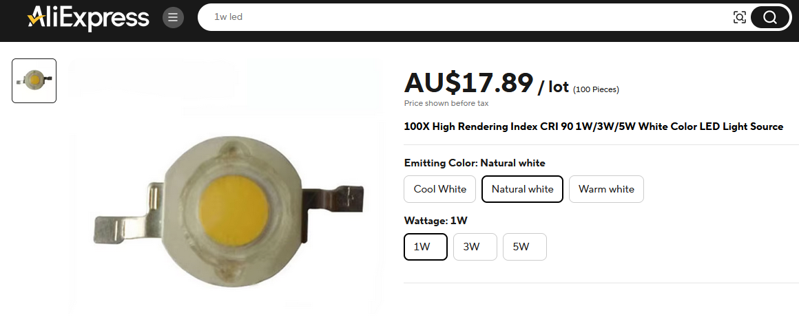

After taking the photo I noticed “3 x 1W” on the MCPCB- so that at least confirmed they’re 1W. Then I hit Google images “1W LED”, which led to AliExpress. After going through many listings, I found this- it requires buying 100pcs, but they’re 90CRI.
100 x High Rendering Index CRI 90 1 W/3 W/5 W weiße LED-Lichtquelle - AliExpress 39?
The price is pretty good considering that’s the price you’ll pay for one decent GU10 bulb here. I’ve probably got 10 odd of the bulbs still working that can be modded.
