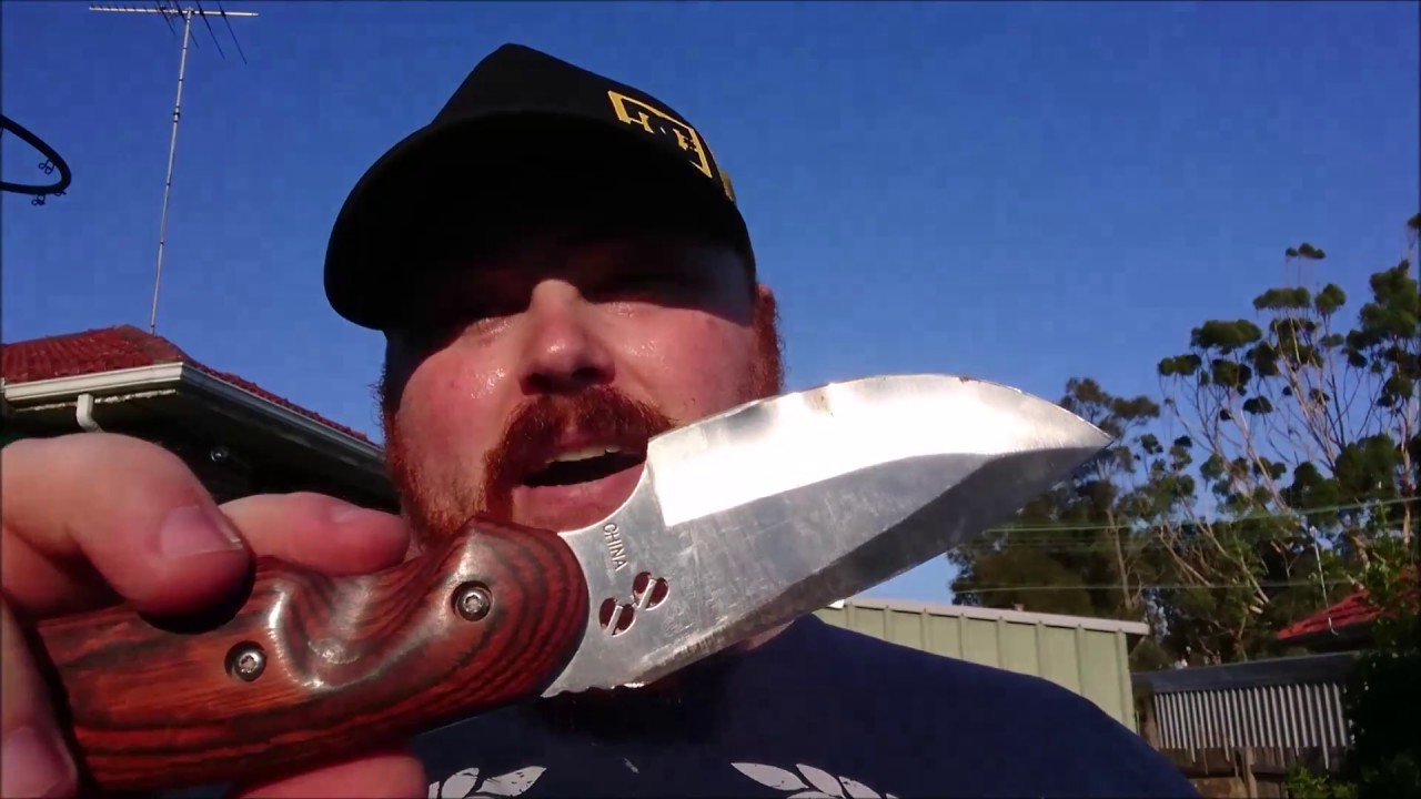

Now i know sharpening is number 1. I redone my knife bevel free hand yesterday after my last test in my clone buck testing series. I bent the blade after trying to baton wood. I went over it with the grinder then by hand with a sharpening kit taking away the buckled parts. I will make the blade even again and clean by sanding it down soon.
You can see the video here i show the blade at the end. I had photo of how bad the blade was but they are gone from my phone.
No more bend after i goofed it lol

You have to be extra careful using a bench grinder to sharpen a knife. The heat builds up quickly and will ruin the temper before you realize whats going on. Also if you use it to grind copper you can clog up your wheel.

By the way, one of the must useful accessories I’ve found when grinding something like a knife, is a drywall mud pan. Keep it close to your grinder with water in it, and dunk the blade very often to keep it cool. The mud pans work great for this because you can dunk the whole knife in to keep it cool. They come on stainless steel which would be nice, but are sometimes a bit expensive; I’ve always just used the cheaper plastic ones and they last for years.
